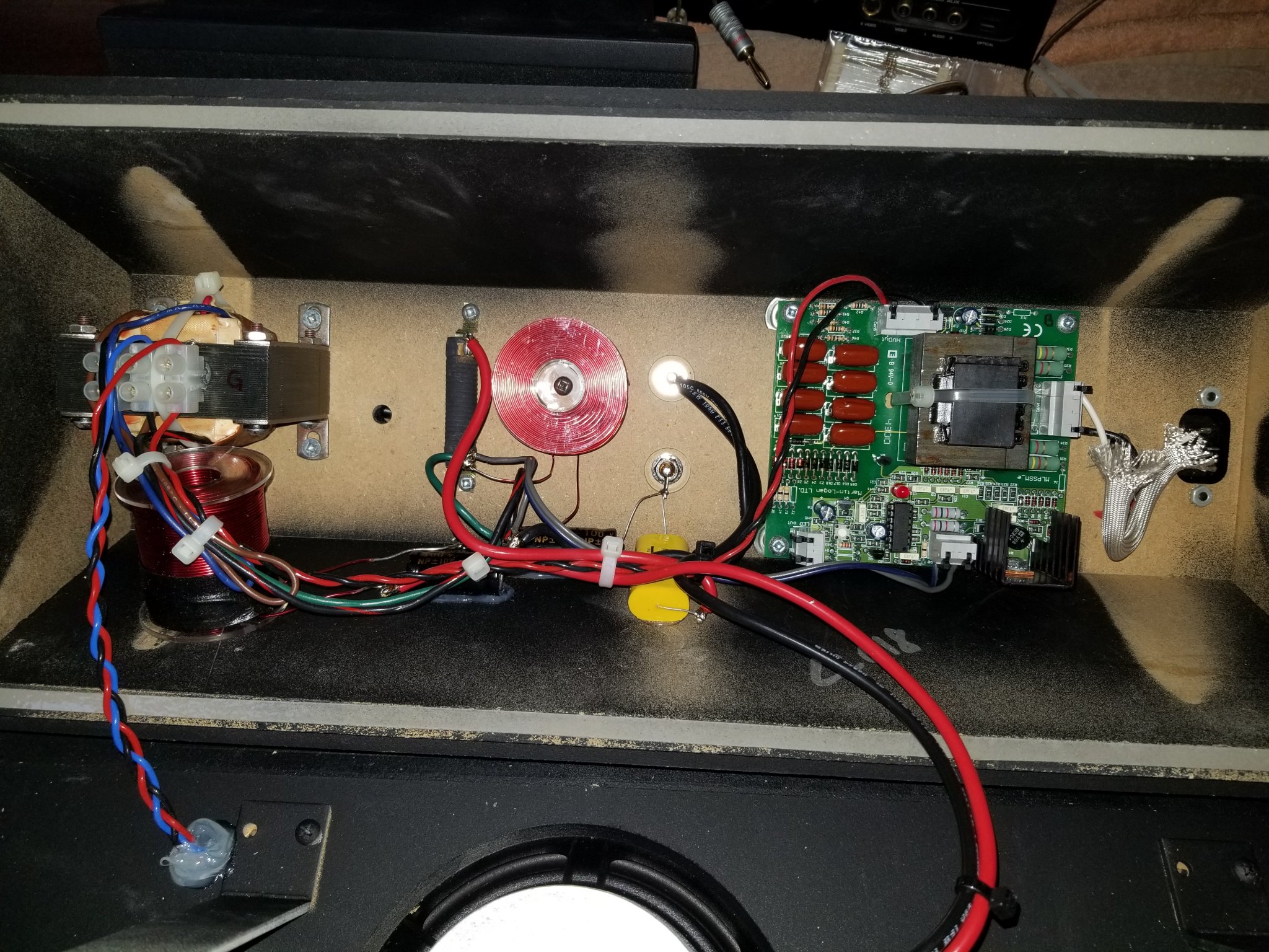

Had some time to do more testing. Originally, I thought it was the board, but switching them out between the 2 made no difference. Both panels are fine and verified both Bias boards are fine. It appears something in area with the crossovers. Switching cases replicates the problem. I can hear sound from the panel very, very faintly from the panel when using the bad case. There is a transformer in there with the model 486-07109 and under that 486-2000. Can anyone tell me what this does? I do not have a schematic for the Scripts, so trying to sort this out.
The Script seems to be a model where the schematic isn't around yet.
If you snap a pic of the overall board/speaker interior it would help.

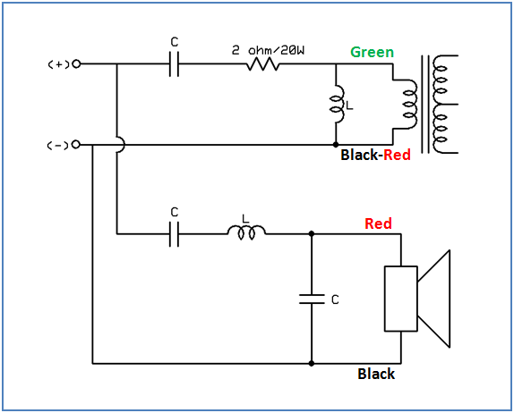

Based on the pic you posted in the other thread(attached below), I drew up the crossover schematic.
To confirm if the 2ohm resistor is your problem, just jump a wire across it. If you have an alligator clip terminated wire that would be an easy way to do it.
The 2ohm resistor really only affects things in the top octave, but just to be safe keep the volume low and play some music to see if the panel is now working.
Let us know your results.
Also, let us know what country you are from so we can better help you locate replacement parts.

Bolserst! So honored to have you respond, you are what I want to be when I grow up! Threw a jumper across the resistor, and the panel sings again. You are amazing! I have scrubbed the internet, but cannot locate the resistor as it is probably "vintage" at this point. I will try calling ML and Milwaukee Resistor tomorrow and report back. If you know of something that could replace it, I am open to options. I am in the United States.
Thanks again everyone for the support!
Great! that is good news...glad I could help out and that it wound up being a simple fix. It is unusual for power resistors to fail without obvious signs of overheating. But, I have experienced a similar issue once where the termination clamping band was no longer conducting electrically with the resistive wire element.

I'd recommend the 20W version of the 2ohm resistor to match power handling and mounting method of the OEM part.
