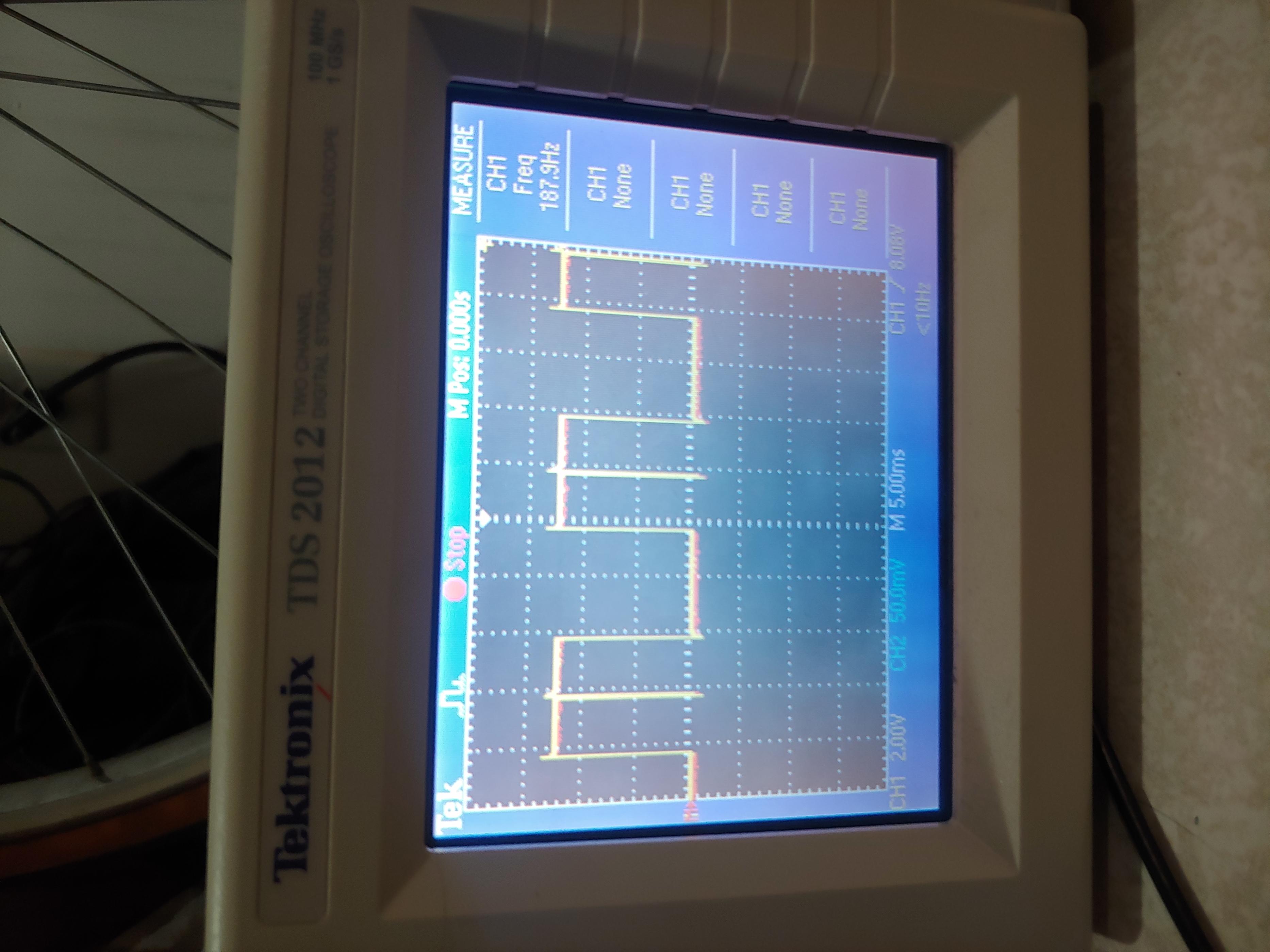

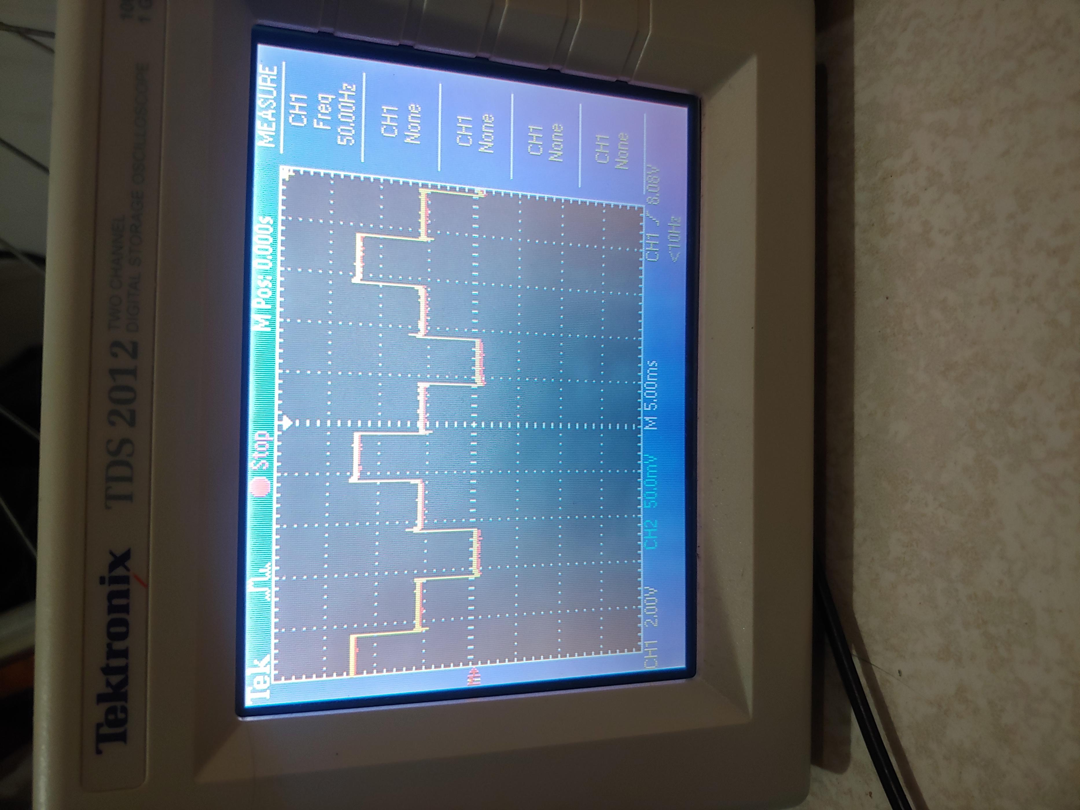

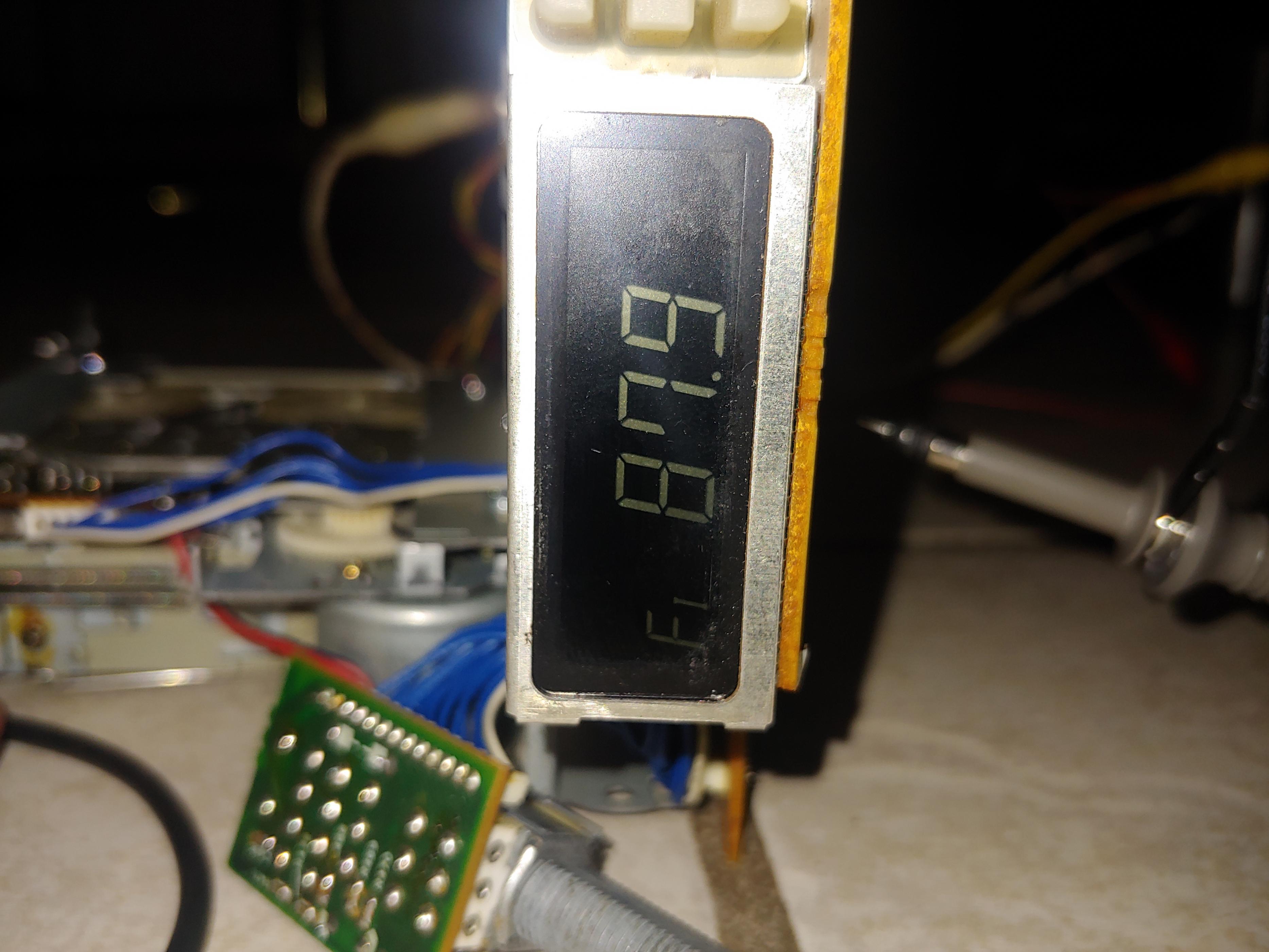

An LCD display like this one doesn't really need any sort of supply. The segments are driven on'off by almost no current.
I can't see how the lamps are powered. It's often directly from the power switch but can be from transistors. They won't be powered by the microcontroller, directly.
The pulses are typically 5v amplitude. I don't think you'll see any steady DC or ground.

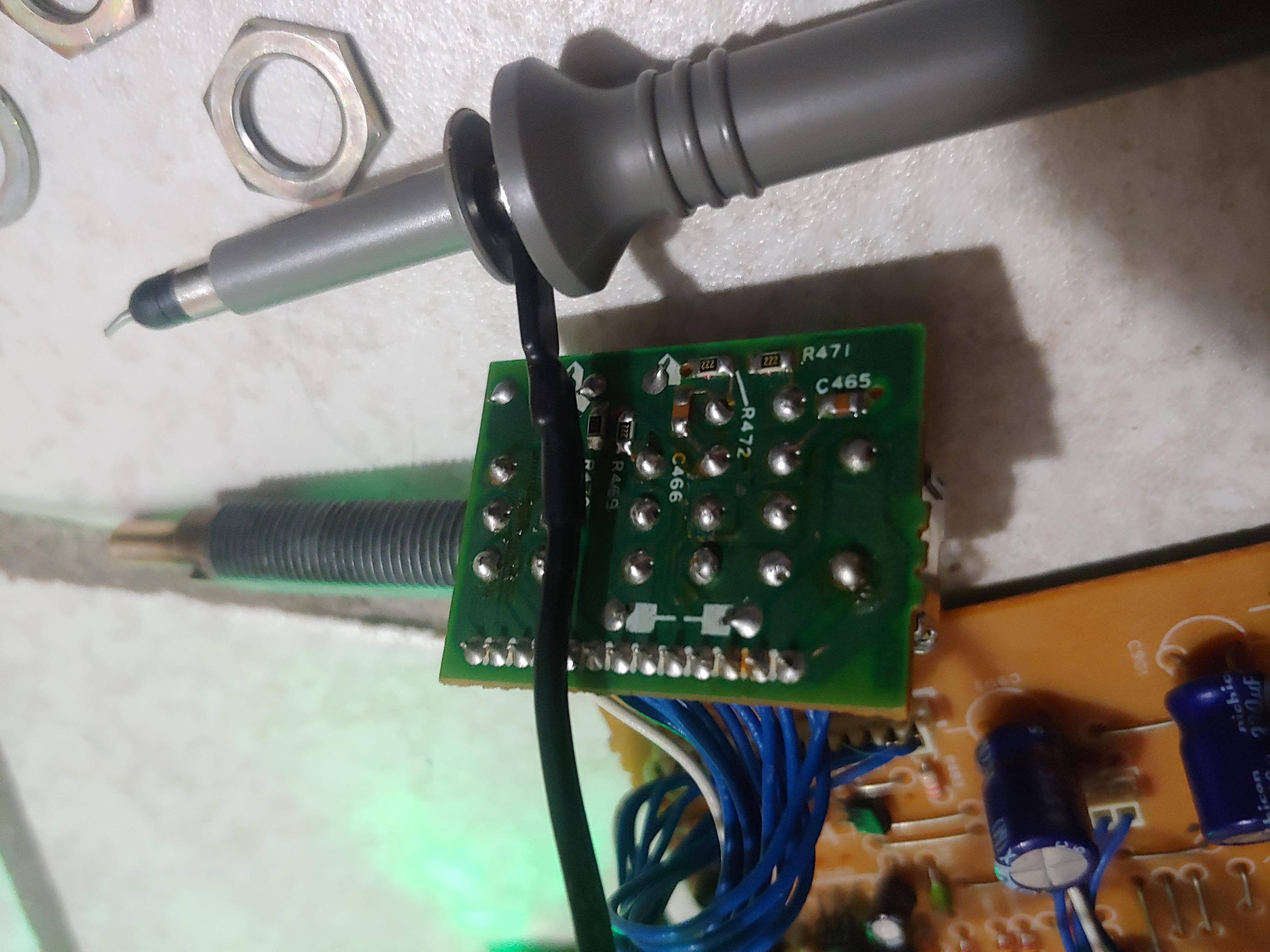

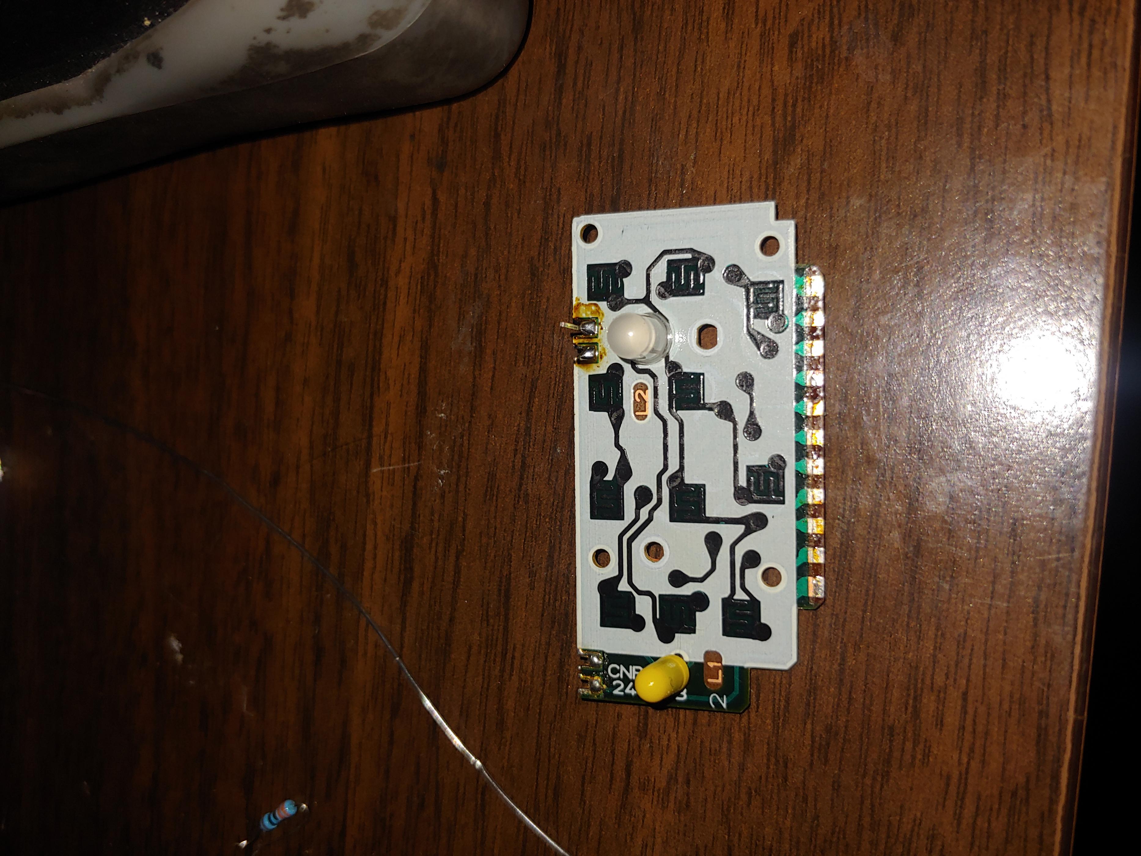

Well, I was about to say I think the display is bad cause the microcontroller is putting out good signals, but look at this. It's alive! But the backlight and button lights aren't working. I'm going to try and reflow the joints connecting the display and button board to the main pcb to see if that fixes it. If not, we'll have to keep digging.
Edit: both backlights have power. Bad bulbs maybe?
I swear, if this was just a bad power switch and faulty bulbs, I'm going to be upset lol.

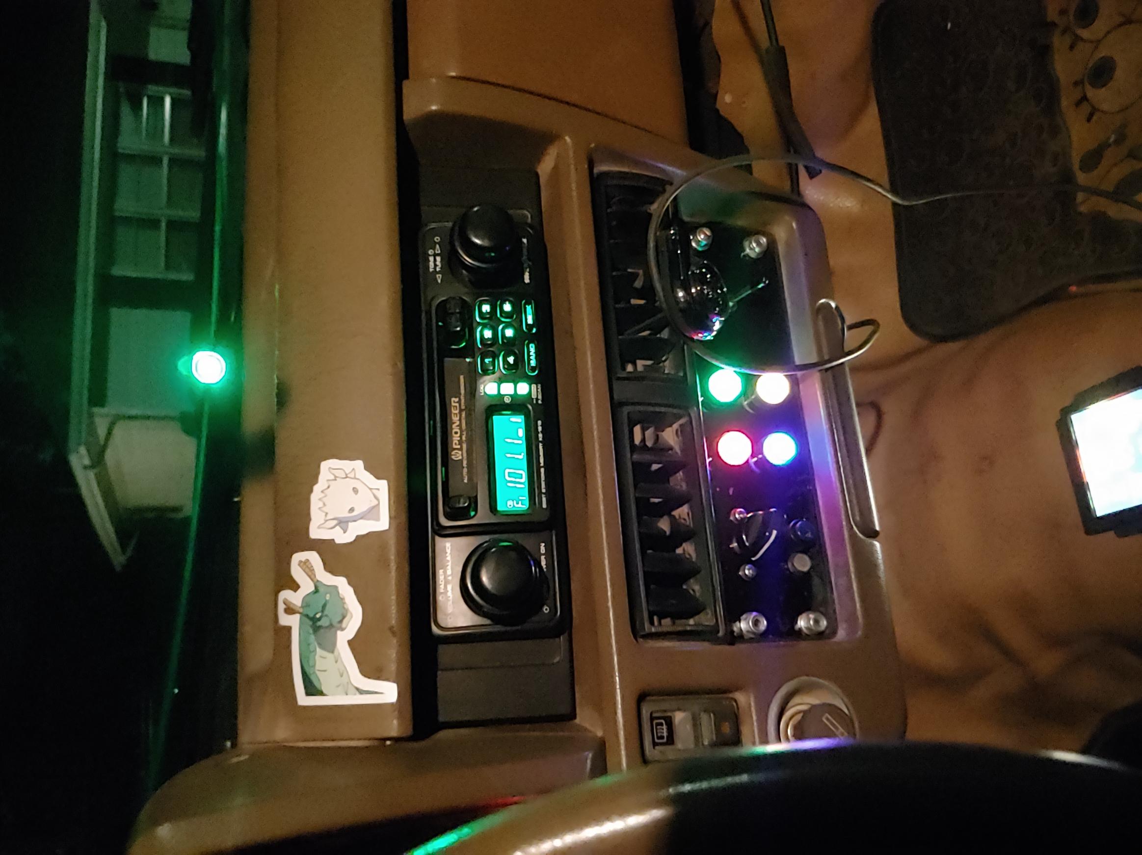

The lamps don't last long. When I was doing warranty work, they sometimes failed within the 1 year warranty. I'd likely use LEDs with series resistors as replacements.
That's what I'm in the process of. I've got some green LEDs that'll match my interior lighting nicely, however they are a size bigger than the bulbs. The button led will be fine, but the back light led, ill prolly have to remove a smidge of material from the plastic behind the screen to make it work.
T-1 LEDS should fit.

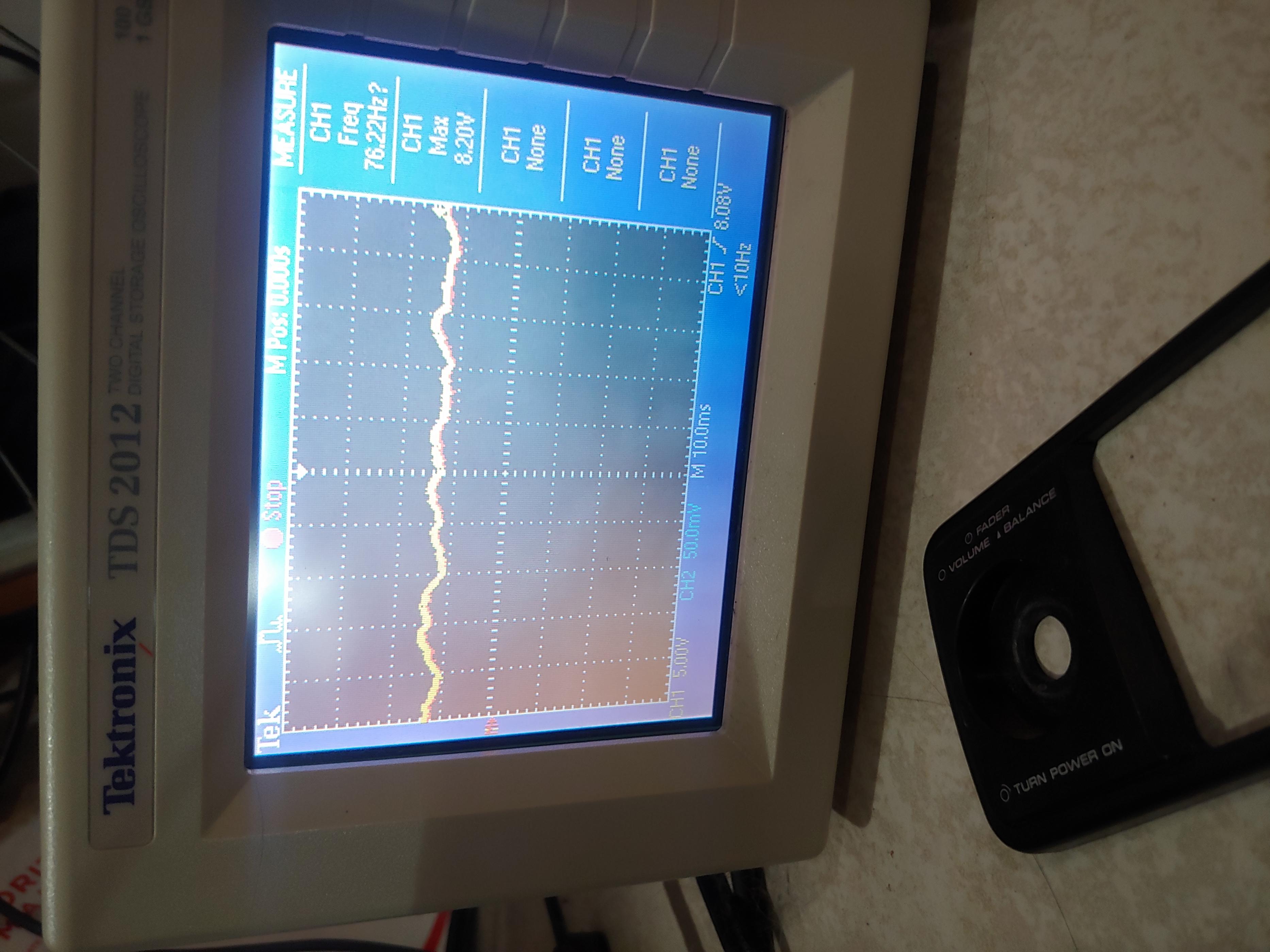

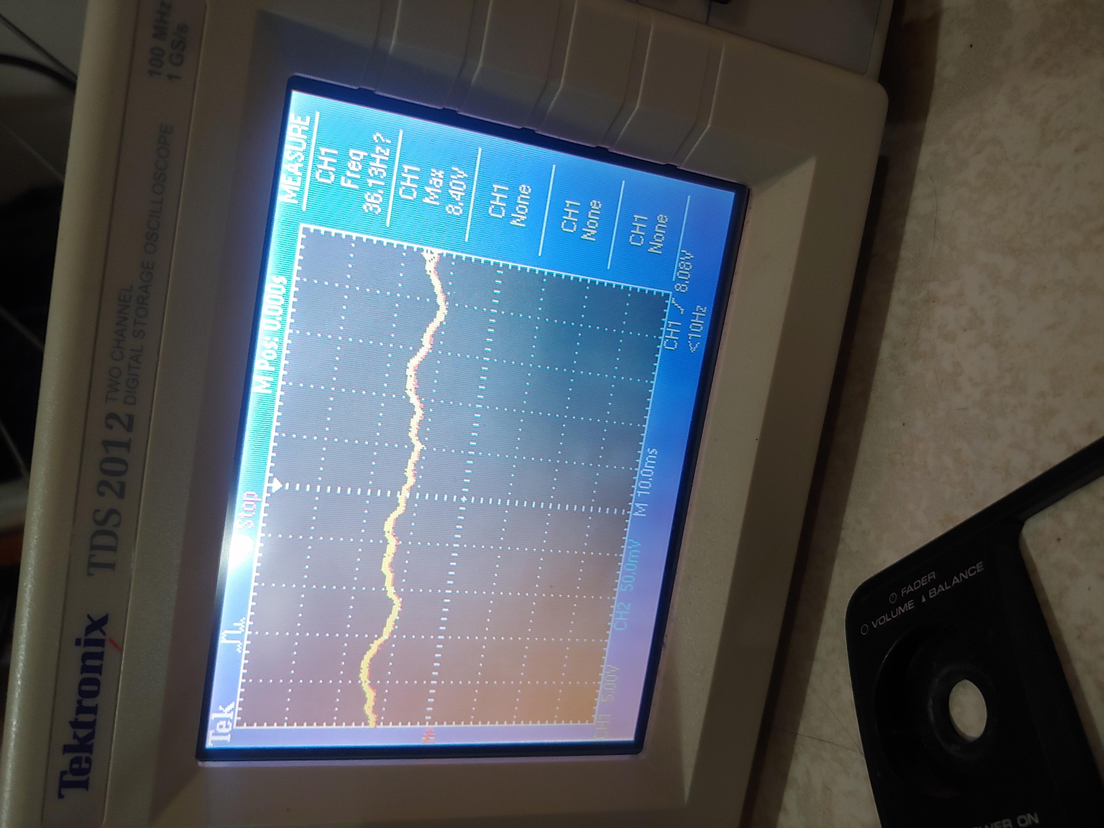

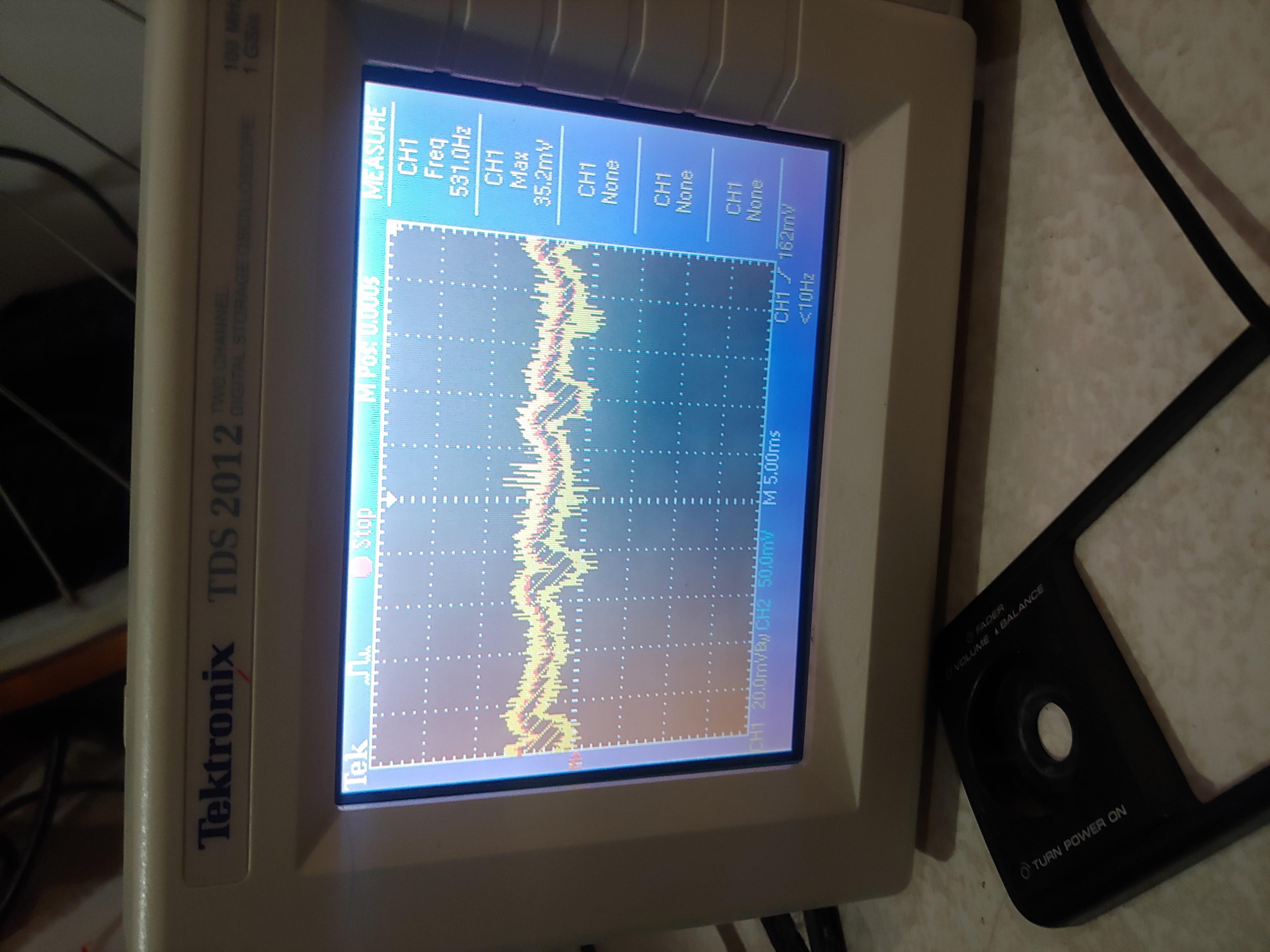

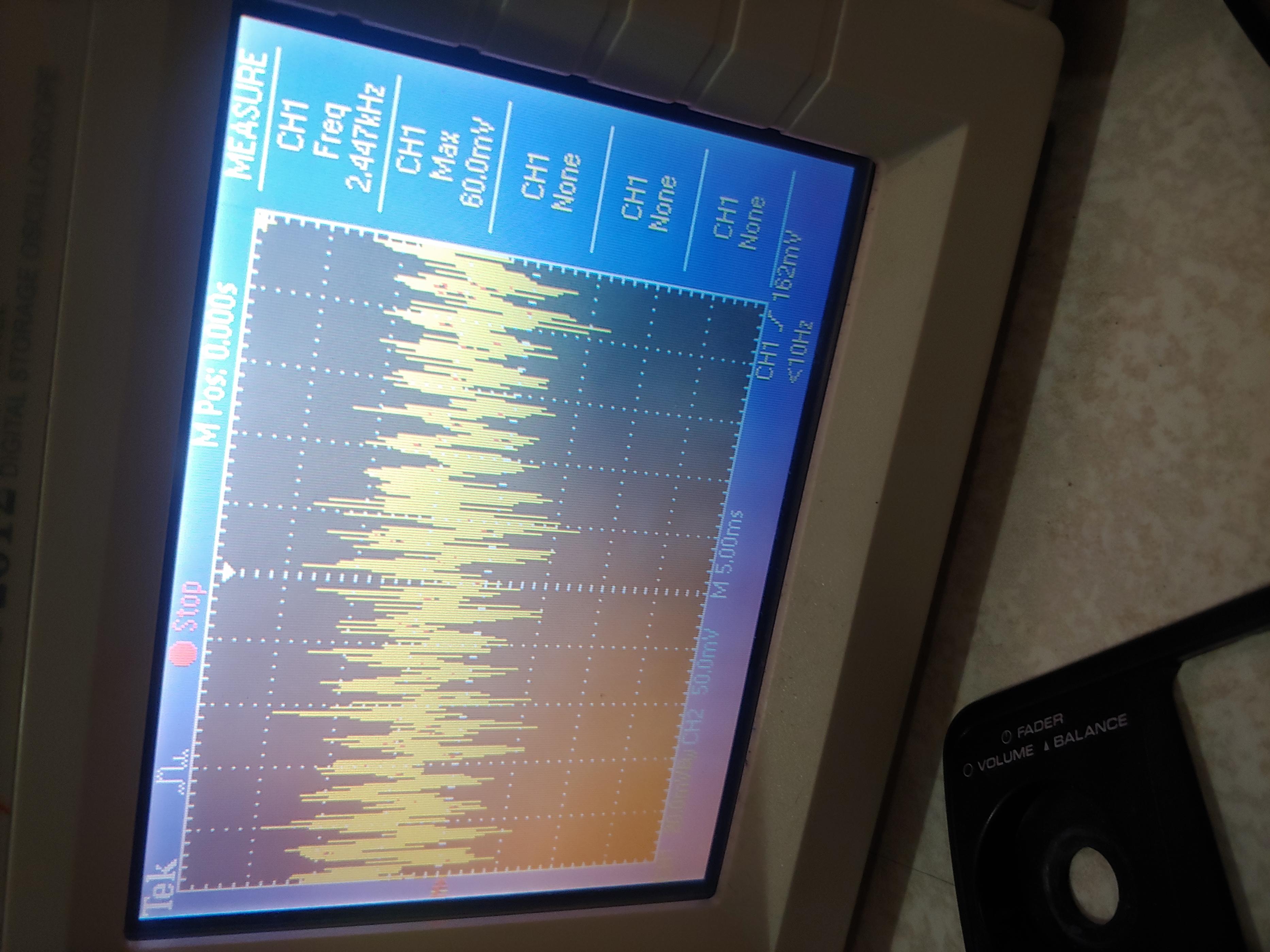

Just for giggles, I checked the output with my scope, and woah, there's an output signal! Then the gears started turning....pioneer didn't wire their stereos like they do today.
I assumed the green was speaker + and green/red was speaker - ... Nope. They grounded the speakers to the chassis and the green is FL and green/red is FR (not actually sure this orientation / color combo is correct). Soooo my wiring in my car is messed up. I hooked up a test speaker to the output and it works just fine. FML...
