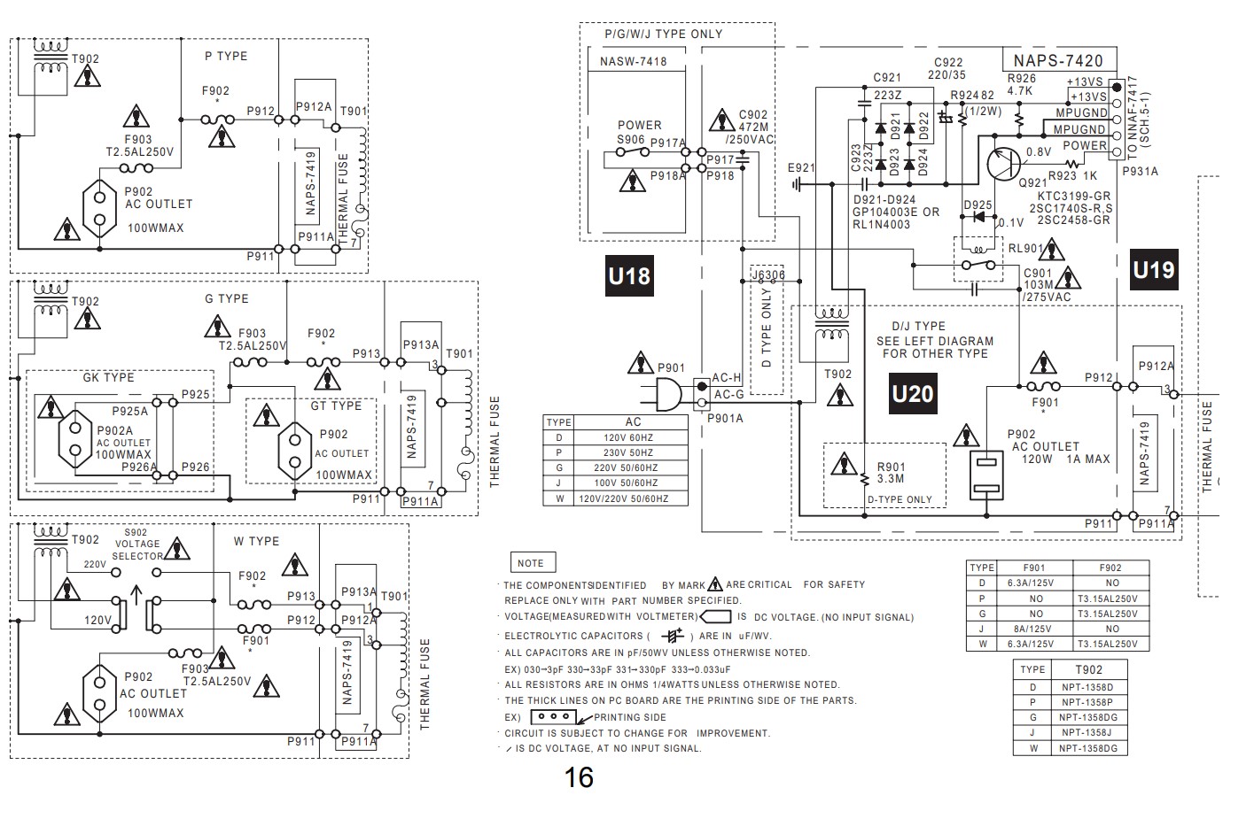

I would start by testing diodes and resistors on the standby board. Sounds like there might be a zener that is shorted allowing full 23v instead of 13v to the relay?
I haven’t looked at the service manual, so would help if you added a snip of that part of the schematic here.

I'm attaching the schematics of the stby-pcb from the service manual,
and also a zipped version of the service manual PDF (I hope this doesn't violate the forum's rules).
The stby-pcb is the It's the U20 module.
Is there a way to test the components while in-circuit? I wouldn't like to start disassembling everything 🙂
BTW - I failed to find a Zener diode on the pcb (but I'm a newbie, so I might have just missed it).

Caution! You will be working with a 120v AC electrical circuit. Voltage is supplied to the main transformer through the contacts of relays, POWER button and a fuse.
U20 contains a transformer, a 13V unregulated rectifier, a relay and a switch that controls the relay. The key is triggered by the POWER voltage from the main power supply unit.
Voltage 13V is used to power the start circuit and protect the main part.

Measure the AC secondary voltage on a small transformer. The DC rectifier voltage can be 1.4 times higher. If the bridge diodes are faulty, unwanted voltage doubling can occur.
Identify and check all parts of the startup circuit (not just the U20).

# 10 If the transformer is correct, then the voltages are correct.
The circuit works in conjunction with other amplifier circuits. Check separately the serviceability of the transistor and relay (if you close the с-e it should work).
The diagram shows the voltages across the transistor.
