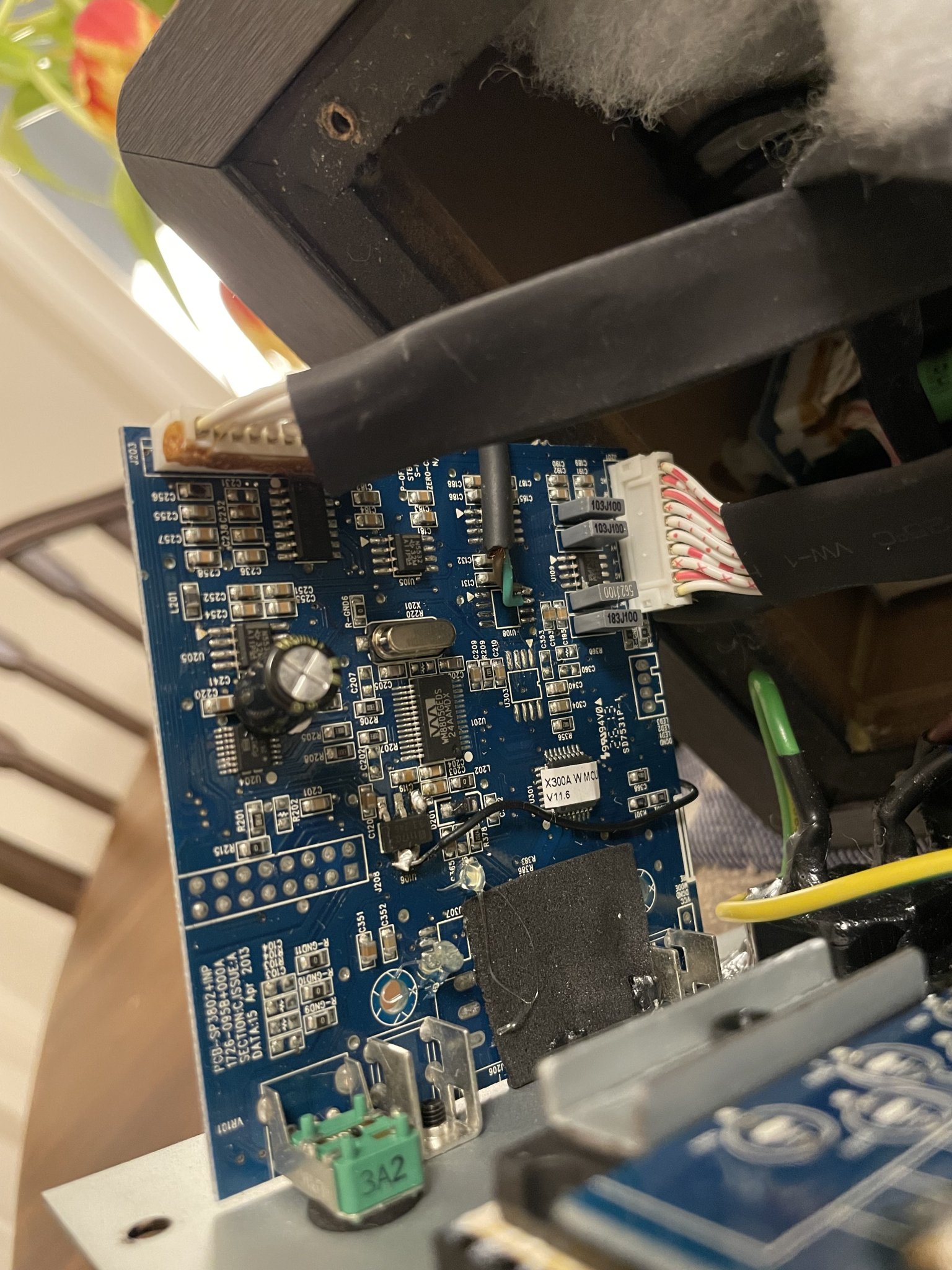

Hi, bought Kef X300A Wireless used that had a modified input arrangement, where RCA plugs were added each side. I'll try to include some photos for reference so others could try to replicate. Worked flawlessly for two years or so. Now have the issue that one is much quieter then the other.

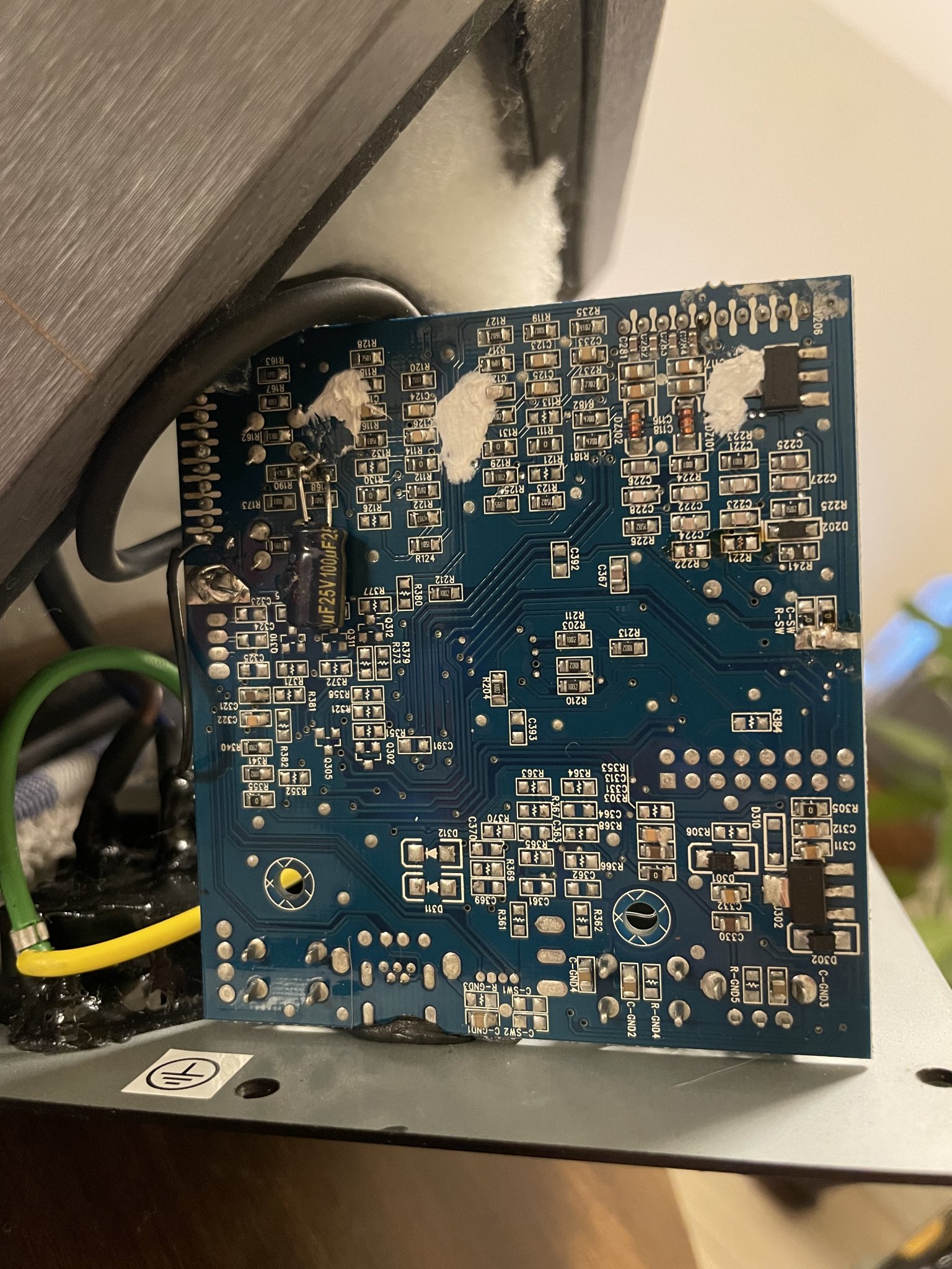

Somehow the photos were not included, let's try again.

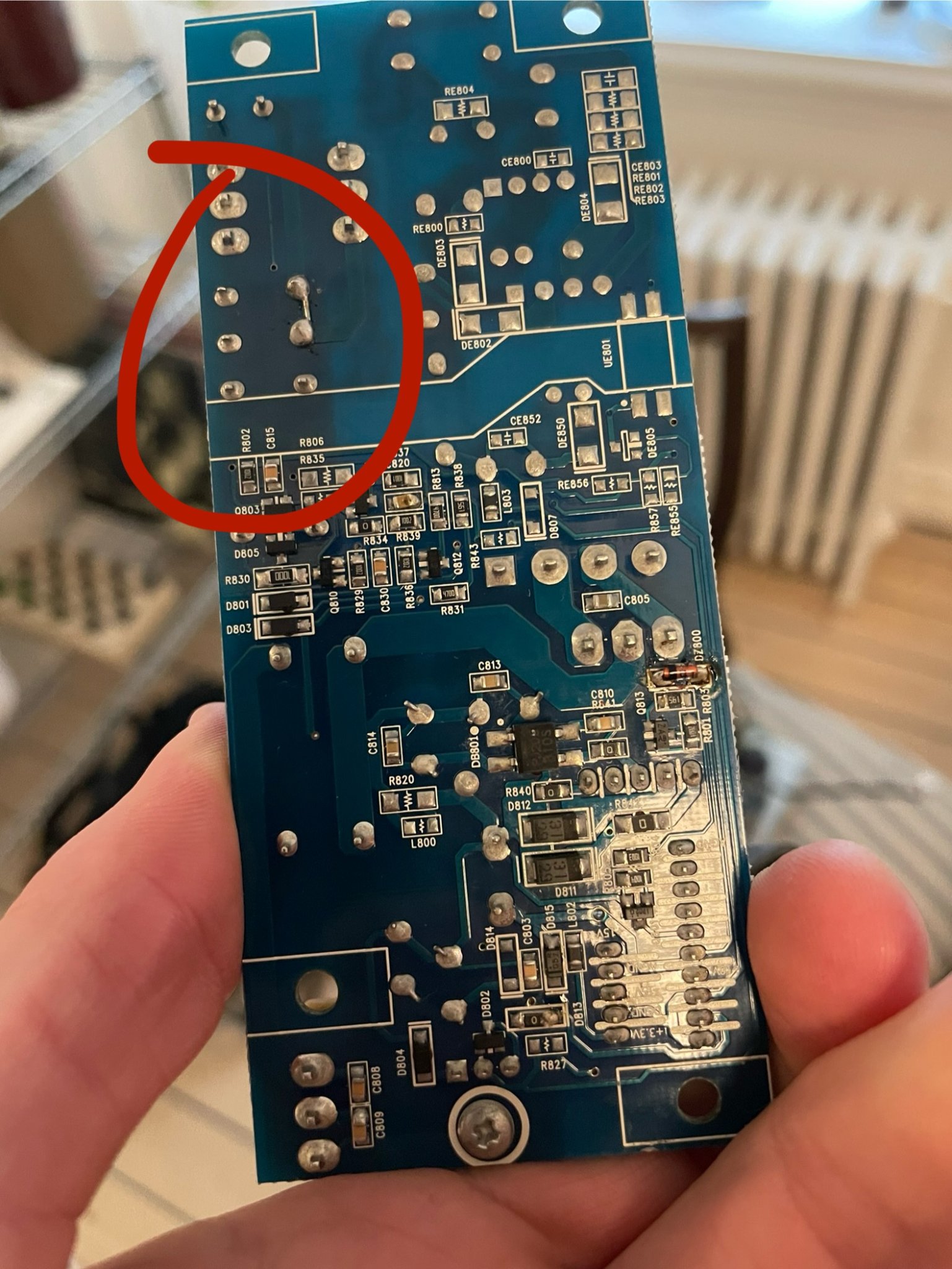

As said, I opened them because the "LEFT" one started become more quiet and noisy. After switching the power supplies between the two I suspect it's the power supply that is acting up. I don't see any bulging capacitors, but did see there was some bypass done on the relay, so it's not the first time the power supply has issues. This relay connects the AC 230V to the toroidal transformer.

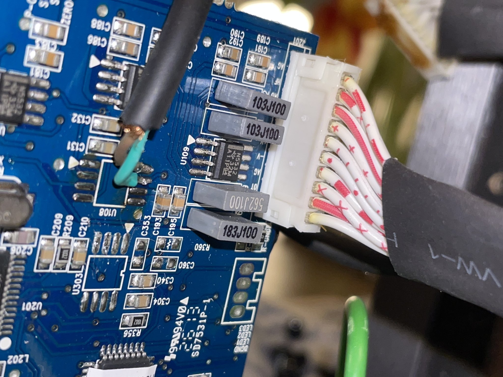

This is basically the changes by the previous owner to the signal path I believe:
RCA connector on the back of the speaker, connected to the top of the DAC board, hopefully before the signal is digitalized and the DSP does it's job (is there a DSP here?). Then there is a capacitor added on the backside of the DAC PCB board. And there is cable running from the front to the back.
I am not sure what the reasoning behind it is, but I guess it's bypassing the S/PDIF signal coming from the main, "RIGHT", speaker?

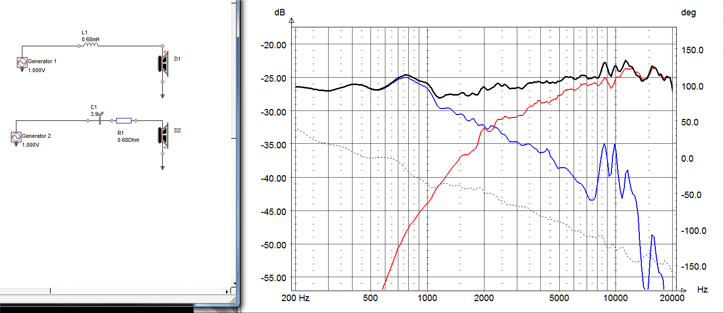

Beware original schematic shows Tweeter is connected out of phase with wooferSince you say you're not familiar with the software layout, I've attached a schematic which shows clearly how the crossover circuit is wired to the speaker input terminals.
The resistor is not shown, but you'll know where to put it! 😎
Correct, the software schematic shows the required phase inversion whereas my simplified diagram did not.
Since we're so far on into the thread, I think it best to attach the software schematic again, as well as include the verbal description I gave earlier.
Woofer section
Signal Out: amplifier positive to inductor to woofer positive
Signal Return: woofer negative to amplifier negative
Tweeter section
Signal Out: amplifier positive to capacitor to resistor to tweeter negative
Signal Return: tweeter positive to amplifier negative
Fascinating, Captain... This looks like:Somehow the photos were not included, let's try again.
- 100uF/25V in place of R168, at the input of the low-pass crossover filter. Maybe to try to get rid of a DC offset?
- Connections to U108: Note that U108 (mono switch) has been removed. U108 connects the "Cut" filter that's switched in when "Desk" is selected via the back panel switch. Its removal means that signal is no longer making it from the USB Audio -> SPDIF receiver -> DAC source. The green/brown wires shown connect line level input to the output of U108 - immediately before the crossover.
- Connection to J201:10. I think this connects to the relay on the amplifier board, and is connected to a regulator (U106) to override the speaker relay control that ordinarily comes from the micro (U301)

Switched input boards and power supplies over from the good to the bad speaker, still have the issue of static noise and less low-frequency sound. So the issue is probably on the AB amplifier side.
Also, noted that the relay of the power supply was bridged.

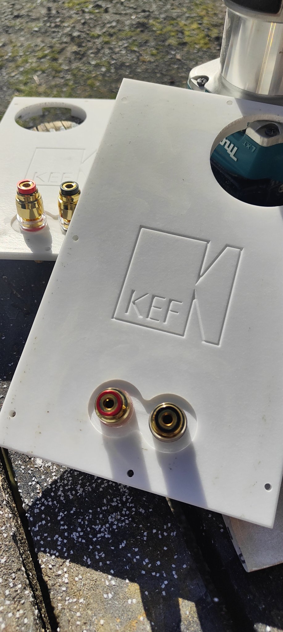

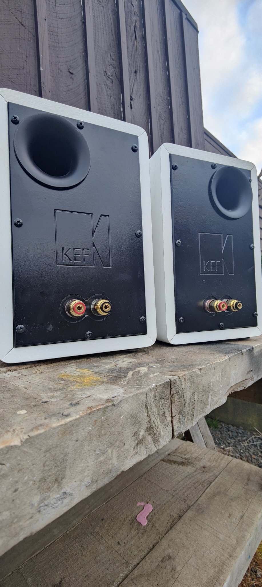

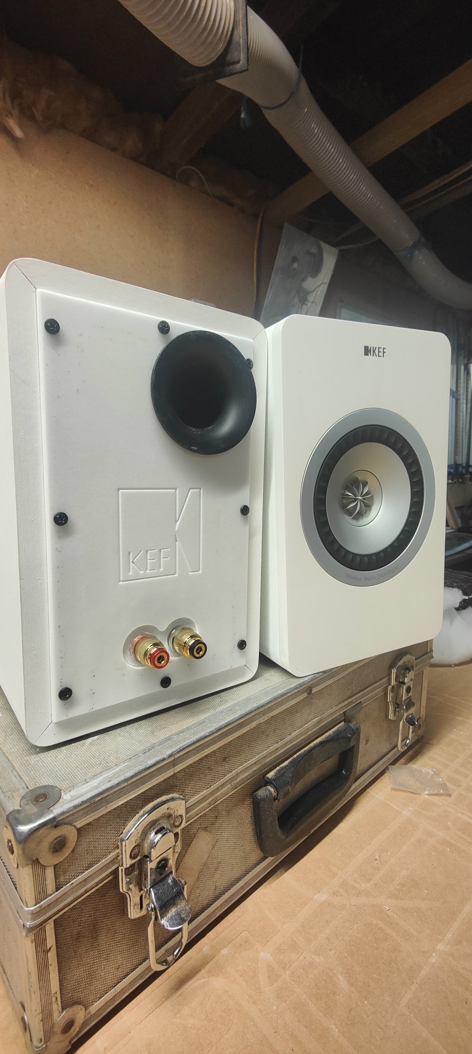

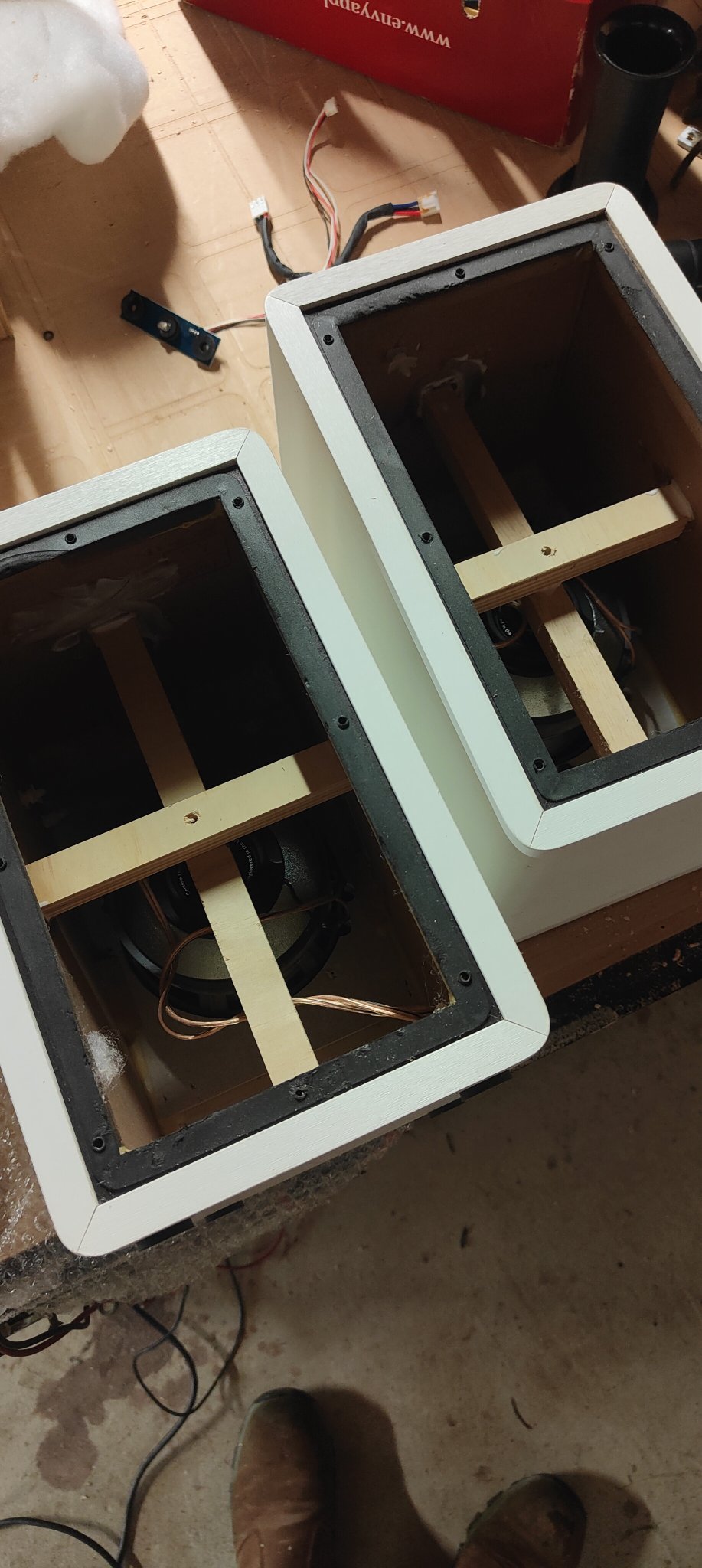

A customer had a dead pair of these and linked me to this thread.

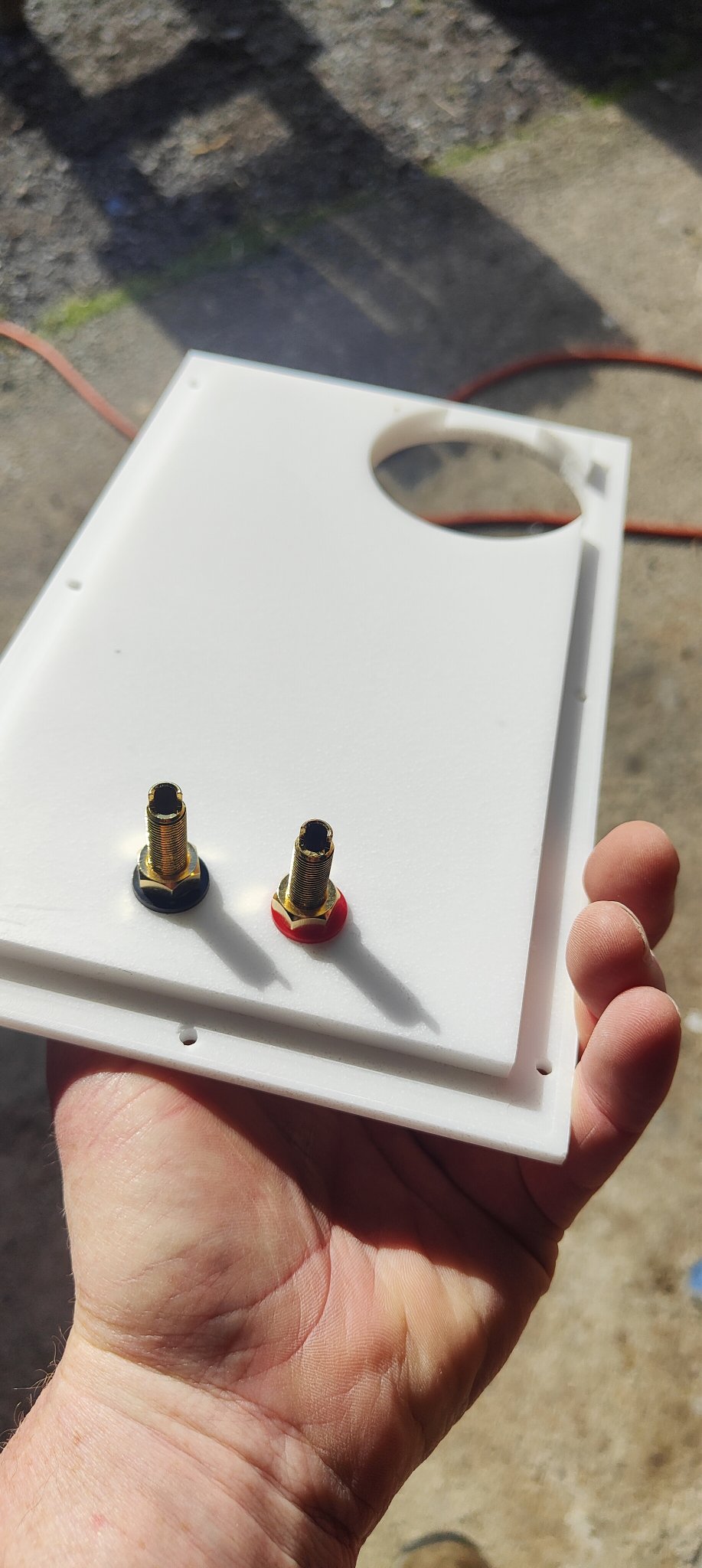

I removed all the internals and sealed all the bolt holes and the little led one on the front, added the cross braces, lined the walls and installed the crossover from Galu.
I machined new back panels and reused the ports and installed new binding posts.
Customer was very happy!
Thanks for this thread 👍
