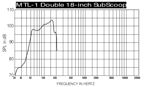

Not hard to do, most of the internal space of the MTL-1 is wasted on the horn portion which starts working at around 90Hz.We’re not after an earth-shaking, rave-style bass setup—just something clean and kind of flat, but with a bit more low-end extension than the MTL-1.
-10dB at 45Hz, and only ~82dB sensitivity at it's Fb (box tuning frequency) of 38Hz.
The L-Acoustics SB18 uses a driver like the B&C 18SW115, which has around double the excursion of the EV DL18MT, so one driver =2.I’m also considering building two single 18” subs instead of another dual-driver design, since modern designs seem way more efficient and might even outperform two MTL-1s with half the drivers. Thinking of something along the lines of an L-Acoustics SB18.
Given enough power, it could step on the low frequency output of the MTL-1.
The Keystone sub is around the size of the MTL-1, but has good response down to ~37Hz using a single B&C 18SW115-4.But we can still be interested in dual-driver design...
A pair of L-Acoustics SB18 would have a bit more output.
