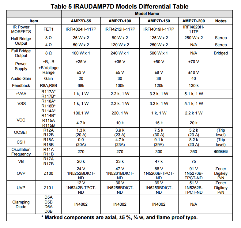

Some good news. After adjusting the pot resistor to as close to 265 ohms as I can (the damn thing is so sensitive!), it seems like it improves the issue a little bit.
1 Channel is still dead upon power up, BUT with the corrected resistor matching for both channel the dead channel comes alive at much lower volume. I didn't have to crank to reference level to kick-start it like I had to before. It definitely a lot less annoying and more use-able now. I'm now considering keeping these.
Now I only have time to test one board. Will test the other two later to confirm the improvement is replicable on other boards by just matching the pot resistors to 265 ohm.
Might also try ShangHai's recommendation later. In the mean time I'll try to email them to see what their official response is.
Thanks a lot for all the replies so far guys! It's been a huge help.

The problem is that even if they were both at exactly the same resistance, that doesn't mean the frequencies are the same. The trimmers are there for a reason (fine tuning).
Now clean up your wiring like I suggested and see if that makes a difference. 😉
Ah, you're right. Adjusting the resistor value without checking the corresponding osc. freq is just plain meaningless.
According to this table from IRA ref design, the board I got is closet to the AMP7D-150 and they're using 300 ohms here if i read this correctly. This is only assuming that SURE has followed this reference design. But they have shown to change components here and there, mainly resistors, in their final design so the correct pot resistor value to yield 400khz can be 265, 300, or even something else completely.
My multi-meter only measure up to 20khz so I'll need to get a different one to verify the osc. freq.
Thanks!

Actually ran into this blog post that uses the exact board I have (Sure 2 x 125w). And he uses 200 ohm to get 400kHz. So I'll also try that tonight.
He also showed how to adjust the gains/input Vrms, which is pretty cool.
