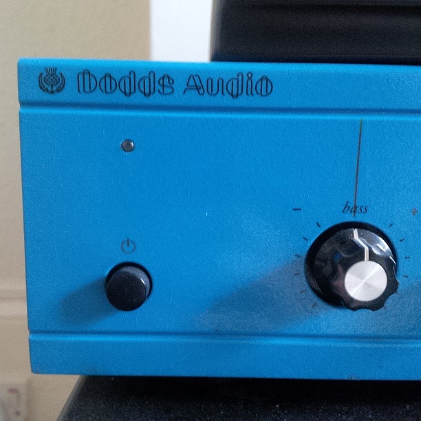

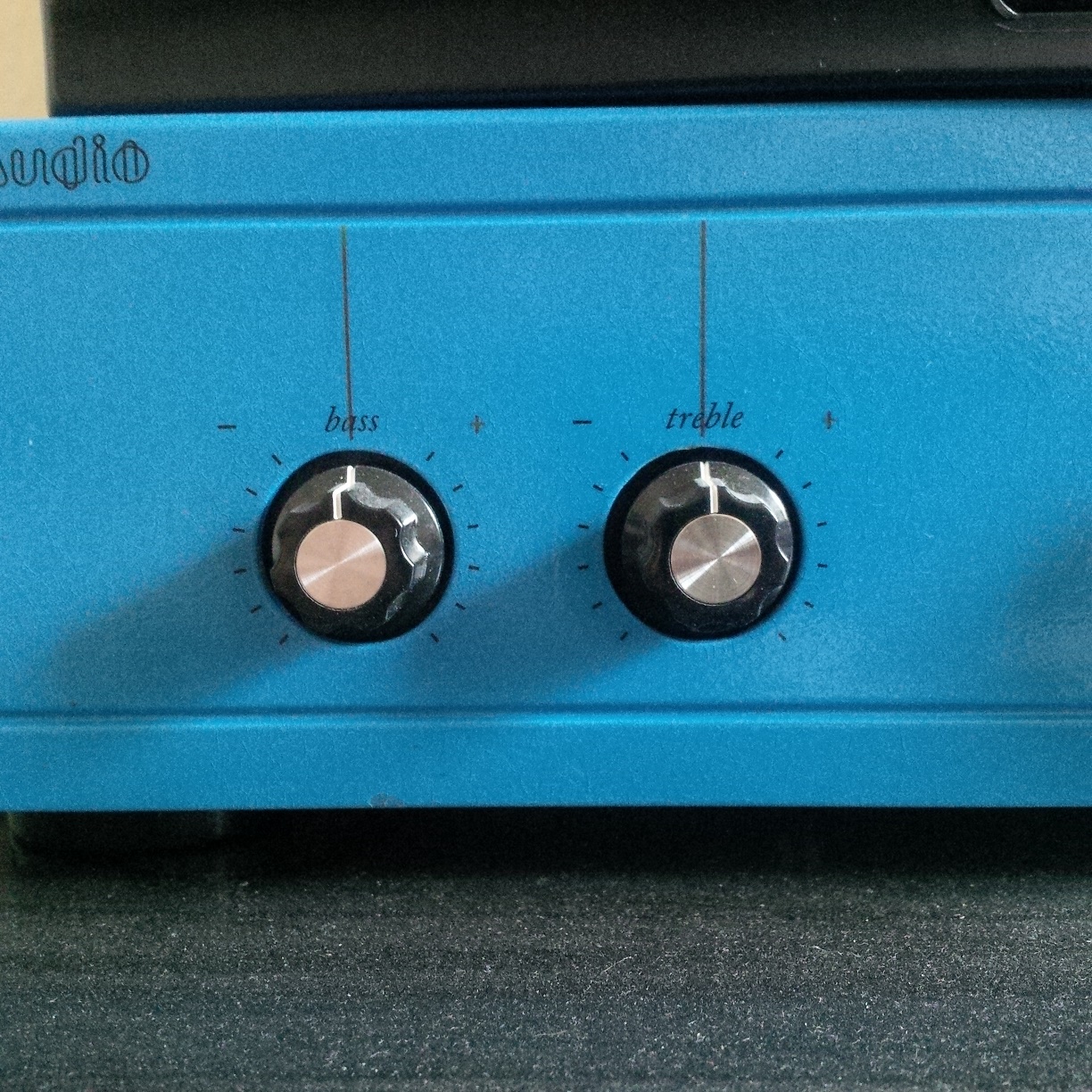

I finished it up and got it all working. Clean pots, back together and all is well. I've only now got around to taking a few pictures as it's been at my friend's house. I had a nice time getting it powder coated; replaced the knobs with ones I prefer; printed my own waterslide transfers and laid on lots of coats of lacquer. I'm pretty pleased with how it's come out!
