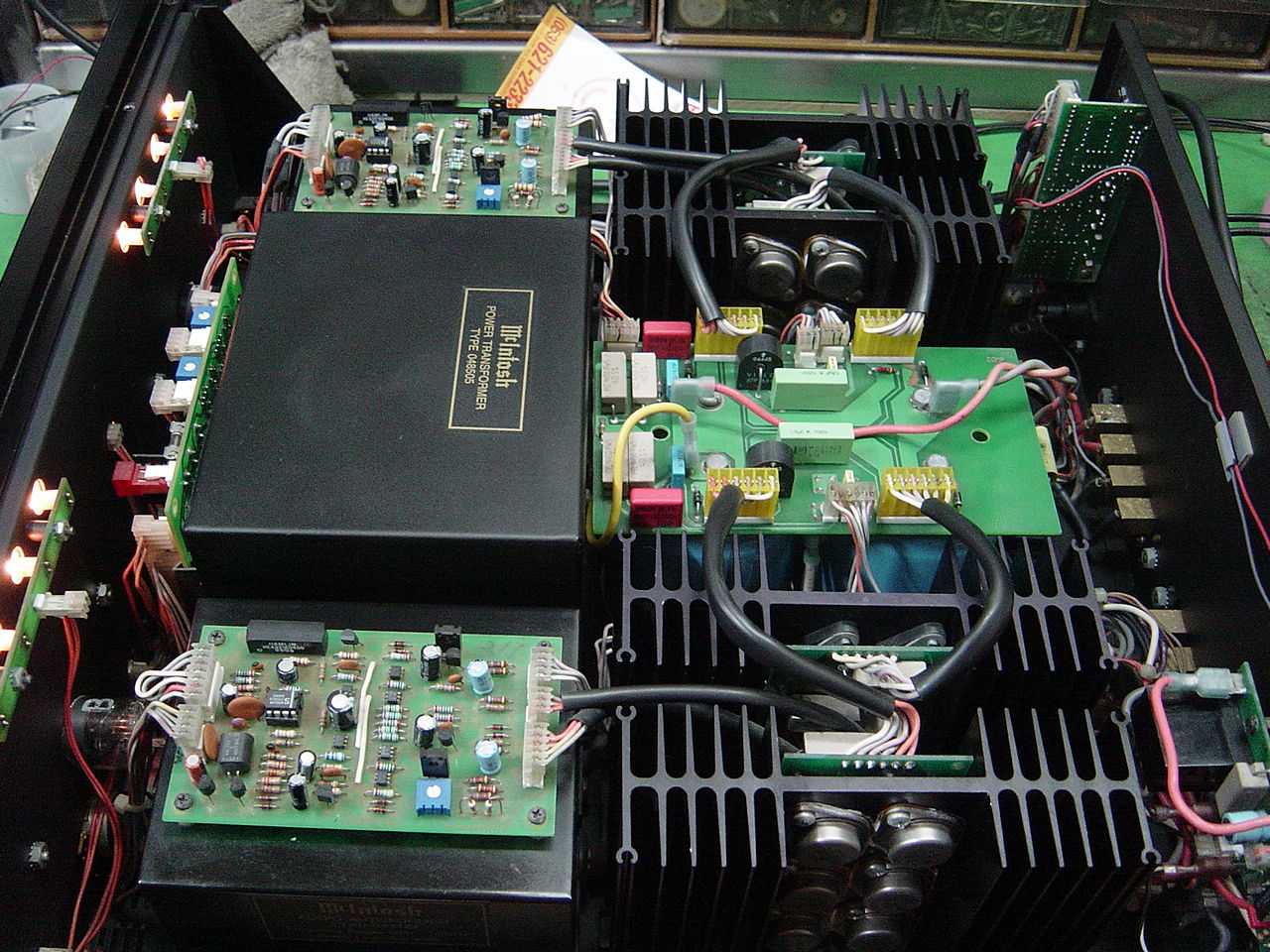

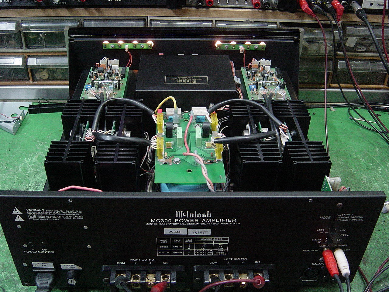

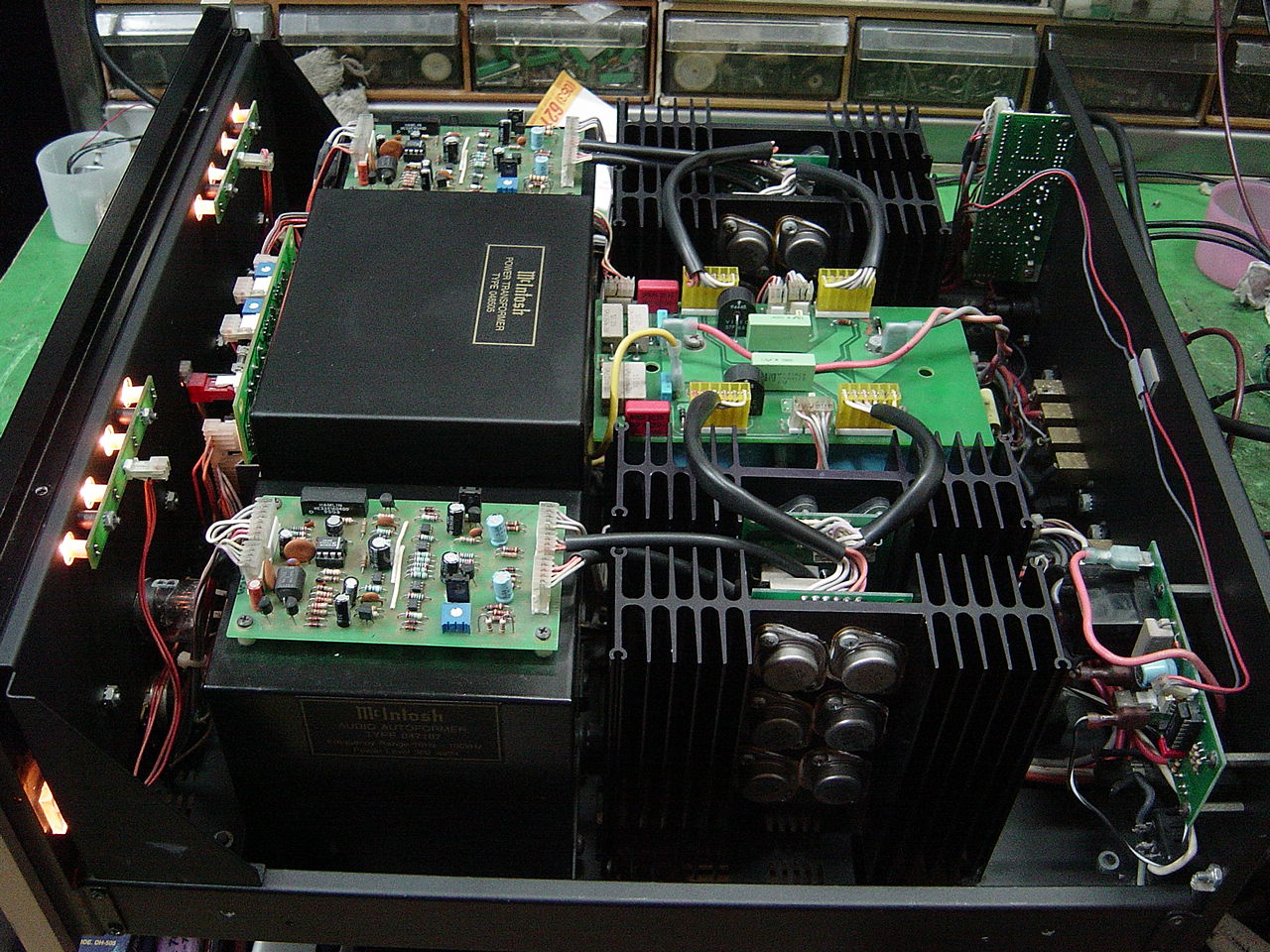

Pictures of MC300
just thought I would post some pictures!

Touching the rail voltage with dry skin with ONE hand is mildly painful, not dangerous. NO RINGS No dangly neck jewelry. Keep other hand in pocket, not touching the chassis or any other bare metal. It is current flowing across your heart that is dangerous, or jewelry will cause unlimited current to the skin that touches it that can cause major burns.
clip the meter negative to signal ground (like RCA jack ring) with an aligator clip lead, use one hand only to probe around with the other.
Those diamond shaped transistors have rail voltage on the tops. I don't see the big round rail capacitors, those have rail voltage on one terminal. Possible the 120 VAC relay is on the board barely visible on the lower right, it does have a big power resistor.
I see a relay on the lower left board, the relay I saw on the schematic has 120 vac going to the contacts.
Not if unplugged.
The big round rail filter caps store current possible even if unit is unplugged. They go to the output trnasistors, so don't unplug the latter unless voltage on filter caps is < 1v. Read the high voltage safety thread under tube amp forum to see a cap discharger. I use a 47 ohm 5 watt resistor between two clip leads myself. smaller plastic covered e-caps also can retain voltage, but the amount is not major below 220 uf in speaker drive amps.
