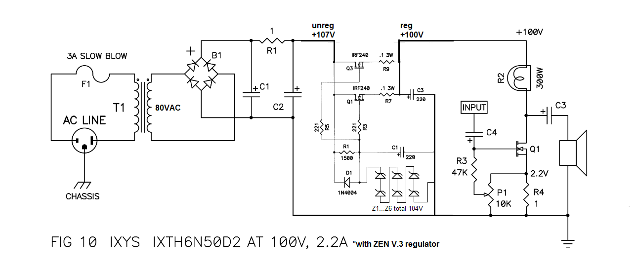

Dear Mr Pass,
I really appreciate that you shared this amplifier design,I have built the SOZ with 10w output four years ago.Right now,I am looking for your new amplifier.I guess this one is the best choice. I have two idea to modify this amplifier.I expect you can take a few of you time have a review and give your suggestion.
1. May we use a single-end output transformer to replace the R2 and remove the output capacitor?If we can change this,what primary impedance of the output transformer should be the best to match this amplifier? Not sure whether impact the amplifier performance?
2. May I use the SJEP120R100 to replace the power MOSFET?I guess the distortion will be reduced.
I am expecting your reply.You help will be great appreciated.

There is an article in Linear Audio Volume One which deals exactly with the questions you have posted. There is a schematic and everything.

What is the Value of c2, c3, c4, and the number of available mosfets? And the voltage of the incandecent light? Thanks

hello Mr.Pass,
i am interested to build de-lite with IXTH6N50D2 at 100vdc 2.2A
however at the articles mr.pass said there is an improvements offered by
power supply filter and regulator circuits as shown in Zen Variations #3
which will reduce noise and add more stability.
is this how we connect altogether? 🙄
and also for C1 and C2 how about if using 2x 47uf/250v like tube amp does, will it deliver more speed?
