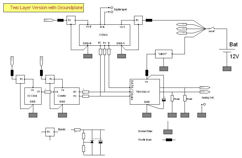

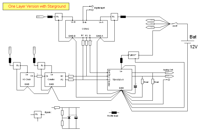

As many people have built the dddac1543, I consequently received a lot of feedback on ways how to improve the design. Specially on the PCB lay out I had several.
Currently I am planning a version "mark II" where I will incorporate a number of ideas. As I do not want to rush into the new version, I like to ask the Forum inputs on 2 possible versions of the PCB design and values of the components find in the circuits below...
Next steps is to build a prototype with exactly the same components as my "reference" DAC at home, so a fair A-B comparison is possible between current and enhanced versions.
I am specially interested in feedback on the 2 versions of pcb design: One layer Starground or a 2 layer pcb with Groundplane.
Any other feedback is welcome, but please refrain from off-topic discussions about DAC chips for example 🙄 for that we can open other topics
Looking forward to your feedback !

Will there be one socket for 1543 or eight?

first of all, I think the PCB needs to be larger around the DAC tower to allow room for heat sinks that extend from the tower all around it.
Another thing - drop that battery checker section - who needs it? I read you can hook up a smart charger through a diode and never have to turn the thing off (or is that wrong? ever test it?)

Re: Will there be one socket for 1543 or eight?
I still like the tower concept for its ease and short connections, but it is true that you need to make sure it cools well...
8 chips next to each other on a double layer board is ofcourse les of an issue...
Thanks for the feedback, I will keep this one in mind. Hope to get some more inputs on this subject (tower or loose chips on pcb)

Hi Peter, no issue, this will not be ready for a longer time, I am sure you will enjoy the current version.... and by then you might want to do some experimenting again 😉
If the results are not clearly better than the current version, I will not move on to a mk2 version any way. But lets wait and see ! I see this as an experiment to look for bounderies and what can be done....
Larger PCB, yes, some extra space could be good,
The battery checker is bought by more then half of dac-builders, so why not?

Some thoughts. Make the DAC differential and modular.
Use small vertical daugther boards, 4 TDA1543 each with local PSU Reg and decoupling, re-clocking and buffering with the 4 Chips on one side and all the other logic on the other side, make the whole thing differential to start, so the basic version has per channel 2 Chips in Parallel/Differential.
You should then be able to use the modern nice copper RRAM cooler thingies to keep the chips running way cool and you can make the DAC highly scalable, all the way up to (say) 32 Chips (8 modules in parallel).
Also, the three dimensional layout with horizontal base PCB and vertical DAC modules can be used to keep all current loops really tight and short. I would design this also such that you can use a pair of batteries, one for the Receiver et al and one for the massive parallel differential DAC, which will with 32 Chips draw the better part of 2.5A!!!!
Lastly, a modest RAM buffer is not that hard to implement, why not go for it?

I personally like the DAC tower, I found mine quite easy to do once I figured out to use Arctic Silver adhesive to glue brass strips to the chips. As was mentioned the only problem was that there was not enough room for this, I had to move two components to the back of the board to have space for the strips coming out of the tower.
On the grounding, I would definately go with a ground plane approach, but I would break up the parts into different groups, each with its own regulator.
I would have the Tent clock on its own system to keep it as absolutely clean as possible. The current going into a CMOS chip is fairly low so there will not be much of a ground loop with it. BUT the inputs to the 1543 are TTL so they definately have siginicant current, especially when paralleling 8 of them. This means that its going to be tough to separate grounds, so a single ground plane is probably a good compromise here. I would put the Tent clock on 1 supply on its own, the divider chip and the reciever on the other and of course the DAC on its own high current supply.
Another major issue is bypassing caps. You need bypassing caps at each chip (well at LEAST one for the tower, if you can fit them in a couple along the tower helps). I added some .1 uf monolythic ceramic caps at each chip and it made a big improvement in sound. I would also probably go with at least 200uf (Panasonic FC is what I use) at the DACs in parallel with the .1 ceramic. The TL431s seem to work very well, but some bypass caps still help a lot.
Currently I'm implementing mine with three separate battery supplies using NiMH batteries, with a 7.2V NiMH for the DACs thus I bypassed the regulator altogether. (I tried 8.5 and could hear no difference)
Just one other little nit, the mounting holes were way too small. The only commonly available US screw that fits those holes is a 2/56, which only comes in very shorts sizes. Since I mounted some components on the bottom I needed to lift it up a bit above the base so I had to drill out the holes so I could use a 4/40 screw.

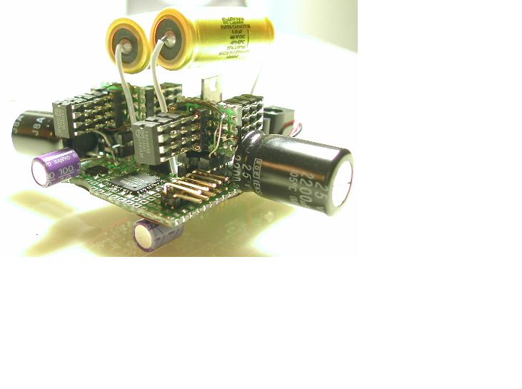

Just as John Swenson described it, I've put together my DAC towers (I am building two of these DACs at the same time) with copper strips and arctic silver glue (great stuff!). When I started I thought I would be able to bend the copper at the edges and then glue on a large heat sink, but the board doesn't seem to allow that. So ignore the shape of the fins here in the assembly stage. The glue settles in 5 mins, so you can put together a few pairs, then an hour later make 4-packs, and again an hour later you can build the 8 DAC tower and then leave it clamped to cure overnight. Soldering the finished tower is a breeze:
Now that I have most components on the board, I realized that the DAC had very little room in the direction of my heat fins. The small blackgate to the right of the tower location blocks the right side heat fins of the lower two chips, while the large heat sink for the LM1085 regulator prohibits a really long extension of the fins in that direction (ok, I should have bought a smaller heat sink but I believe in good cooling ;-)) That large capacitor on the top edge is a 47uF blackgate replacing the 20uF in the schematics at C10 - that's in response to the thread about the LM1085 startup noise. As you can see it's a rather big sucker and should also be moved away from the DAC area as well as the LM1085 heat sink. I had to bend it to the side to clear my heat sink.
Even the small pot to the left of the tower and the black resitor over there reduce the space for the heat sinking I had in mind initially. So what I'll be doing now is bending the fins up at a 45 degree angle and then use some more arctic silver glue to put copper fins at a 90 degree angle on the existing fins, enlarging the cooling surface by a few hundred percent. I'm not sure if that will be sufficient cooling without fans, but I'll try my best to avoid any fans. I have a few small fans that run pretty quietly at 5-6volts, but they still do make some noise I'd rather avoid.
In short - about 1" of clearance around the DAC tower location would be great to have.

My first 1543 DAC
My first TDA1543A DAC, just built few weeks ago.
8*chips for each channel, An EPLD for data re-arrangement to right/left channel for differential or single end. A small 90 degree daughter board carry 8chips total with 4 on each side to shorten the length of signal path and reduce overshoot or undershoot caused by signal reflection. I turn the chips tower 90 degree to prevent the toppest chip is cooked by the remaining chips !
and the heat disspation is better no matter the airflow is vertical or horizental way. How about the sound ? Amazingly good !!!
Thanks for you guys, you are the audio experts on this website contribute so much on 1543NOS so that we can learn from you and base on your experience to build our own equipments and don't have to start from scratch.
