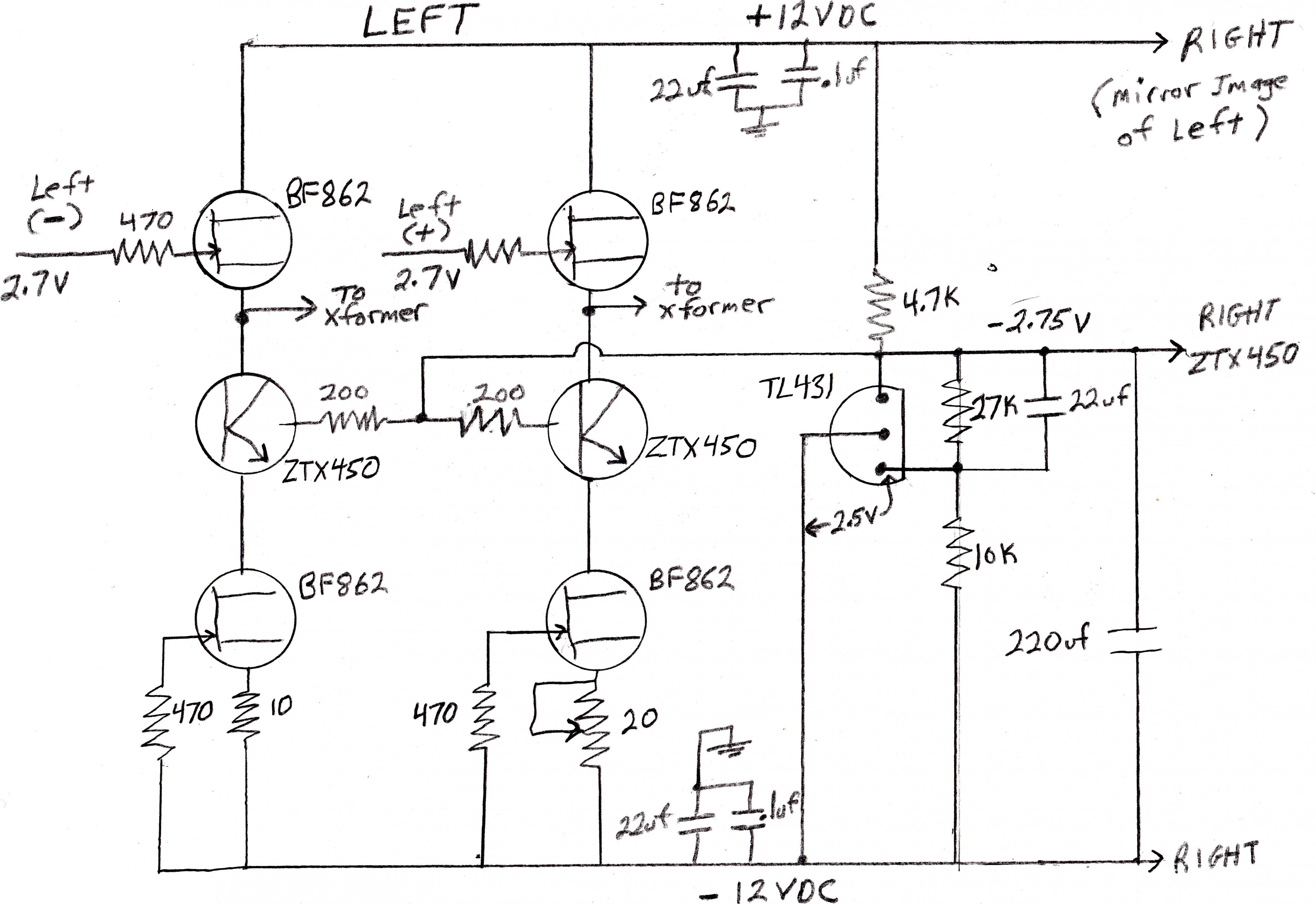

JFET Buffer Circuit
This an explanation of the Buffer Circuit from a post in the DDDAC1794 thread:
Attached are a schematic and photo of my BF862 JFET buffer. There is almost too much detail. I could hear the valves and mechanical linkage of a bassoon clacking on a Vivaldi recording through my Grado GS1000 headphones – something I have never heard before. The break-in period was UGLY at times and bad recordings are punishing. The best CDs sound amazing.
This Buffer is for the masochistic DIYer unless a PCB is designed for it. It requires testing and matching of BF862 JFETs. A negative power supply is needed. Surface mount components require more care. Nevertheless, a buffer is the only alternative for the person who wants to totally tweak out a single board DDDAC and drive an output transformer without compromising the musical experience. On the positive side, all semiconductors and resistors are inexpensive and available as SOIC-23 surface mount. The BF862 is only available as a SOIC-23. Anyone want to design a surface mount PCB for this buffer? I could provide a set of components with matched BF862s.
The circuit uses the ZTX450 which is used in the highly acclaimed Pearl 2 DIY phono preamp to provide a constant voltage source for the 1st JFET gain stage. The ZTX450 makes the lower BF862 constant current load - more constant, and allows a more standard -12VDC power supply to be used. My prototype uses a mixture of surface mount and standard size components. The TL431 regulates the voltage to the base of the ZTX450s. The 20 ohm pot is used to zero out the voltage offset between the + and – outputs to the transformers.
If the ZTX450s and the TL431 and its associated components are eliminated, you end up with the Nelson Pass B1 direct coupled buffer design which should sound a bit more warm and euphonic. It would be a much simpler circuit.

Hi! If we can find a volunteer, or someone to help us, make a pcb from this, can all the comoponents be smt? Or some are not available as smt components? I'm definitely interested in a pcb, but I don't have the knowldge to create one.

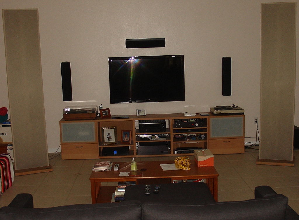

Attached is an image of the listening setup, not state of the art, but I've had it for a very long time so I'm pretty familair with the sound...🙂

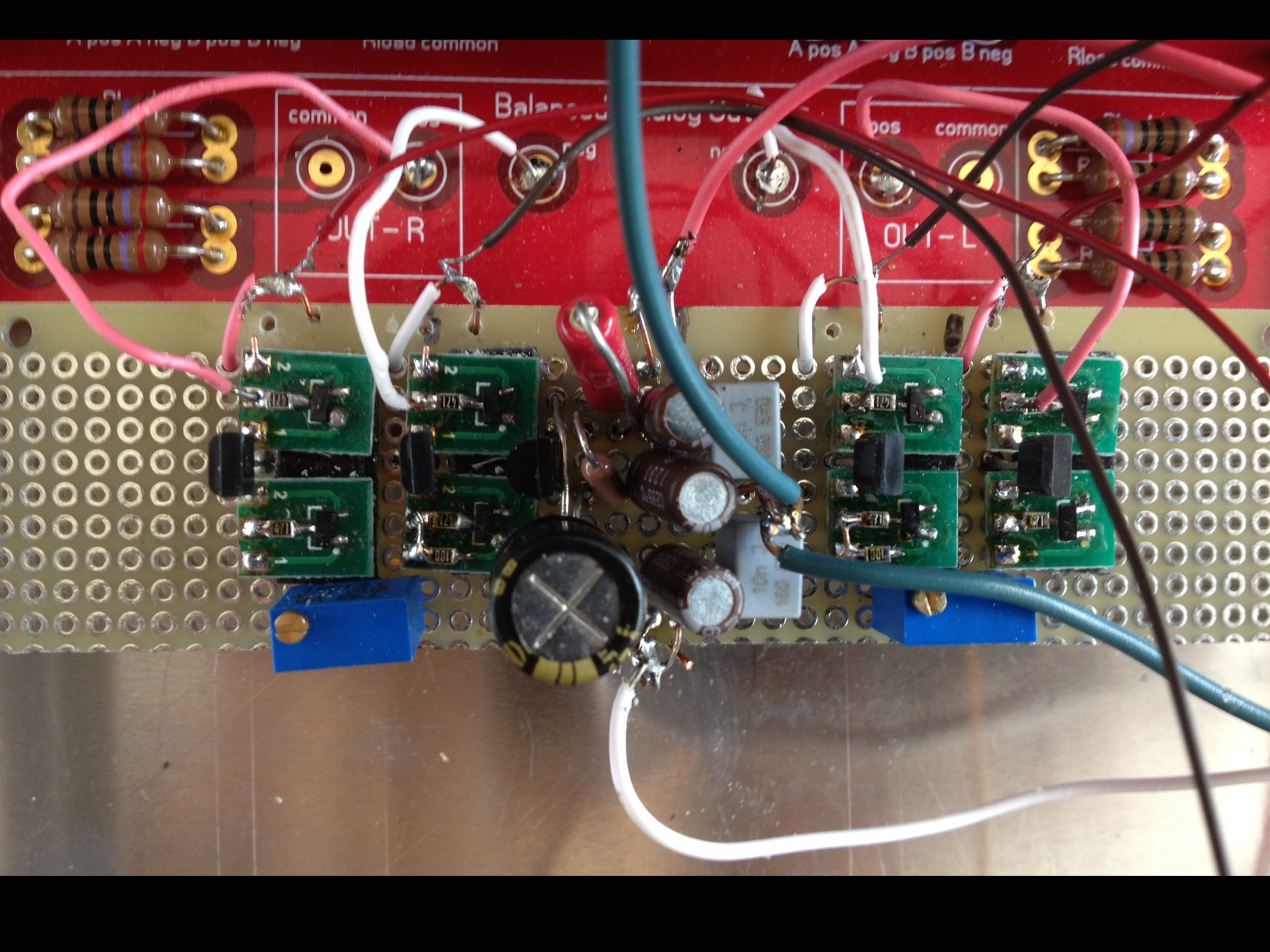

Would something like this also work before the cinemags?
I was thinking of adding this (or something similiar/better) and lowering my AudioSector amplifier's gain by replacing the 680R with 2.4k ohm tantalums to increase the usable range on my volume control.
