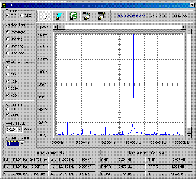

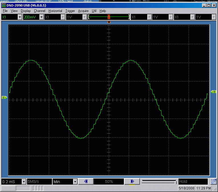

I just completed DDDAC 1543 MKII and I have a problem at the output - something is riding base harmonics, and sound is pretty shi**y. While waiting for response from Doede, thought someone might seen this before or have an idea where to look. Boards are supplied with 11V LM317 stabilized, 120VA toroid.
I am feeding it with SPDIF from SB live and CD4000. FS looks quite good on the scope. I tend to suspect TDA1543 tower.

Did some more testing. Sound from SPDIF out of Marantz CD4000 is much better. However, when I put test CD with 1kHz sine wave, I hear low freq "clicks", around 1Hz, even from CD player. I did not catch that on the scope. Same signal/CD plays clean from CD4000's analog output.
I am using the same sound card settings which I used for DiyEden SVDAC without problems. I will doublecheck them.
The signal riding sine wave is too high, around 50KHz so that is not what I heard 🙂 Not present in CD4000 DAC though, but that is probably not my problem.

To summarize, there are two issues here, with CD4000's SPDIF as a source:
1) Low frequency clicks, with any freq sine wave. If I run 15KHz for example, which will be barely audible for me, I hear clicks only. Theory that this is audible in sine waves only and not in music, is kind of ridiculous, and I am not amongst those who can hear difference between cables. If I can hear it, anybody can.
2) Parasite harmonics in audible spectrum as depicted above. They are all over the place. Simple comparison with default oversampled output of Marantz CD4000, puts DDDAC down hard in this respect.
I would very much like to hear from other owners of DDDAC MKII with SPDIF receiver.
