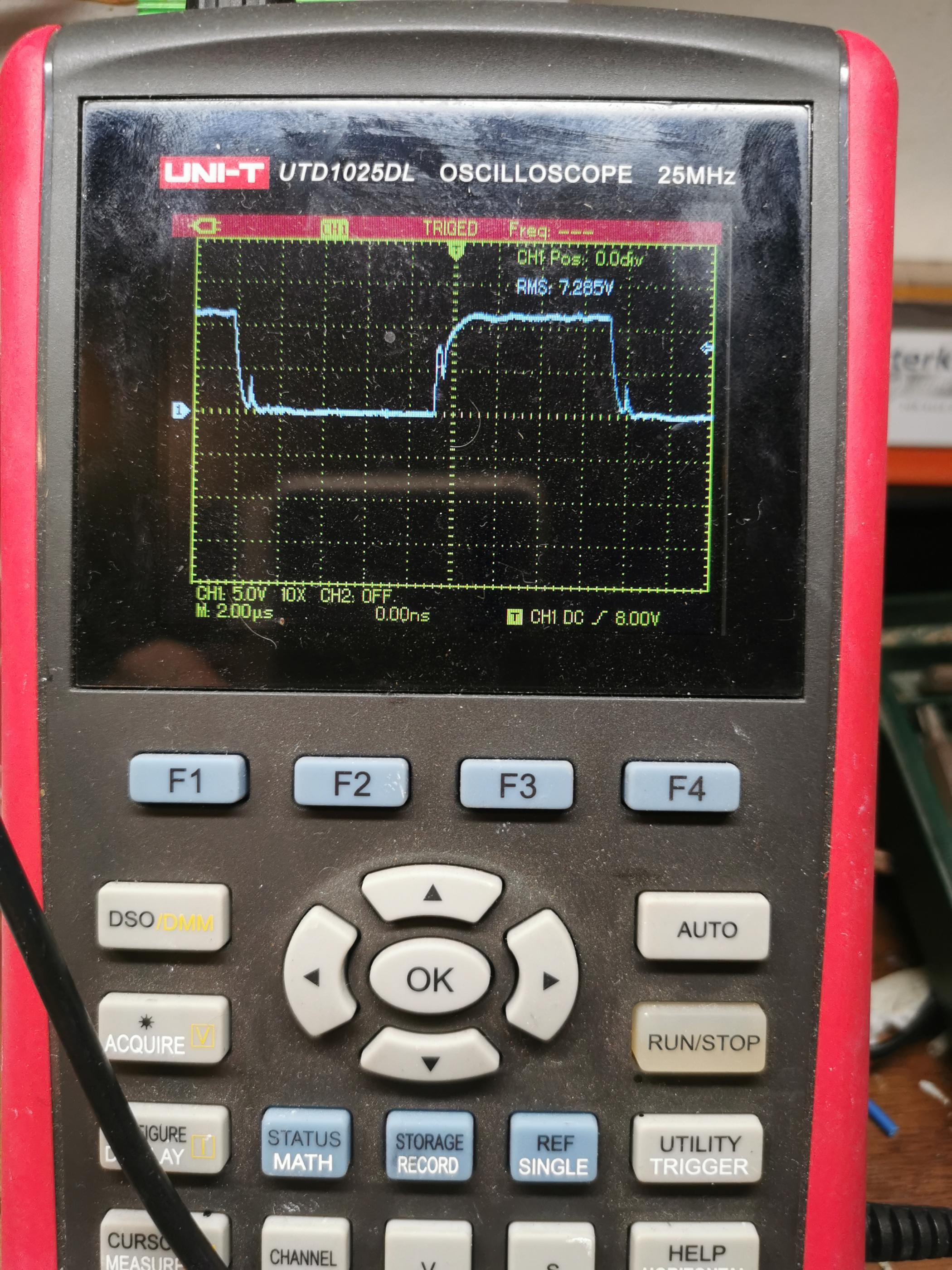

So i have this amplitude on two banks. Its the low side.. The opening voltage is interessting. The end of the amplitude is from the missing output filter. I mounted the filter back in place, then it is better. But begining of the amplitude is the same... What can cause this?
I will try with other mosfets...
Honestly, I don't understand much, are you doing low voltage procedures without inductors?
To me that waveform is pretty normal on the gate (during normal class D operation).
I usually do this (after I am sure that all my resistors are really ok) I install the driverboard I check if all the low sides are there, then with an auxiliary 12v battery (even 1A is fine) I check if they are all there too the high sides.
When I did this test, I am 95% certain that by installing only 1 fet per bank for each stage, everything will be fine (my tests are all with the battery voltage at about 11.1v and with low rail voltage, after all, if i really checked all resistors, it will work, then i switch to high rail voltage, if it still works, i increase the battery voltage).

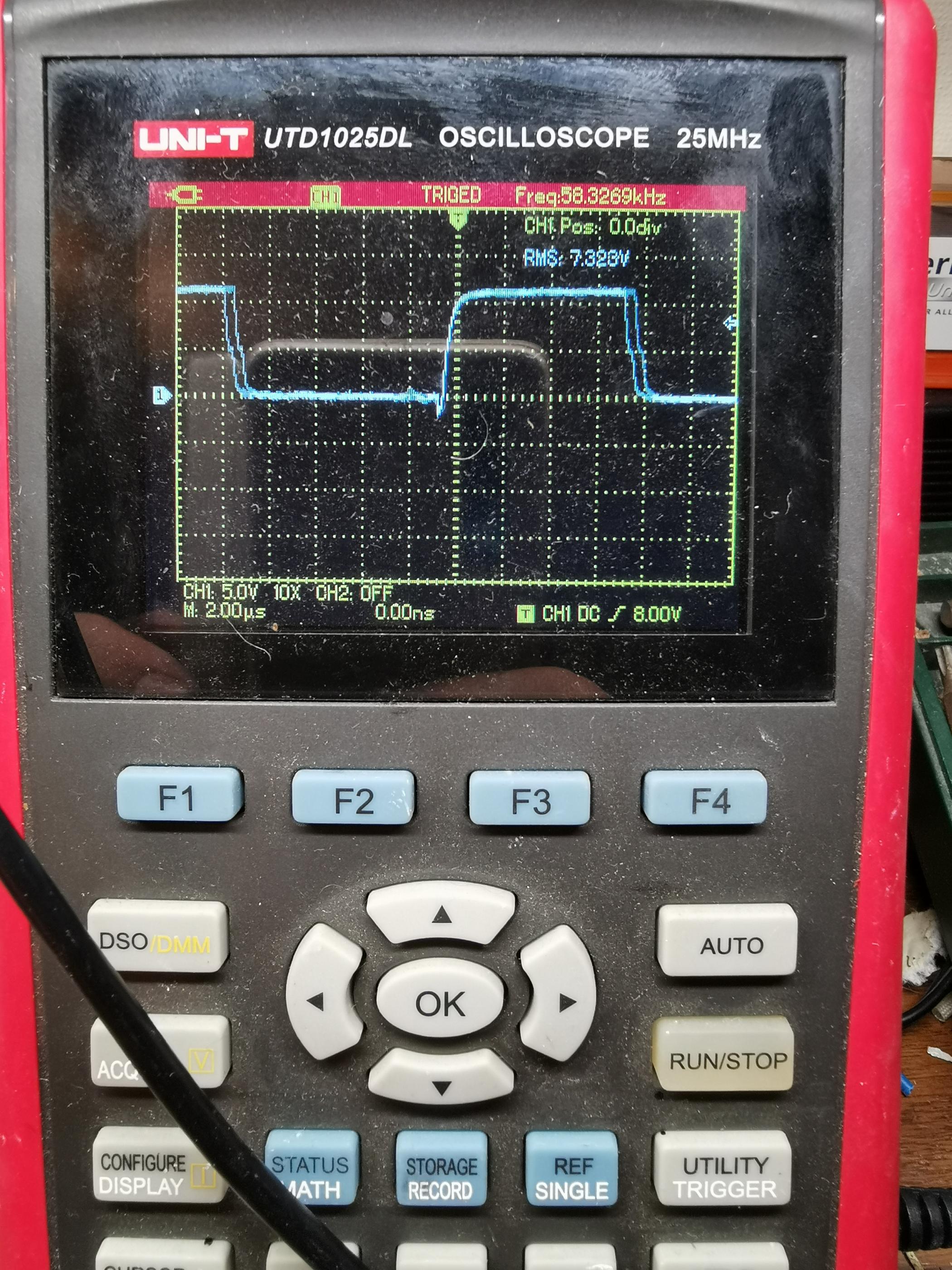

No, on this amp i work with a low voltage supply at the rail, because this amp has some tricky problems. The Amplitude at this bank is not ok, because the fet gets hot. If i check the amplitude on another bank, the signal is straight, without any interuption.. The gate resistors and pulldown resistors are new, and checked three times.. I dont know, what can cause this.. I will add a picture from the other bank.
Very strange!
Which mosfets are you using? It seems that IRS21844 struggles to drive that mosfet, are all the same mosfets you are using right now? are they all good? If you are using IRFP064N, try using the mosfets you would definitely use (something like IRFP360LC or FDA24N40 or IRFP460LC or FDA24N50 or FQA24N50).

There are all IRFP360LC inside.. I will remove them, and try with a cap at gate and source.. If it's OK with the cap, I will use other fets.. The 360lc are original inside. But I don't know from where they come.
So, it seems, that i kept an old set of mosfets, maybe from China.. Those 360LC are ok,, but they cant be driven in a good way.. I used now FDA24N40f, from where i know, that they came from mouser... Now everything is ok, drive perfect, each mosfet stay cold..
I think i will use the 24N40 in this amp,they have the same paramter, and a little less gate charge.
