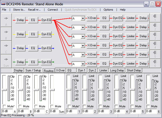

I downloaded DCX2496 remote editor software V1.16a to check it out before buying the unit. The software seems functional but its window is only partially visible with no way to expand it or get to scrolling controls. Does anyone know if it only works if the pc can first comunicate to the unit? DL it twice and tried on multiple puters.
looks like this:
sorry mod about multiple posts; browser was just hanging on my end. Computer fun day at the ranch!
looks like this:
Thanks VT67. I can now see what I'm missing, which is crucial. If I can't get the software to run right the unit would be worth much less to me.

Thanks all. Behringer tech recommended some things that worked. I had to change both- Fonts to medium from large, and dpi from Large to Normal. Unfortunately on my XP pro machines' (4 years and a half year old) LCD panels, which are designed to work at a high native resolution, this makes everything else on the computer too small to be useful. The behringer software gui is terribly dinosaur like in this respect. a shame because it renders a good tool useless to me. Oh well.
FWIW I dl BBE's software for their DS series and it works excellently.

Hi, I'm resurrecting this thread, because I'm annoyed and frustrated.
On my Win 7 64 bit machine the software window is mucked up, some of the important UI elements are out of frame. Tried mostly everything (changed font and menu sizes, scaling (unobscured x-over Link checkbox and frequency labels, obscured gain settings), changing window theme to classic, changing screen resolution, running compatibility modes, changing GPU scaling options), nothing helps. At the same time, on my Win 10 tablet the UI is OK. Has anyone figured out what's going on here? Are there any solutions, or even 3rd party software somewhere out there? My google-fu fails me this time 🙁
