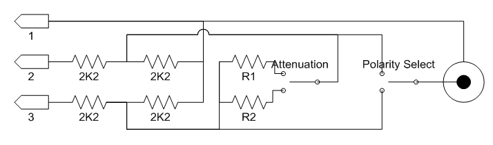

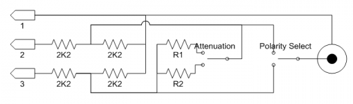

I made a simple rca to XLR cable by bridging pins 1 and 3 per the Behringer manual (p20).
While general practice in Pro-Audio this is a terrible idea.
It actually makes one of the two halves of the output op-amp work into a very low load (60 Ohm) which causes it to thermally modulate the common die with signal and to modulate the common supply.
As you also need around 20db attenuation to interface the DCX to consumer standard Amp's, here is my suggestion for a "Balanced/SE" attenuating converter that does not cause the above problems and does not require a transformer (which is the other possibility - a 4:1 stepdown studio grade line transformer with +22dbu level handeling is ideal):
Make a box with XLR "Tails" and RCA Output Cables or Sockets (depending on taste)
Each RCA output pair receives two toggle-switches, one changeover and the other center neutral. These will become switches to select between the two polarities and -18/-12/-24db attenuation.
From pin2 & pin3 connect a pair each of 2K2 (1% or better) resistors in series to pin1 (ground).
The join between the two resistors for each polarity is connected to one of the two poles of the polarity selector. Thus at the flick of a switch the polarity of any given way can be inverted.
Further the "center neutral" switch connects a 2K2 resistor (-18db) or a 750R resistor (-24db) between the two junktions of the 2K2 pairs.
Now each output Op-Amp sees a sensible load of > 2K2 each and the load is reasonably well balanced (as long as Z-Load > 10K), you can simply resolve any polarity issues (be they in different makers Amp's, drivers etc.) at the flick of a switch and your full-scale levels are now:
-12db = 2.5V RMS
-18db = 1.25V RMS
-24db = 0.625V RMS
The same thing makes a neato passive "Pro -> Consumer" interface converter in dual channels. Switch and resistor quality matter, so don't skimp too much.

I have tried to get this description down on paper, but I dont get it!:scratch: Could anybody please help me draw the circuit.
DVC Keld

I ended up building Kuei's interface unit which has worked well although I opted to not include the polarity selector.
At the time I didn't have any 750Rs on hand and other things to do so I just lived with it in -18dB mode.
But I finally got tired of the hiss and tried 540R (maybe it was 560R) to quiet things further but still not enough with 100dB/W drivers.
I want to try smaller values for more attenuation but I don't really understand how to determine the attenuation by the resistor value nor how low I can go in value.
Can anyone shed some light on this?
Thanks.
You can safely go down to a dead short.
Why not get a 1K adjustable resistorfor testing and turn it as low as you need?
Apart from that, if you look, the attenuation progresses in appx 6db steps with each step halving the value (to nearest preferred value), so halve the 750R to 390R for around 24db attenuation.
