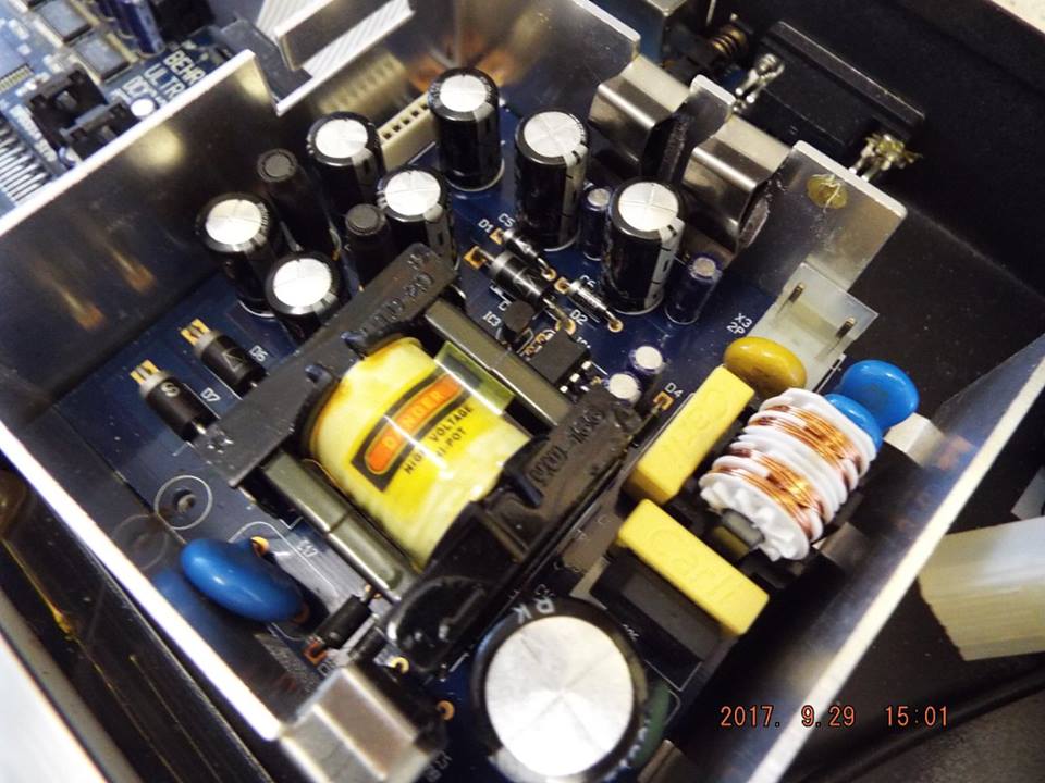

Be very careful with the DCX PSU caps. Some of the caps have rectified mains voltage across them and they have exposed live metal surfaces. The application of a little insulating tape can save a lot of pain!
I have noticed with nearly a lot of audio electronics some are just so ridiculously HOT, you'd think these Japanese guys would have found a way to make them cooler today. 🙂

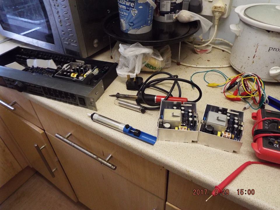

The PSU can be fully removed from the item its just mains in lead that can be unplugged and the transformed converted power to the rest of the unit that can be uncoupled, but lots of capacitors on the tiny (PSU) power supply unit. What ones would need changing out with better ones as Behrinher must be fully aware of some field report feedback's of failures by now.

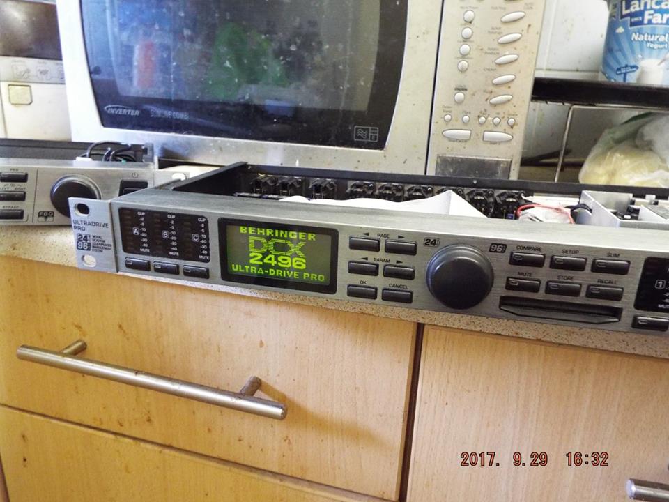

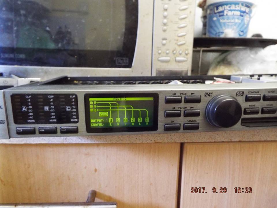

I changed the psu caps and now dcx2496 is alive and well (so am i). Thanks everybody.
Do you have pictures of your DCX 2496 that shows what you specifically changed.
Back in September 2017 last year got two replacement PSU for DCX and used the other spare to get the FBQ2496 powered back up again.
