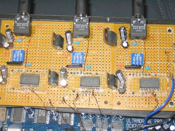

Hi all
I made SPDIF transmitter board for DCX2496.
It is easy and you can get 3Way digital X-over device at very cheep price.
(1) The signal you need
from AK4393, get these signal with very slender cable, solder with microscope or something.
Pin 3:MCLK?APin 5:BICK?APin 7:LRCK
These signals are common for all AK4393.
Pin 6:SDATA , on the side of AK4393, you can find 10ohm R,
you can get 3 SDATAs from this register's solder easily.
(2)CS8404 configure
PRO=Low, TRNP=Low, M2M1M0=100, I2S mode.
Pullup RST with 10kohm.
(3)CS8404 connection
?@MCLK->MCK, BICK->SCK, LRCK->FSYNC, SDATA->SDATA
(4)SPDIF output is done by TOTX173
(5)5V power is made by 7505, on each CS8404, 9V is supplied from Pin 1 of 7805 on the main PCB. GND is supplied from Capaciter's solder. (maybe direct from power module is better)
Then now you can get 3 SPDIF signal, for DCX2496's ch12, 34, 56.
Do not forget to make DCX2496's configuration to LL-MM-HH.?@

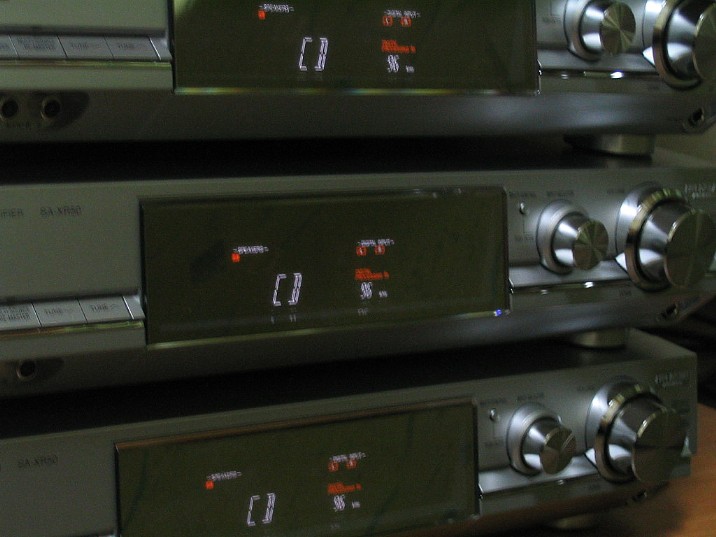

Now I'm using this for connection to 3 units Panasonic SA-XR50(maybe same as SA-XR45 or so).
Tanto

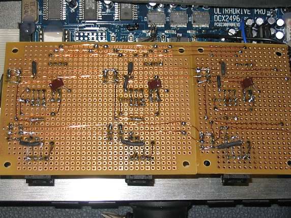

Tanto, have you done this kind of thing before with solid-core wire? I have experienced reliability problems in the past, the wire is too stiff and tends to pull off the SMD pads at some indeterminate point in the future. Frustrating. I use small-gauge stranded now.

(2) Why don't mod for XR50? with equibit's 3 digital in?
May be I will want to use another full-digital amplifier,
so 3x SPDIF is more generic way.
and I think now I have 3 time more strong power unit than 1 unit

take care to make the board thin and small, or you can't store it inside of DCX2496.

Can you post the rear view of your DCX2496 with the board in it?

You only need a small tip. I prefer something like this:
http://www.mpja.com/productview.asp?product=15151+TL
The long thin conical tips seem to lose heat and the nickel coating too quickly, these work much better in my opinion.
Also, I like to use stranded small gauge wire for this kind of work. I have seen a lot of failures after 6-12 months from magnet wire putting stress on the joint. YMMV, it depends how much vibration/shock the unit is subject to.
