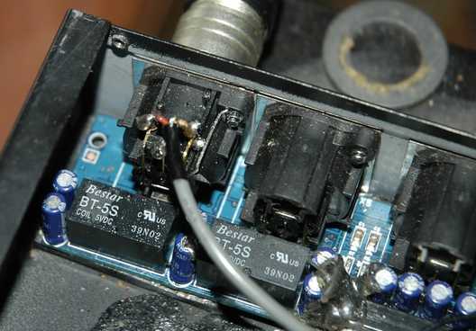

Or the opposite :If you are sure to never use the analog input A & B (but you can keep C), you can by-pass all the stuff with a cable going directly to the input SPDIF transformer. Here the XLR is upside down and traces cut.
