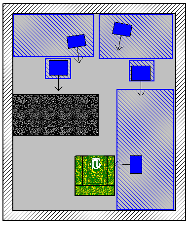

Just FWIW, CARA suggests that you move the subs away from the walls. Below is were CARA wants to put them, given the limits of the blue hashed areas I assigned. All 3 were also restricted to the floor, no elevation. Geddes recommends one elevated, IIRC.
The placement shown results in a very smooth response up to ~150Hz. Quite smooth, really. I put the crossover from sub to mains at 50Hz, as that looks reasonable for your rig. You have a major node at 80-90Hz, that's going to be hard to avoid.
Ok Pano, this is a very different approach of my sw locations.
Yes, I will stay with the initial placement of the SW...
sub1 - back wall behind the mais - corner
sub2 - at 1/3 of the back wall behind the mains
sub3 - at 1/3 of the right side wall
