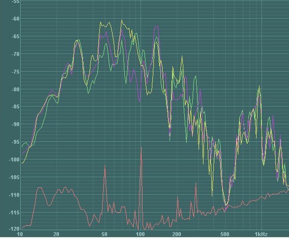

What you have to ask yourself with the very narrow filters is if they are worth the effort - move your head left or right a few inches and the response changes. If your going to do this properly you need to measure with an rta at all listening positions and then decide where to eq.
For example theres an un eq'd plot of my labhorns here :
If I boost the 80Hz - 100Hz null on the purple line then the yellow and green lines would have huge boost at those frequencies. The purple line is in the middle seat of a 3 seater couch, the yellow and green are the seats either side.
Rob.
