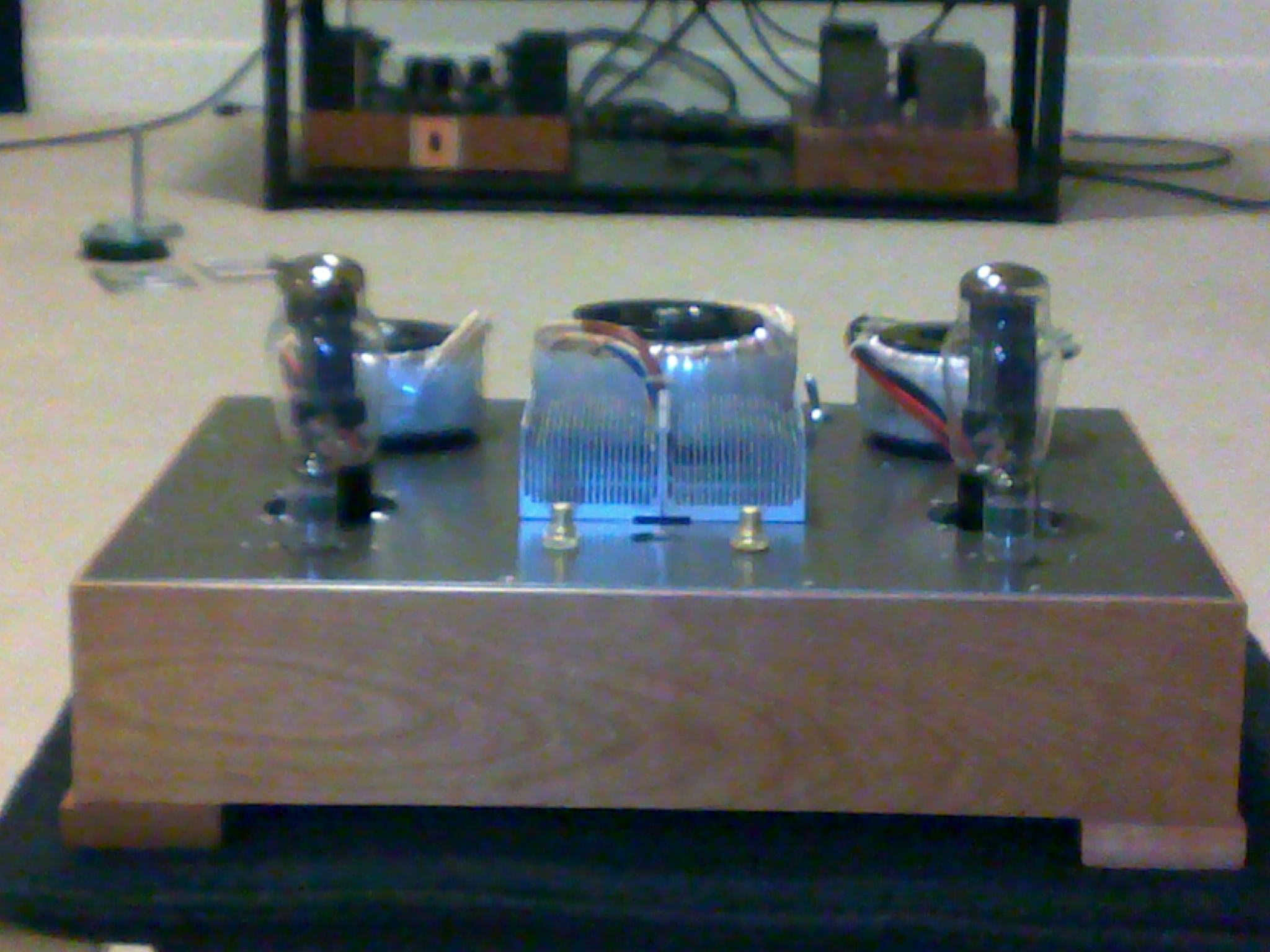

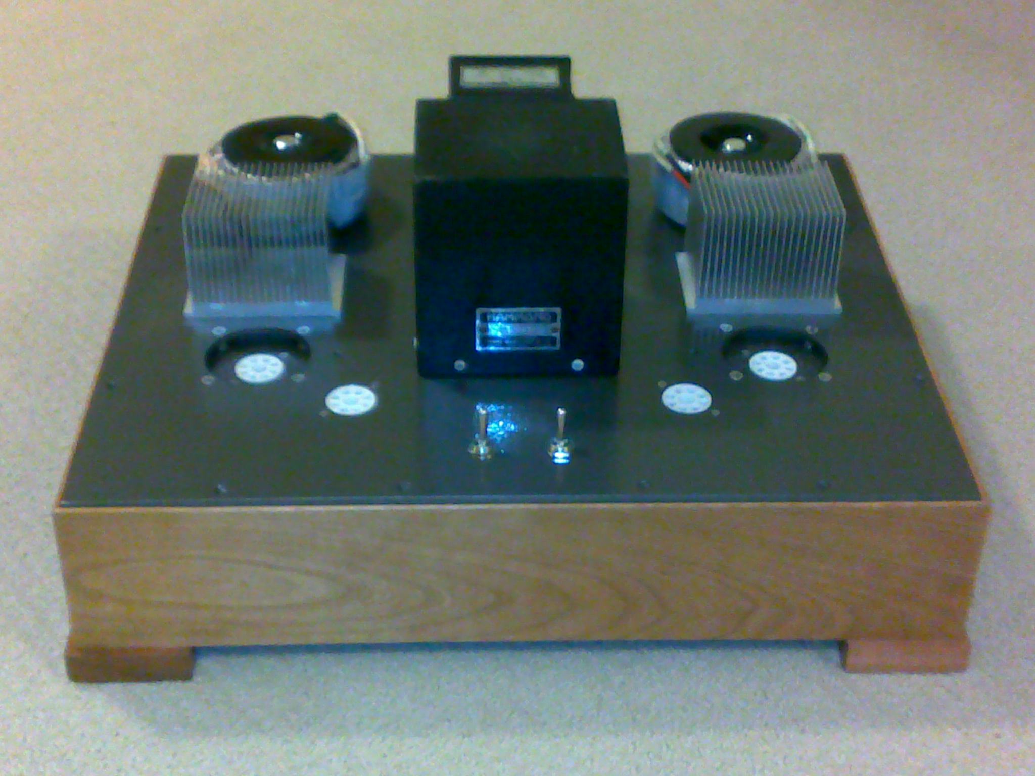

Steve,
Attached is the 'MK l' I completed couple years back and this is the one that some of my friend didn't want to give me back for quite a while. I end up finished one exactly the same for one of them and now I'm going to discard this 'Mk l' into a 'Mk ll'. Output transformers will keep the same, but the PTXs will be 2 other transformers which I won from the auction lately from feebay. Will post a new amp in about a week, just how it's look and will start after that, for I'm still waiting for some parts to come.
I'm considering to cascode the DN2540 for the driver, but still struggling on how big the resistor to control the current 16mA. My intention is to put a fix 47 ohm 1/2 w to series a 50 ohm 1/2 trimmer so to tightly adjust the plate to 0. Is that numbers are on the ballpark.
For the output connection, I had my last one hooked up 115-0-115 as primary and parallel 2x 9v as secondary/output. As of Mk ll schematic, you said 220v/10v for 4 ohm and 18v for 8 ohm. Do I have to series the secondary to 18v for the Mk ll / or just keep the same ??
BR
Albert
