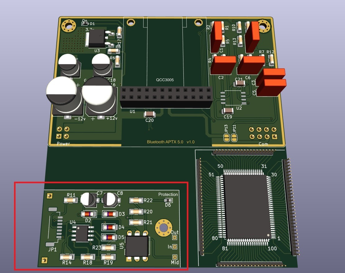

Hello all,
I know that is it surely a common title of topic, but I'm working on my new amplifier, and I want to add a DC protection on the output.
I want to manage the output relay with an ESP32 (all function are managed by him). So, "out" will be link to the ESP32.
I seen a schematic from Elektor (July 2012, page 62) interesting, and I simulated on Spice :
All seems work fine, but I want to ask to the diyaudio Engineer here for know if something seems wrong or not 🙂
Thx in advance !
hello,
@ctrlx, delay yes, it is managed by the MCU, all protection and others are controlled before the relay activating. Output will be triggered by relays, I'm not familiarised with FETs...
@mark, you right, I omitted the R for the simulation (opto), but she is in place on the Kicad project 🙂
Concerning R7, the 15v PSU will be devlivered by 7815-7915, and 1% resistor will be used. I think that if the window detection will move for some millivolts, it will be not a very big problem
Today I created a small PCB that I sent to JLCPCB, I will make all tests with it after receiving.

Seems a bit inspired by Rube Goldberg. But this is DIYA so it's not about efficiency. I would not put a crash-able uP in charge of anything critical. Using a uP to monitor and display status is a good idea. I would also use the uP to mute and/or set the amp gain, etc. The uPC1237 is easily replaced by a handful of penny transistors which have no availability issues.
http://www.unisonic.com.tw/datasheet/UPC1237.pdf
UPC is really difficult to find in original case.
I already tried a project with transistors, but the result was not really good :/

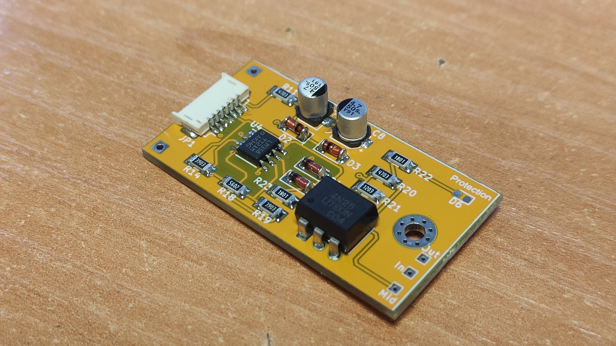

Below the photo of my new project based on the schematic above. I made some tests with DC input and all work like a charm. I just have to test now with very low frequency ( under 20 / 15hz).

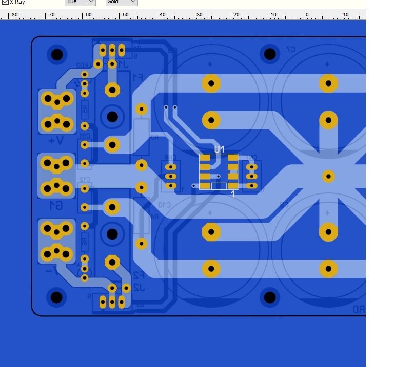

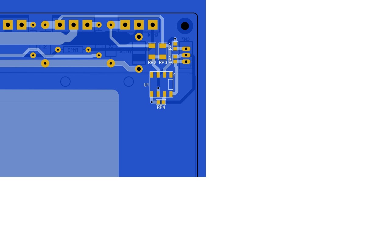

I'm integrating protection into my "Slewmaster" line of IPS/OPS projects.
- KEEP IT SIMPLE !!
Output stage , power supply, relay, soft-start will have large footprint SMD opto's as optional
They can still run without the MCU interface.
No one will build a small footprint digital control board. If it is a mixed TH/SMD (large SMD) ... maybe ??
Easier to just use a existing China Arduino NANO clone ($4 pre-built module) , has the regulator/uart included with arduino bootloader.
No fuss , just load and plug it onto through-hole SIP's. I2C port expander for "slow" triggers (thermal). NANO is used
for fast stuff (DC,current). Very little SMD work ....through-hole or the large SOT-xxx.
DC can just be 4 transistors ,cap , diodes, and opto - added to the SS relay PCB.
The SS relay (with DC detect) PCB should run independently without the control board needed - speakers are expensive.
