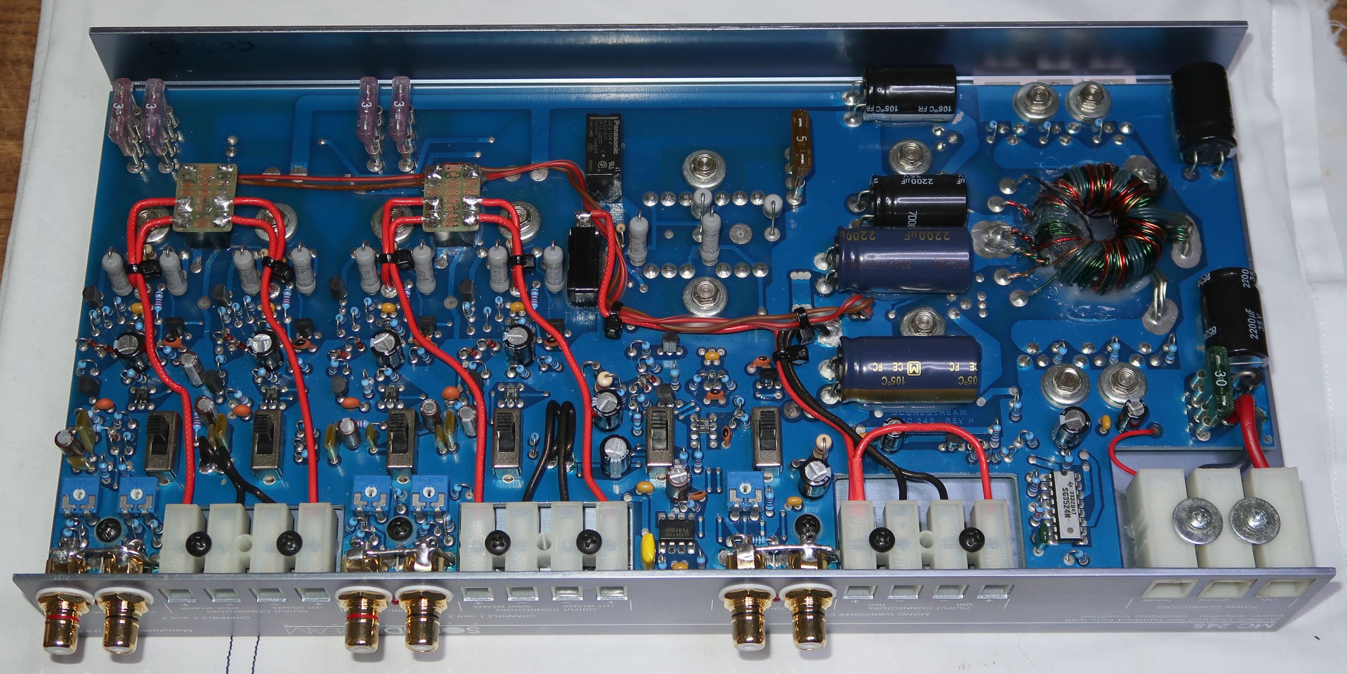

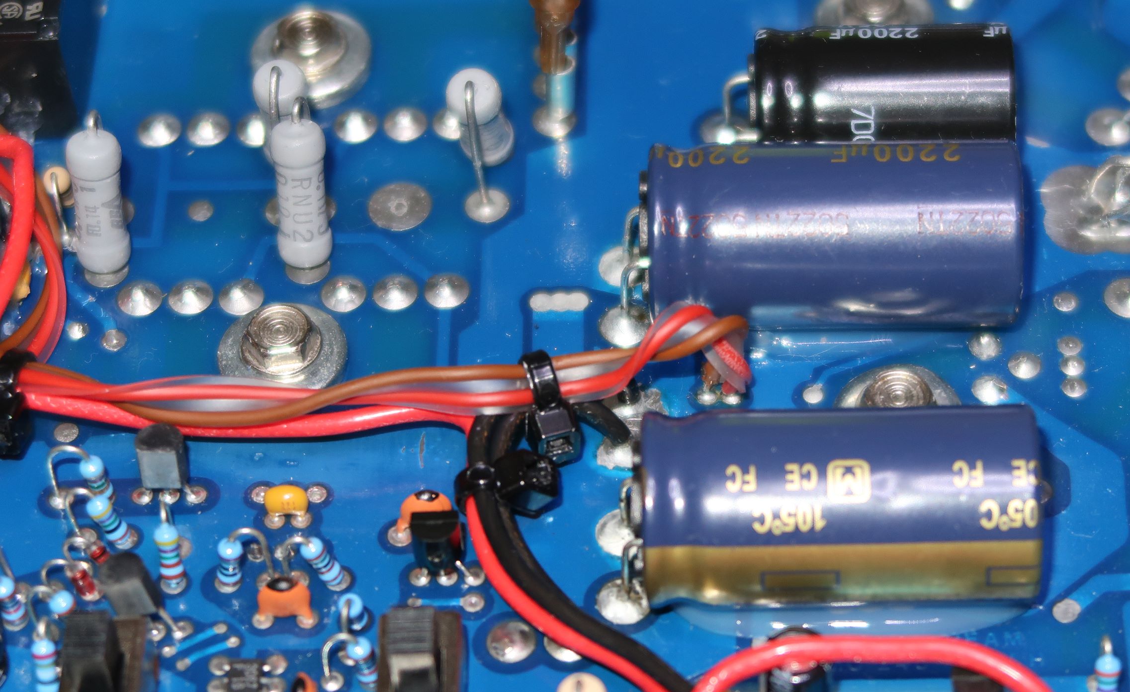

Just in case anyone out there in the future wants to do something about the turn on/off click/thump on the four main channels of their MC245.
I have done a small modification to mine and post the info here.
I do not know if this is how SS did it.
But it seems the simplest most logical way to me.
Plus it works 😀
I used silicone to mount 2x G6B-2214P-US DC12 Omron Relays (Digi-Key: Z759-ND)
I chose this relay primarily due to their low current draw which should pose no issue for the factory relay drive circuit.
The small bit of veroboard on each relay is to give a larger solder pad and support the weight of the wires and stop the risk of breaking the relay pins.
I put a piece of gaffa tape on the inside of the lid just for extra insurance against shorts in case a relay comes loose.
The power for these two extra relays is taken from the original relay drive circuit.
During my update I re-caped the amp with a mix of elna silmic II, panasonic FC and FR.
Replaced the (old corroded) rca connectors with Chinese CMC clones.
I had to open the rca holes 1mm for them to fit.
Finally I replaced the thermal pads with Keratherm reds from the diyaudio store here 🙂
