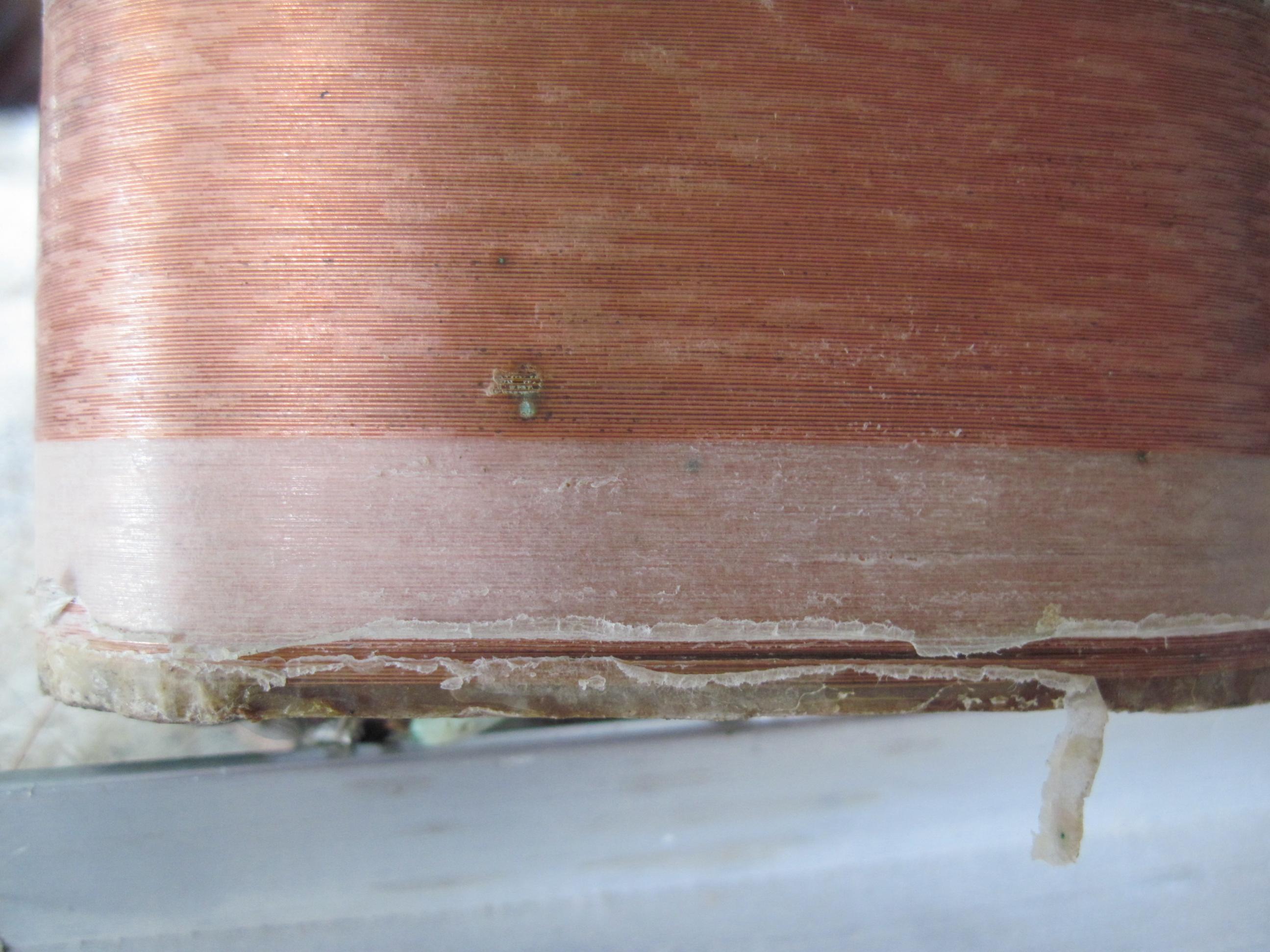

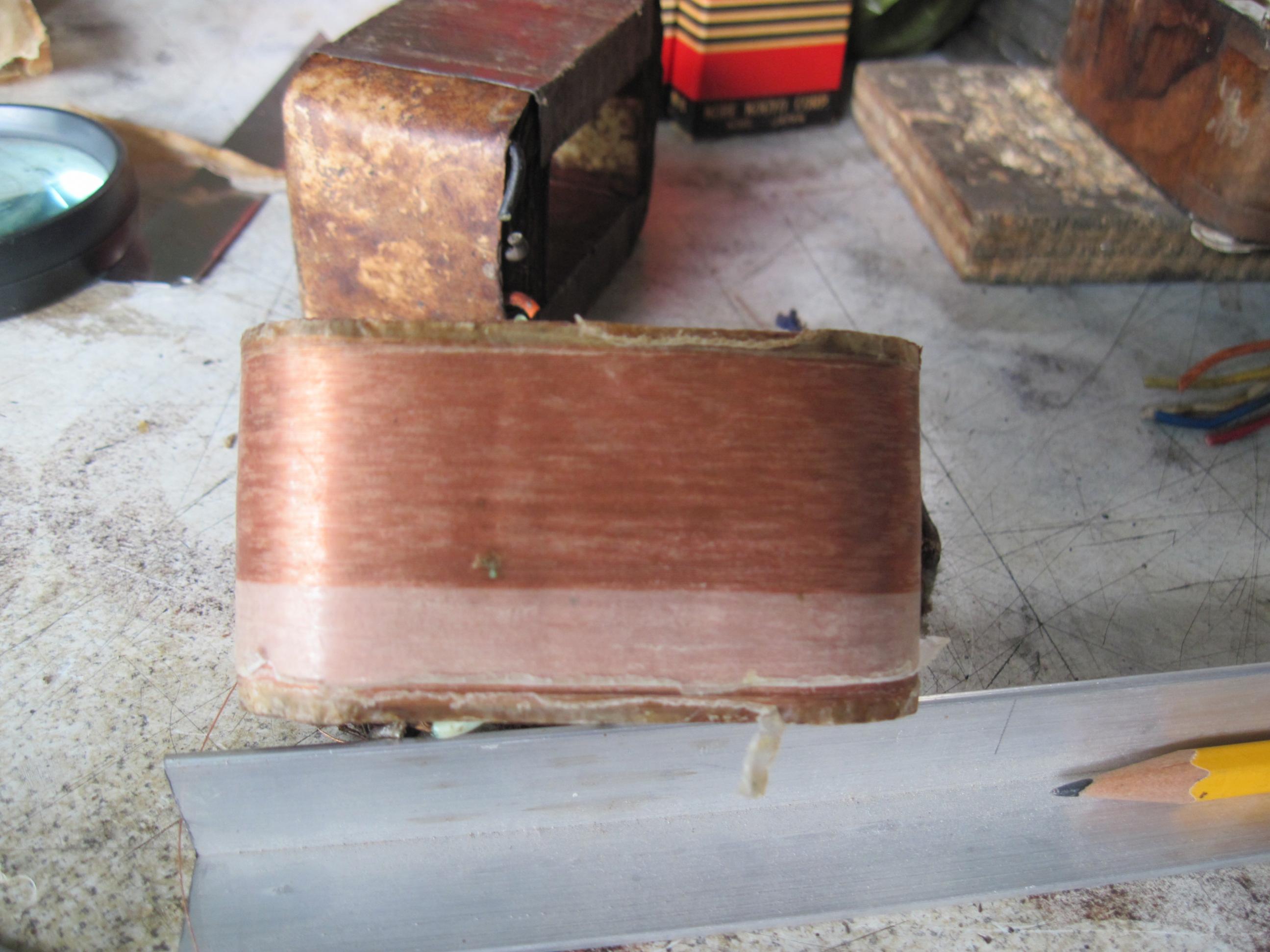

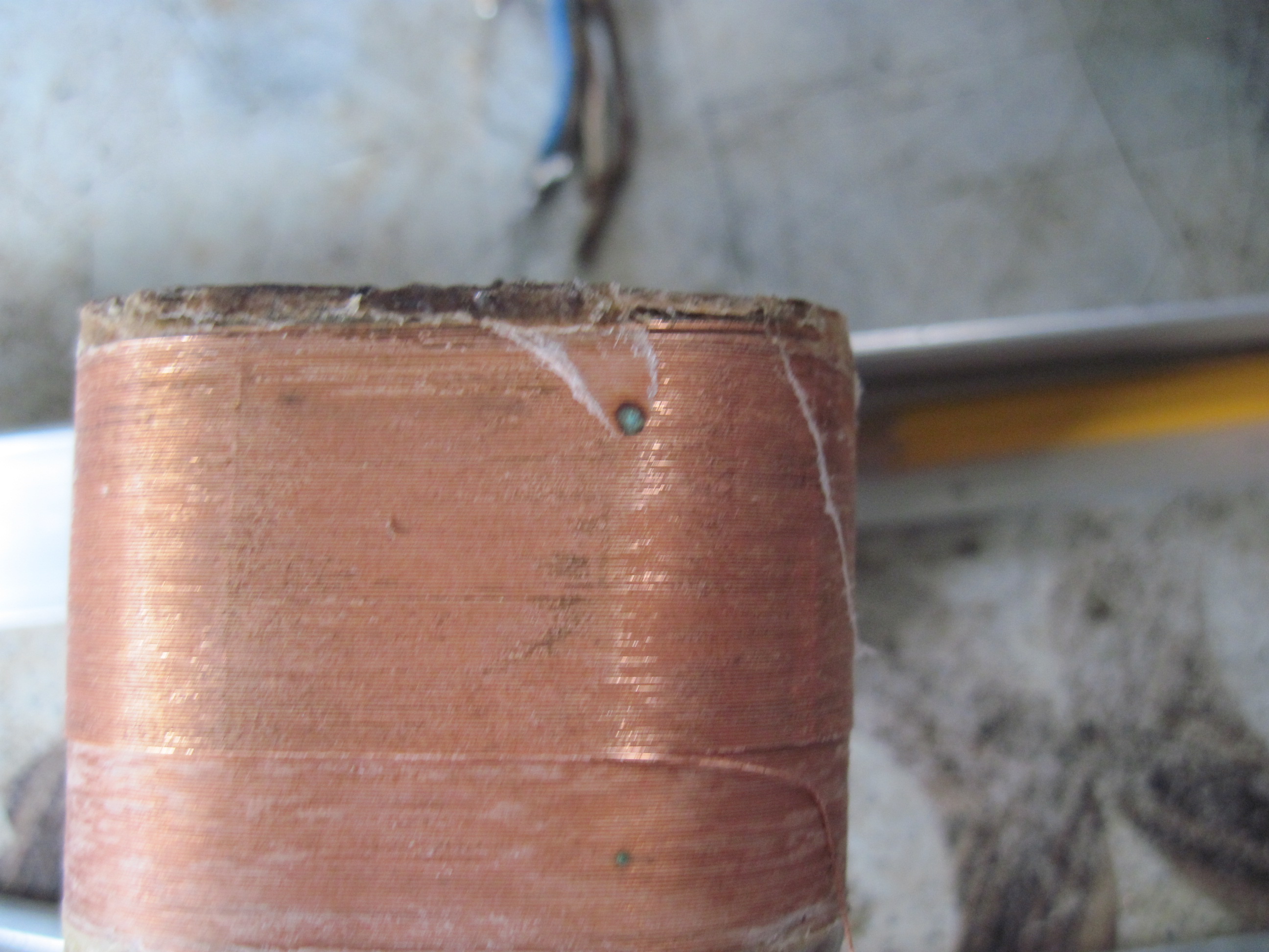

After hours of usage with the secondary grounded, the amp finally blew a fuse and the primary now has shorted to secondary causing a severe load. Before blown fuse, I noticed the high frequency was rolled off. Essentially the output transformer is a faulty unit.

Failure of the insulation most likely.

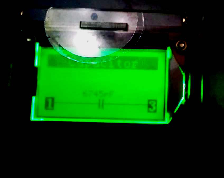

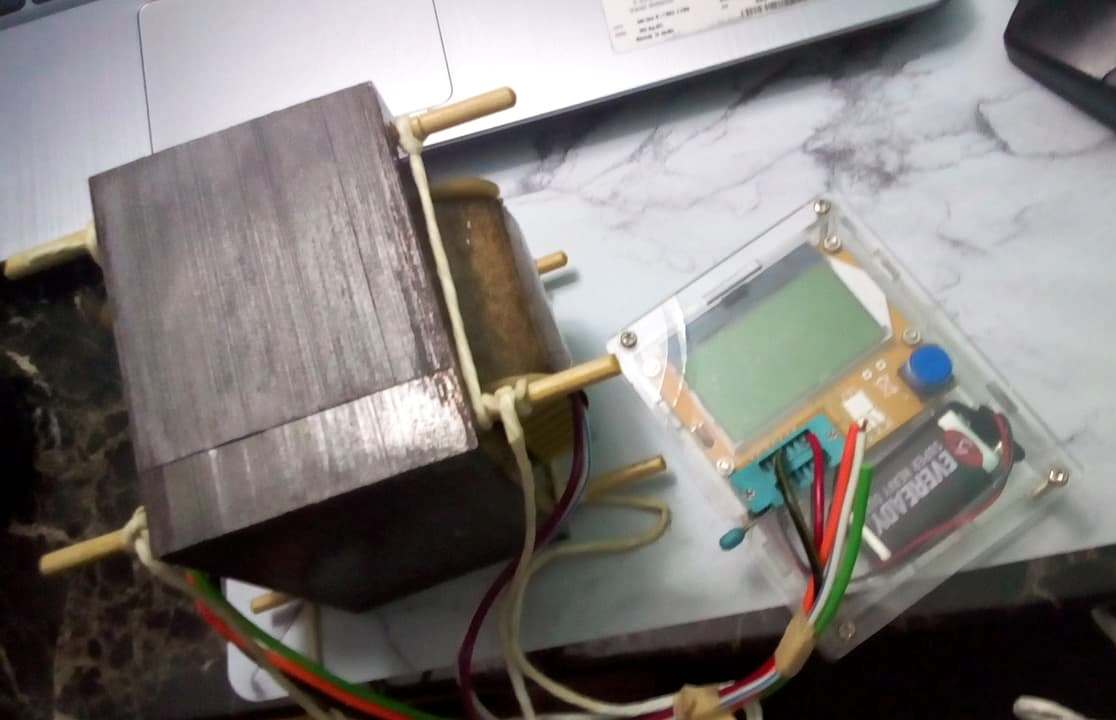

There is also capacitance between primary and secondary windings.
this is a 25 watt 5k/8 ohm SE OPT i made...
capacitance between primary and secondary is 6747pf...
> 5k/8 ohm SE OPT i made... capacitance between primary and secondary is 6747pf...
5kHz bandwidth ???
(Even assuming only half loads the high-side of the primary, that's not extended range.)
5kHz bandwidth ???
interesting, but since tr is blown on many spots i think the insulation was not done properly.
like vaccuum impregnating
