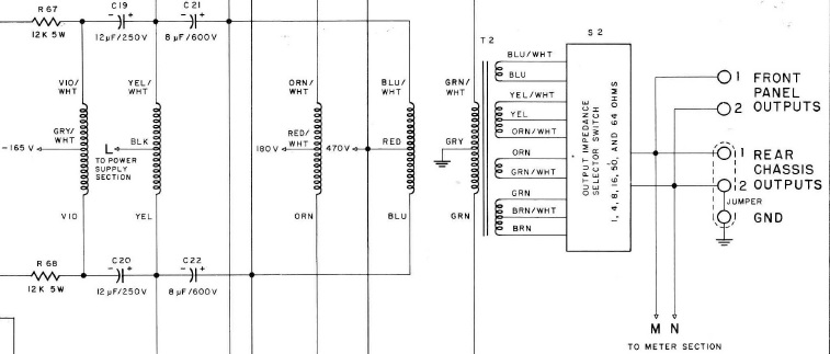

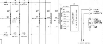

You say there's no grounding with the MC3500?
Here's the schematic of the OPT....... hmmmm.

Here's the schematic.

It would be interesting to see the original WE schematic of the amp at issue.

That wasn't the full schematic. The termination details are on a different drawing.
The whole shebang.
