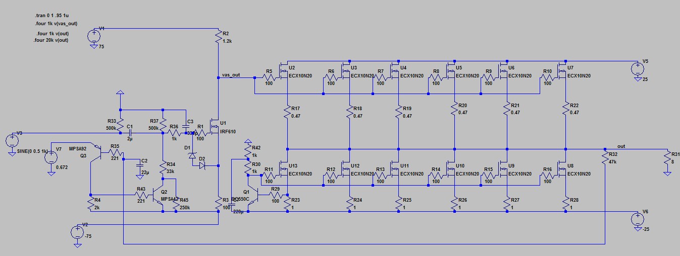

Hi All,
I am trying to design a simple, no feedback direct coupled (except for the input) Class A amplifier (please see the attached schematic). Some of you will like the design, some won't. It's not intended to be clever or original in any way, merely a tailored design to produce a sound I think I'll like. It uses a brute force approach to audio and very old principles - A HV 60mA single ended input stage which will easily drive those lateral output fets, in turn chosen because I can almost get by with no part matching. Anyway, I digress.
As you will see I have made a rather basic discreet DC servo. It works well for this purpose. The one problem I am having us that it is not totally benign and is acting as a feedback path, though not as much as you might think.
This may not surprise some of you, nor myself. I know it is not as nice as an opamp based circuit.
Anyway, what I would like to know is:
1) Given that I have no problem with an amplifier having up 100mV of offset, do I need a servo at all? Would a simple precision voltage reference bias for the front fet suffice? (I know, I should have 0mV, but I honestly don't care about the affect of 100mV of DC on a hundred watt speaker).
2) Any ideas on how to make the servo more benign? A larger filter cap does only so much. I have tried giving the servo a heap of "miller" style capacitance to try to numb its HF response. It's a nice theory, but the whole circuit ends up becoming a VLF oscillator. I have also tried filtering the input to the servo with a CRC filter and also the base drive of Q2 , both mods also turned the amp into a VLF oscillator.
Anyway, I look forward to your thoughts.
Greg.

I have simulated this circuit extensively and I know very well that it is creating feedback at all audio frequencies.
What I am asking for is a way of improving it. Any ideas how I might make it more benign?
Hi Greg
I like John Curl's approach to servos, which is to firstly get the DC offset as low as possible without the servo, so that when the servo is connected it has very little work to do. Then the servo can be very loosely coupled to the main circuit, to minimize the feedback in the audible range.
In your circuit you have two gain stages in the feedback loop (Q3 and Q2) and neither of them have degeneration, so loop gain is high and the feedback signal is also unnecessarily distorted.
I'd recommend adding emitter resistors to both to reduce the gain and improve linearity. There's a bit of detail missing in your schematic near Q3. That 0.672V voltage source looks like you might be using a long tailed pair?
Another thing I'd be a little uncomfortable with is the tight coupling between Q2's collector and the input. Three things to note about that:
a) Almost the entire input signal voltage is on Q2's collector.
b) That puts a nonlinear load on the input signal. (OK, it's a small effect but if we can avoid it, why not?)
c) The servo's control range is far greater than needed. If it weren't for the zeners, it could set U1's Vgs anywhere from 0V to 25V.
So anyway, I'd try to decouple that. If I come up with any bright ideas, I'll post them later. (I already came up with a couple of dumb ideas - you know the ones where you get half way through working out the details before realizing it's a complete ****-up because you forgot something important)
Cheers - Godfrey

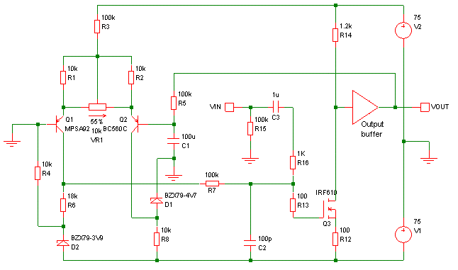

Hi Greg
Here's a slight reworking of your servo. With the values shown, frequency response rolls off below 1.5Hz due to the input cap, and again at 0.5Hz due to the servo. Looking at it the other way around, the feedback factor reaches unity at 0.5Hz, is -40dB at 10Hz, and -60dB at 30Hz. In theory.
The high supply voltage makes choosing Q1 a bit difficult. MPSA92 has lousy current gain. BC556 is probably OK, but close to it's max voltage. Maybe BC560C plus cascode would be better?
The trimpot should allow very accurate trimming of DC offset. If it fails open circuit, the two resistors across it get the voltage there close enough that the servo can still sort out the bias fairly accurately.
If you're not too fussed about accuracy, you could leave out the trimmer, R8 and R9, and just use one zener of about 7.5V.
One thing I'm not totally comfortable with is the 100uF electrolytic cap. Hopefully leakage and ESR won't be too much of a problem. The nice thing about opamp based servos is you can use plastic film caps.
Cheers - Godfrey
p.s. Sorry for any typos. Tired, need to sleep now.

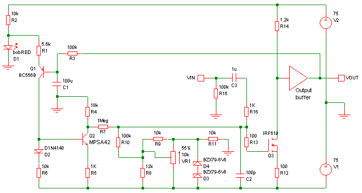

On second thoughts, the servos shown above will misbehave badly because they can't cope with low supply voltages. It's probably a better idea to use something like the circuit below, which works OK over a wide range of supply voltages, down to about +-5V or so.
One possible improvement: Ideally the voltage across zener D2 should be matched to the Vgs of the MOSFET, so it might be better to replace the zener with a trimmable Vbe multiplier. If you do that, you probably don't want or need the other trimmer.
p.s. Note the klutzy transistor choices in the LTP. 😀

Thanks for putting all the time in Godfrey!
I like what you've done, essentially turning the input low pass filter into an even lower pass filter for the servo by using a super high resistance. I toyed with that idea but I got nervous about having such a high impedance bias network. Not sure why that bothered me, guess I've just never seen it done! Completely makes sense though.
Very good!
My only question is the purpose of D2 in your first schematic. Is that to ensure Q2 is on at turn on?
Can I ask if you have tried the circuit in a turn on situation with an input signal applied? I came up with a few interesting servo ideas that worked well until I did a 0v startup with a 1kHz 1Vp-p input signal i.e. the effect of turning on the amp when the preamp is already attached with music playing. I got terrible rail to rail oscillations. I think your circuit should be fine though. I didn't understand what was going on before but I think you have addressed the problems that were causing it.

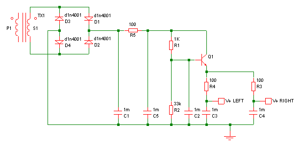

As for PSRR, yes it's a real problem and I was thinking of smoothing the HV rails using a ridiculous CRCRCRC filter. Need to think a little more about the actual values, but I was thinking of something like 100R and 1000uF, off the top of my head.
The other thing I wanted to think about, if I were to go the CRCxxx route is the effect of such a high impedance supply on the distortion of the input stage. Anyway, something to think about.
I was also thinking of things like a huge zener string, a basic shunt regulator, a feedback regulator and also a few other ideas. Always keen to hear your thoughts.
Mostly to make the mental arithmetic easier. 😱 There may have been some other reasons I thought were good at the time, I forget.
D2, Q2, R5 and R6 form a "mirror with gain" i.e. Q2's collector current is directly proportional to Q1's collector current, without a huge DC offset. This means the voltage across R4 is directly proportional to the voltage across R1.
Somewhere along the line, I had a useful insight:
a) The voltage across R1 is 1V (due to LED biasing).
b) I want 35V across R4 to give the servo maximum range.
c) Therefore the DC voltage gain of the servo from base of Q1 to collector of Q2 is going to be 35, no matter what current gain is chosen for Q2 or what idling currents are chosen.
That gets rid of a lot of uncertainty and makes life much easier. Without the diode, everything affects everything else.
Can I ask if you have tried the circuit in a turn on situation with an input signal applied?...
Nope, I didn't try any start up/shut down stuff, but I'm surprised you got oscillation. What sort of frequency was it? I would expect the output to be stuck hard to the negative rail for a few moments while the input cap is charging.
I like to think of this thing as a back to basics brute force amplifier....
I was seeing it as a clash between minimalism and the quest for maximum open-loop linearity. 😀 One of the things I love about this forum is you get to see, and play with, all different kinds of design philosophy. The high rail voltage and heavy degeneration should indeed give good linearity.
I have stuck with a singleton input because I love the way they sound. All that H2....
I think a nice compromise would be to add an LTP input stage with heavy degeneration, so it has little (if any) gain and negligible distortion. That way, distortion will still be dominated by the MOSFET voltage gain stage, there's no need for a separate servo, and no worries about switch on/off thumps.
...it would seem there's no real point to making this circuit direct coupled anyway...hmmm. Might as well make it single rail and capacitor couple it.
I'm not really a fan of that approach, and prefer no coupling cap and no thumps when switching on or off.
If you do decide to go that route, I'd suggest putting a coupling cap between the voltage gain stage and the buffer as well, so you can still run the VGS at high voltage.
Thanks for the explanation Godfrey, I get it now.
Actually I just revisited my simulations and the oscillations were only there for some of the more elaborate versions I came up with.
Your idea of using a heavily degenerated LTP isn't a bad one, though I hate the thought of adding another gain stage, no matter how benign! I have no problem with a big turn on thump provided it's not damaging. Going to play around with a few simulations over the coming days and see what I come up with. Do you have any thoughts on the HV rail smoothing? I am also tempted to try an opamp servo though I'm still yet to come up with a circuit for this amplifier.
What you mentioned earlier sounds OK. The output impedance of the RC(etc) network will be quite low and reasonably linear in the audio band, so I don't think it will cause distortion. OTOH, it might cause some cross-talk depending on the amp circuit, so having the last RC separate for each channel might be a good idea.
Something else to consider is a cap multiplier. They can give a very long time constant and good ripple rejection, without using huge caps. They also have very low output impedance but it's very nonlinear, so a bit of a mixed bag.
I'm thinking of something like shown below, but maybe that's overkill.
btw, It occurred to me you don't need a separate transformer for the high voltage rails. You can use a diode-capacitor voltage multiplier fed from the transformer that powers the output stage. Should save some cash that way.
Wow, you whip these things up in an instant!
Ah yes, a cap multiplier. Nice circuit, those things still intrigue me. I must build one at some point, in fact it could be a good choice for this amplifier. I wonder how a fet based version would work, in keeping with the overall theme of this design?
