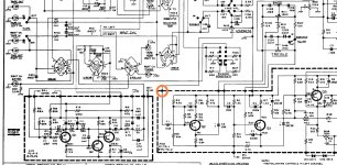

I disconnected the preamp from the amp at C1. (Circled in orange.)
For the power supply cap you suggested replacing, are you sure you want me to swap out C3 and not C2? It's the B1+ 25V, not the B5+ 25V that I saw that AC on.

I'm not viewing the entire schematic. The phone's screen is small. I mean the cap filter that gives supply for the preamp section. Also try to cut at C3 on the amp to completelly disconnect amp from pre and leave power stage alone. In case of doubt replace both C2 and C3 on the 401 board in parallel to both zeners.
Also it's confusing for me that there are repeated identificators for parts nubers/names and the fact that positive rail is under the scrematic and not above as usual.

Oswaldo: I've attached the full schematic of the preamp, tone, and amplifier sections, as well as of the power supply. Hopefully, the resolution is good enough.
I tried disconnecting the amp board from the tone controls at C3 on the amp board. No change; the issue persisted. I still need to replace those caps (C2 and C3) on the power supply board. Stay tuned.

Resolution is OK for me. I'm viewing it in a small screen.
Please, acclare to me where are you seen the problem. At loudspeaker output or somewhere inside the circuit.
