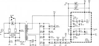

I'm working on an H.H. Scott 348 that initially had a problem with very unstable bias in one channel. (See this thread.) The bias issue turned out to be the due to someone before me inserting a cap backwards in the tone circuit. The bias in both channels now adjusts properly and is relatively stable.
Next I replaced the two 2,000uF output caps, as well as the 1000uF cap that handles the 70V B3+ for the amp boards. I hadn't checked the DC offset prior to doing this, so I have no point of comparison for what I found next. With an 8 ohm dummy load hooked up, I'm seeing DC spikes at the speaker terminals of more than 300mV in one channel and 200mv in the other. My understanding is that, with the circuit loaded, I shouldn't be seeing any DC through these output caps, let alone spikes that high. Thoughts?

With some kind of amps you will allways have a steady dc offset because a part of driver's current flows though the voice coil. See R18 from the feedback network. But not spikes.
What kind of such spikes do you refer to? (Frequency, amplitude. Duration, etc.).

C404 seems to be small for such an ampifier. In any case try to disconnect the amp from the pre at C3 to see which of them are causing the trouble.
Ah well, I probably should have upped the capacitance of C404 when I replaced it, but I kept it at 1,000uF.
Looks like C1 is the input from the pre, so I'll try disconnecting there. Thanks Osvaldo.

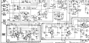

Thanks so much for weighing in Fahey.
The peaks that I've measured occur so quickly that I can't snap a photo of my old analog scope screen fast enough to capture them.

These sudden DC shifts can be caused by bad solder joints, bad resistors capacitors transistors or diodes, etc. Heard as pops.
If you have a scope, then you can trace by looking where the pops or DC shifts first occur. You'll need bigger gain towards the front than near the back.
Then at the stage where the pops start, look for bad connections around there. Push on solder joints with a stick.
If it is in a part ( and not unusual for parts in 1965) a heat gun or circuit cool spray may excite them to misbehave differently.
Certainly look at the power supply outputs with the scope. If the power supply voltages are not steady DC, then nothing else can amplify silently.
HHScott was reputed to use AB military grade carbon comp resistors, which I have found to be pretty reliable. Hammond organs are full of them. The one defect they have is that high value ones (over 100k) can experience moisture leak in and decrease the value.
The usual suspect on 50 year old amps is the electrolytic capacitor. Rubber sealed ones are particularly destined to a bad end. There were some sardine tin models that Hammond used that last nearly forever, but most other brands the seal that keeps the water in is some sort of elastomer. 1965 elastomers were nothing to respect greatly. Electrolytic caps are the ones with a plus & minus, a straight and curved plate. The actual part will have a plus on one end. If removing mark the board with plus so as to not put the replacement in backwards. Parts are available now with service lives up to 10000 hours, which should be fairly permanent. These high rated electrolytic capacitors have quite respectable elastomers as sealant.
But 1965 diodes & transistors were subject to dust & dirt floating around the fab areas, and much more likely to be popping than modern parts. Welds inside diodes & transistors were made by humans in 1965 too, with variable results.
Don't neglect the potentiometer, which can connect or lose connection wiper to track randomly in old age. This includes the volume pot, subject to high wear.
Thanks for posting schematics. I've never seen a used survivor HH Scott model <$150. I've never owned one.
Happy hunting.

There are 4 inputs from the Riaa & tone control sections to Q1 & Q2. Bass treble, loudness, and balance. Any of those could be source of the jumping. I'd take a scope and look at each, for amplitude of any jumping. Don't know what you are doing with capacitor to R13 & R4. R13 establishes operating point of Q3, I wouldn't monkey with it. Except to push on connections with a stick and see if big popping occurs. A trash speaker on output will alert you to what is going on, if your eyes blink or the pop happens between scope sweeps.
Slow variation of +70 rail at collector of Q110 shouldn't cause popping. It should sag in voltage as the amp puts out more wattage, that is normal. But such sags are below 10 hz usually and inaudible.
Again, locating first stage where the voltage changes suddenly with no input is kind of where you are, since your power supply is okay. Shorting the input is a problem on this amp since it has 4 of them.

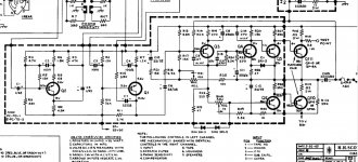

Ok, I checked the four inputs. Those at C3 and R15 are both showing fluctuating millivolts on my scope and meter. I then checked around the caps for the bass pot and my meter displayed the same thing: voltages spiking to over 200mV.
Probably not coincidentally this is the same problem area that led me to that reversed C3 cap that was causing the bias in one channel to be all over the place. I had checked the voltages at the bass pot then, and found a few volts in spots (see attachment). When I replaced that mis-installed C3 cap with a new one, the bias calmed down and those grossly high voltages were gone, however, I didn't pay much attention beyond that. Something else I had noticed was that pressing on the knob of the pot had initially caused those voltages to spike. I retightened the panel nut for the pot and that seemed to help. At this point I'm thinking either one or more of these .068 caps is bad or there's a mechanical issue with the pot itself.

Film caps are usually pretty reliable, but maybe not in 1963-68. I've had good luck with Mallory and Goodall film caps in hammond 1964-68 organs, and sprague in 1966 wurlitzer organs.
Pots, especially those on the front panel, are high wear items. Hard to buy these days though, clarostat & CTS and all mil-spec 1/4" shaft pots, the factories have been closed & demolished.
Then again, don't forget to push connections in that area with a stick while listening. These were hand soldered.

Indianajo: I suggested shorting (AC grounding) those resistors not as a "solution" or "messing" but to check whether they killed the mystery spikes.
It´s a "diagnostic" action
That problem worsened makes me strongly suspect grounding (actually loss/worsening of it) or loss of supply decoupling.
Old high ESR rail decoupling caps come to mind.
