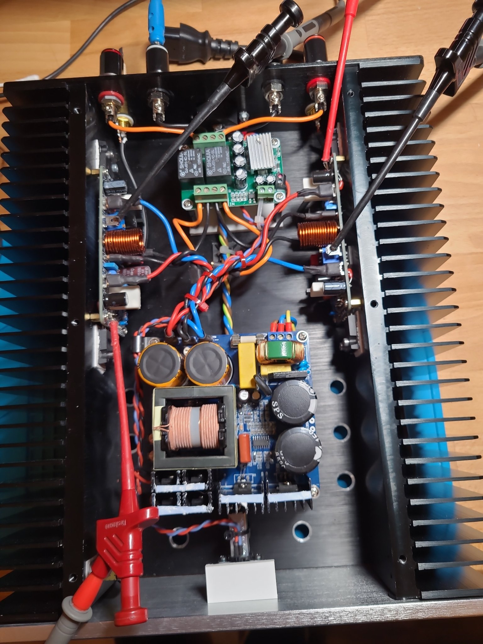

i have build two Amps with a Connex 500R/+-45 Volt SMPS and FH9 XRK Mod boards.
The Amps are working without any problems, but the offset is rather high on all boards. Two boards get an offset of 19/21 mV the other two boards get 26 and 29 mV.

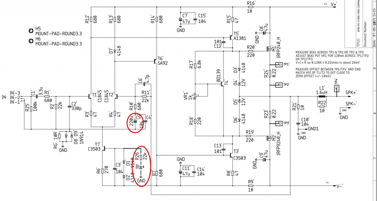

Tried to measure VGS of the Mosfet belonging to the schematic of Mr. N. Pass. Got luck i could find enough matching pairs for example 4,00 volts VGS for one pair IRFP240/IRFP9240 for a board. The other pairs are not very VGS different, say 4,02 and 4,04 volts VGS or similar.
Took T6 MPSA92 out and choose a 2N5401 as replacement. The 2N5401 has a litle bit higher hFE.
Soldered out the KSC 1845 and matched every pair with my Peak Atlas, without heat and with heating. Finding matched pairs and put them in. For example hFE 420 and Vbe 727.
Nothing helps..the offset remains at high 26 mV.
Changed the KSC1845 to 2SC2240, yeah...50 mV offset...ok, seems not to be the right way....
The mosfet drivers are matched Toshiba TTC004B/TTA004B instead of KSC1381/KSC3503
If i measure PIN 1 to ground at IRFP's i got different voltages. 3,96 volts at the IRFP 240 and 3,74 volts at the IRFP 9240.
Chris, Cherman, gave me an advice to change the gate resistor at IRFP 240 from 220 Ohm to 330 Ohm as a try. Done without success.
If i do that and change the gate stopper both IRFP have less voltages in the same proportion. 3,92 volt/3,68 volt
Another idea was to change the resistor R15 at the driver to the N channel from 47 to 56 ohm or more....nothing...no success
Surely i have controlled every component, resistors, diodes..and so on...
Amp is stable with its offset about 20 mV or a liitle bit higher, no problem to adjust the bias. I choosed 120 mA, 26,4 mV over the 0,22 ohm resistor.
Has anyone an idea what else i can do to lower the offset ? Any idea to make something better is welcome.

Hi Peter.
I am not the expert but the transconductance of PCH is typical 4.2 and NCH ist about 6.9.
So it ist needed to give the pch mosfet a bit more voltage and or give the nch less voltage. So the source resistor must be a bit bigger at the NCH mosfet.
So add a 0.01 Ohm resistor to the source resistor of the NCh.
Or
Measure both Rs. The 3 or 5 Watt resistor have tolerances so use the bigger resistor at the NCh
Kr Chris

The output error voltages you report seem reasonable, and offset less than 100mV is typically deemed acceptable. But if you wish, you may be able to reduce the offset error.
Because the early stages of the amp produce large open-loop gain, it’s unlikely you will observe any effect from efforts to adjust matching of the output transistors. Rather, the offset likely originates at the input stage.
You mention output voltages of about 20mV and almost 30mV. Are they positive, or might they negative with respect to ground?
Would you report voltage drops across R12 and R13?
Would you also report voltages at amp output, base of T1, and base of T2? Please indicate negative voltages as signed numbers.
Thanks.

I predict that you will find voltage drop across R13 is much smaller than drop across R12. If so, that's an indication that T2 collector current is not well matched to T1 current. Try installing a jumper wire across D7, so that D7 is effectively removed from the circuit. Check if you find improvement.

Since you have already matched the input pair, and I've read swapping devices also did not work out, it seems the other option to do is to change values of the resistors in the input stage and since T6 base is tied to the collector of T2 it also influences the current flow. You may try adjusting the values of R7/R14. This is a compact circuit with only few components, it is very sensitive to changes. I have been playing with this circuit in simulation a year ago. 🙂
Albert
Reactions: Kleinhorn
I also noticed that you have lifted ground (RG 10R resistor) used for the input stage, but at the same time you have
R5 (2k2) from the T7 CCS connected to it. R5 should be connected to the dirty (output) ground.
Assuming there is 2mA flowing through R5 (and in consequence through RG), it will generate exactly 20mV offset on RG.
10Ohm * 2mA = 20mV.
Try connecting R5 to the dirty ground, and see if output offset is gone.
Alternatively, you can try to measure output DC offset vs clean input ground, and see if you are getting lower number.
If you do, then I'm right.
Another alternative - short RG, and verify DC offset.

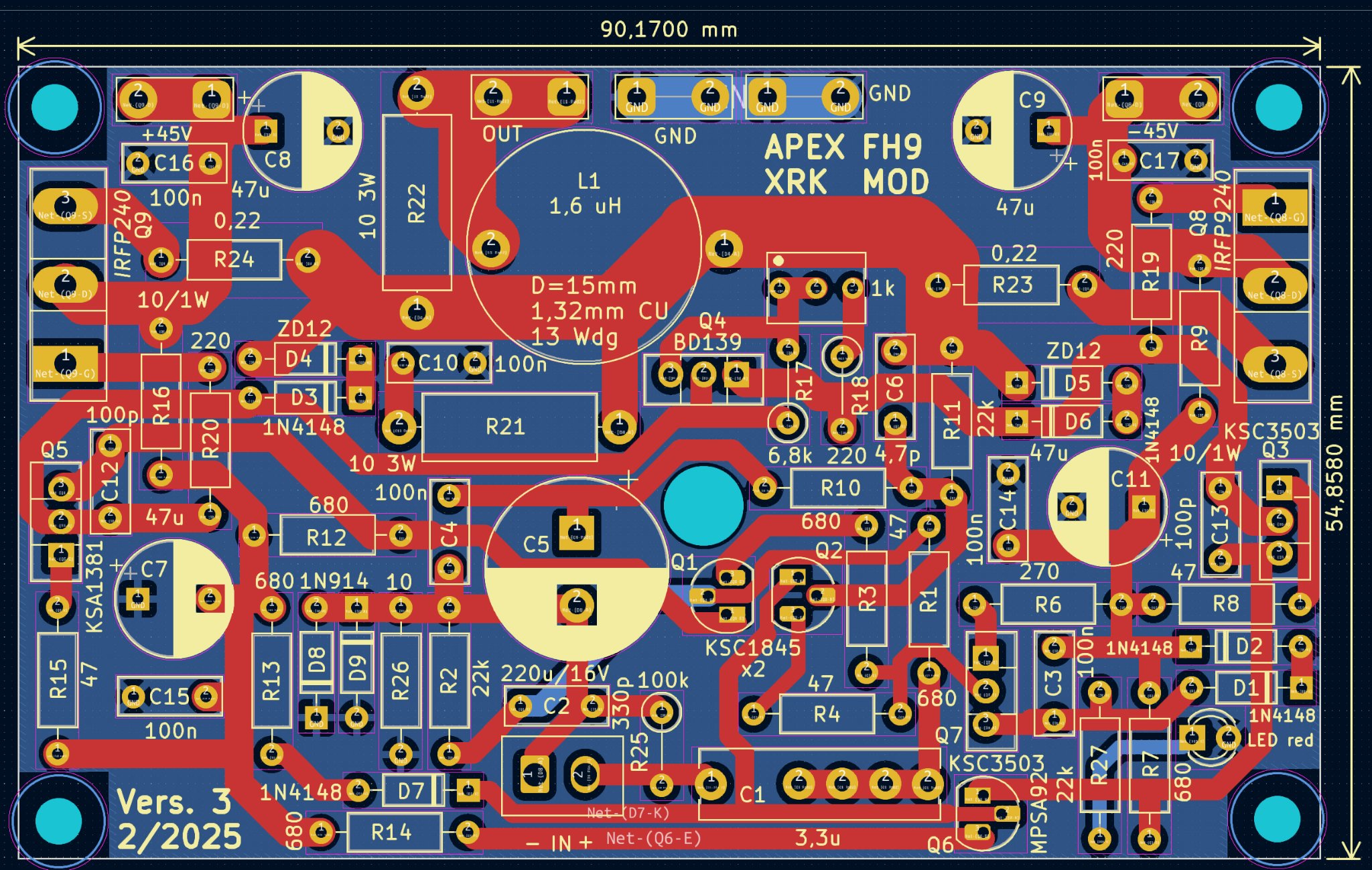

Then the second schematic makes sense. I did not know why different schematics are existing and why the gerber files gave the board i used, alonging to the first schematic. I think Chris, Chermann, is using the same board.
I will try to short RG first. If i get hum, i will use the dirty ground with R5, 22k. A short wire to ground at RG seems possible with not much crossings.
I have designed a new pcb with schematic number 2. The feedback capacitor will be bigger, 12,5 mm to fit Muse NP.
