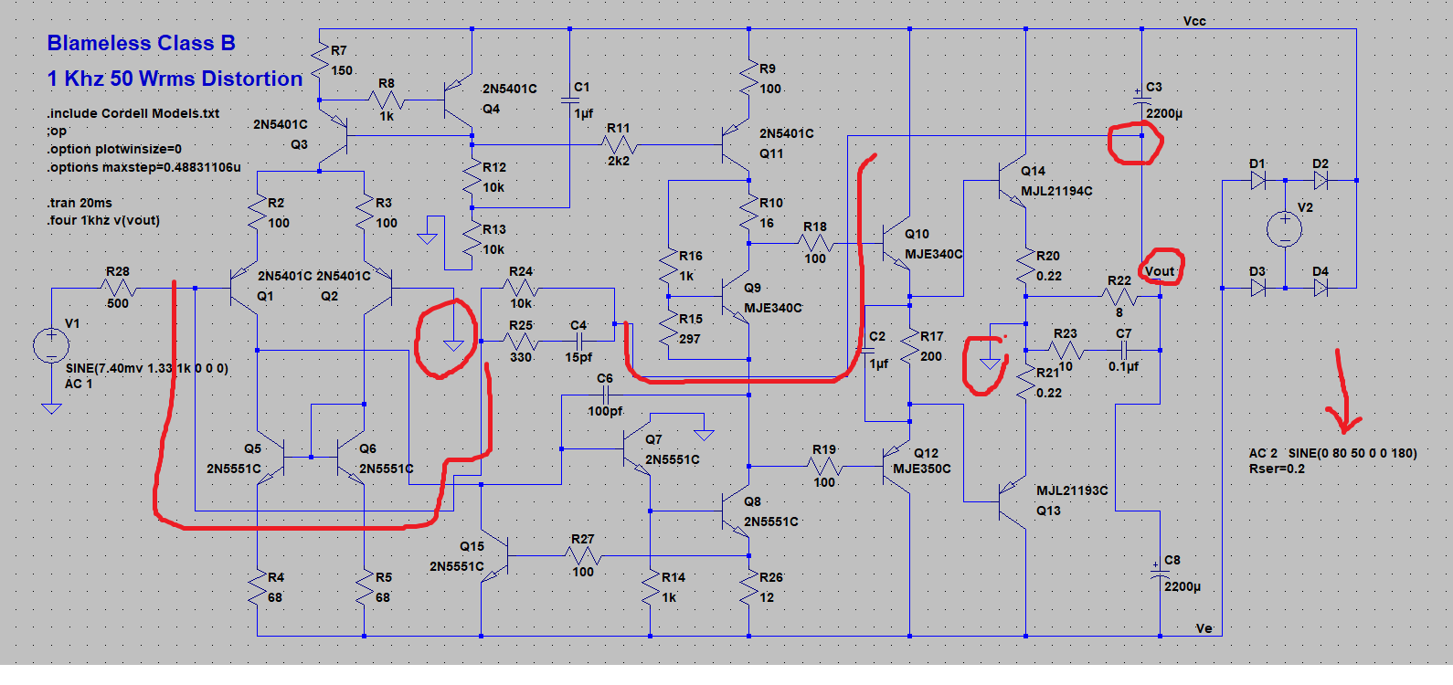

A conventional emitter follower would need 126V p-p drive, so a fairly elaborate driver, what Doug Self calls "VAS".
It can't hold real DC in a load, as has been said.

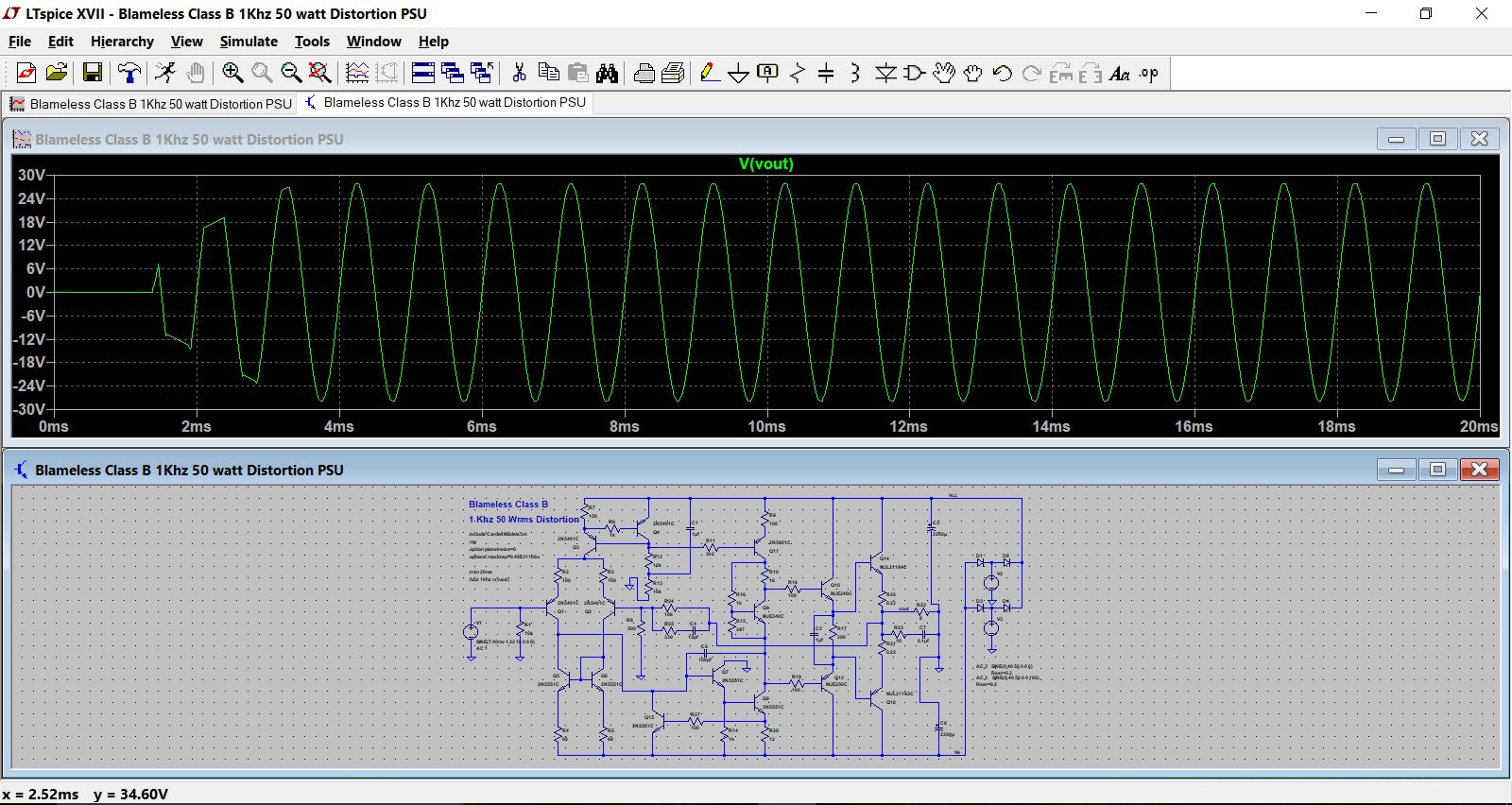

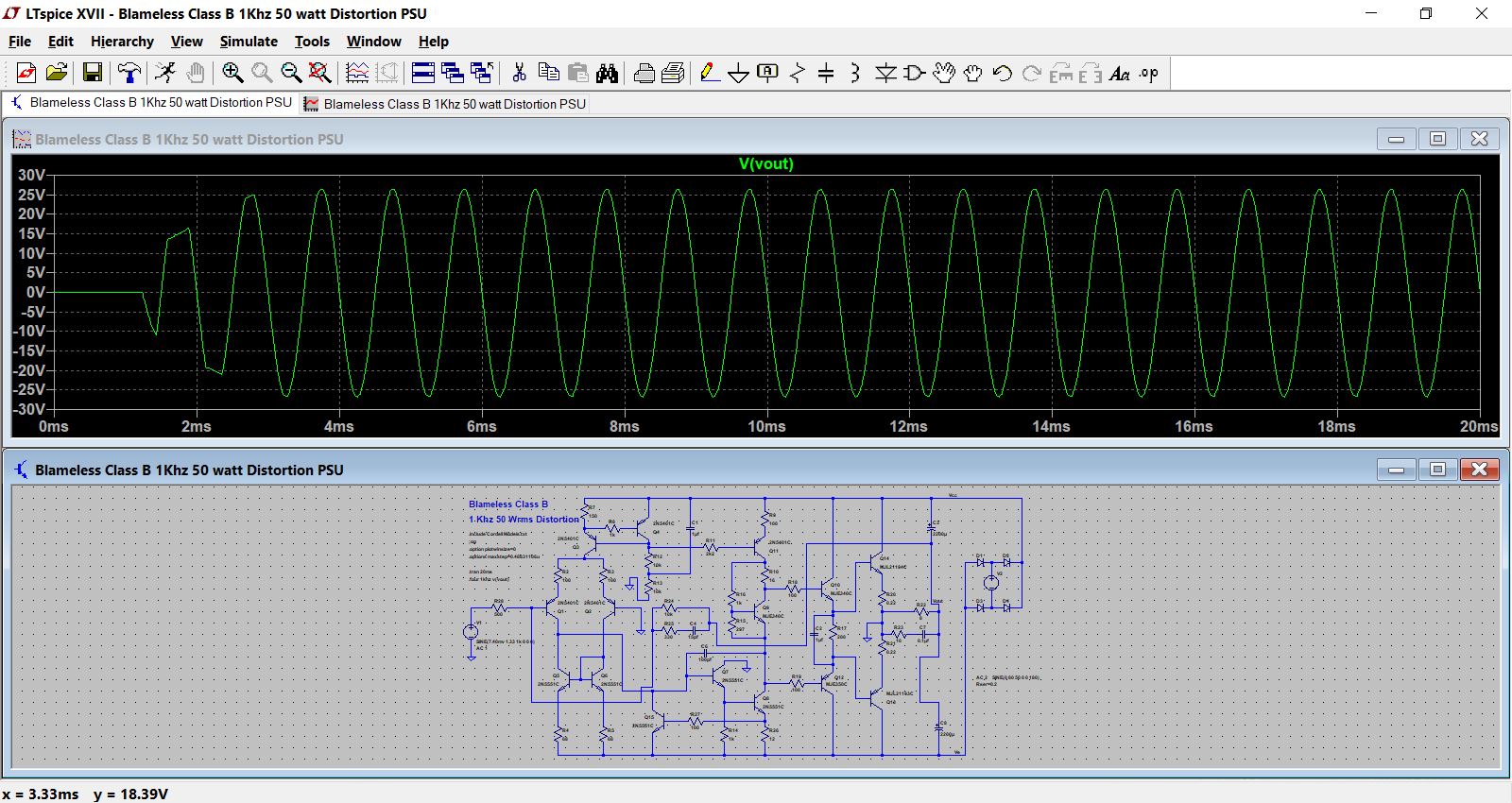

The NFB will attempt to zero the output DC. Initially there is an offset because two (four) giant caps can't ever match. If they are 10% different it will come up several Volts off-center. The NFB quickly reduces this but on an exponential decay: 3V now, 0.14 later, 0.007V much later.
This is not A Problem. This is a Big Stage Amp. If your speaker can not stand a few-Volt thump and say 0.2V steady, then it sure will not like 60V peaks of program. The say-0.2V is 0.3% of what you plan to hit the speaker with. No speaker is centered to 0.3%. No likely program material has 0.3% (49dB!) peak to average ratio. This isn't even a pea under the mattress.

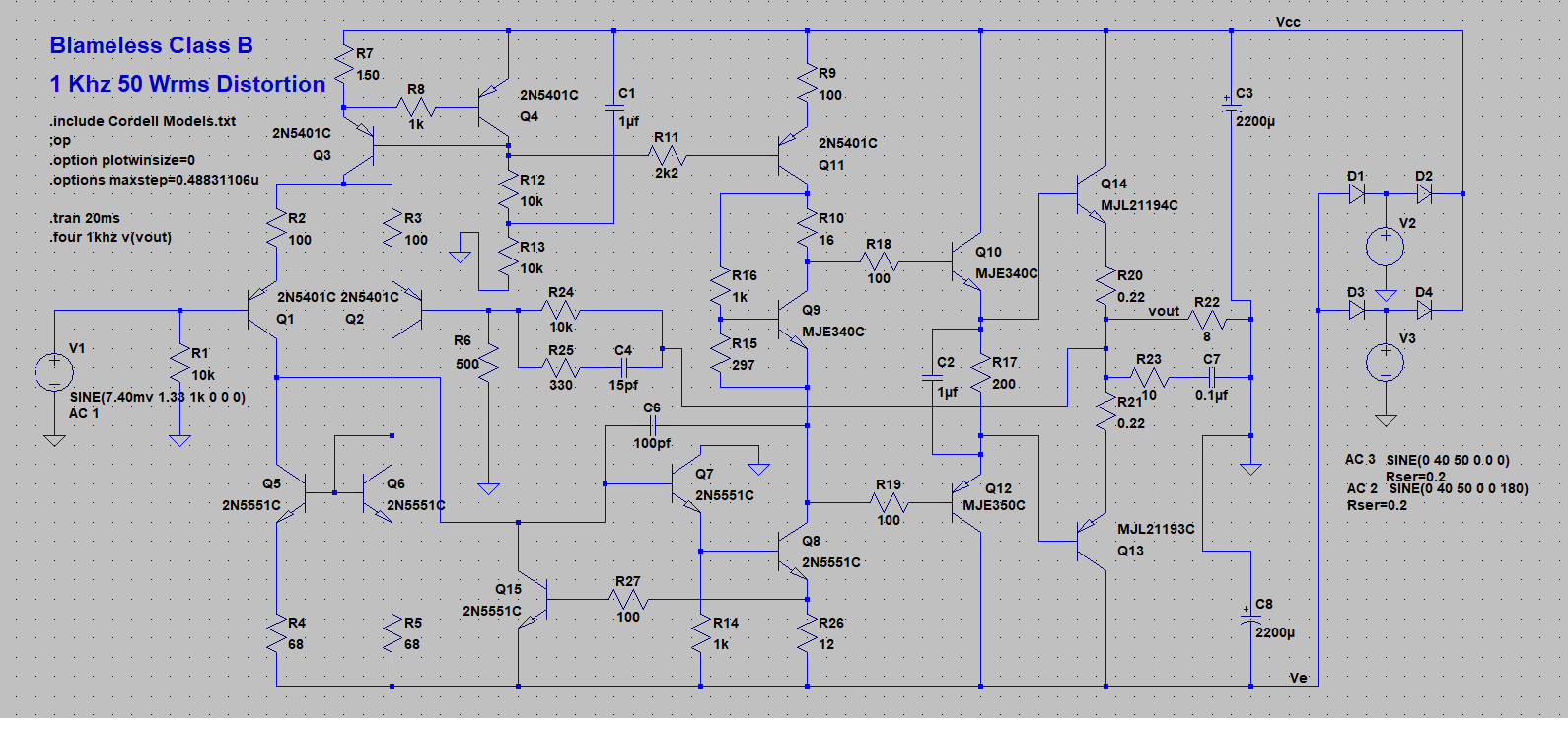

Thanks for sharing the schematic on this interesting amplifier. Do you have the rest of the manual? I disagree with the remark that "this is just the way it is". There are no tricks or shortcuts with any amplifier and especially with this one. But, you know that the main work of keeping offset low is going to be the input differentials, or in this case the input IC.
No surprise, start with careful d.c. checks, power supply first, and keep notes. Compare one channel to the other. If those checks don't lead you anywhere I would replace the input op-amp on the faulty channel. One thing at a time or else you will get lost. Post results as you go along.
