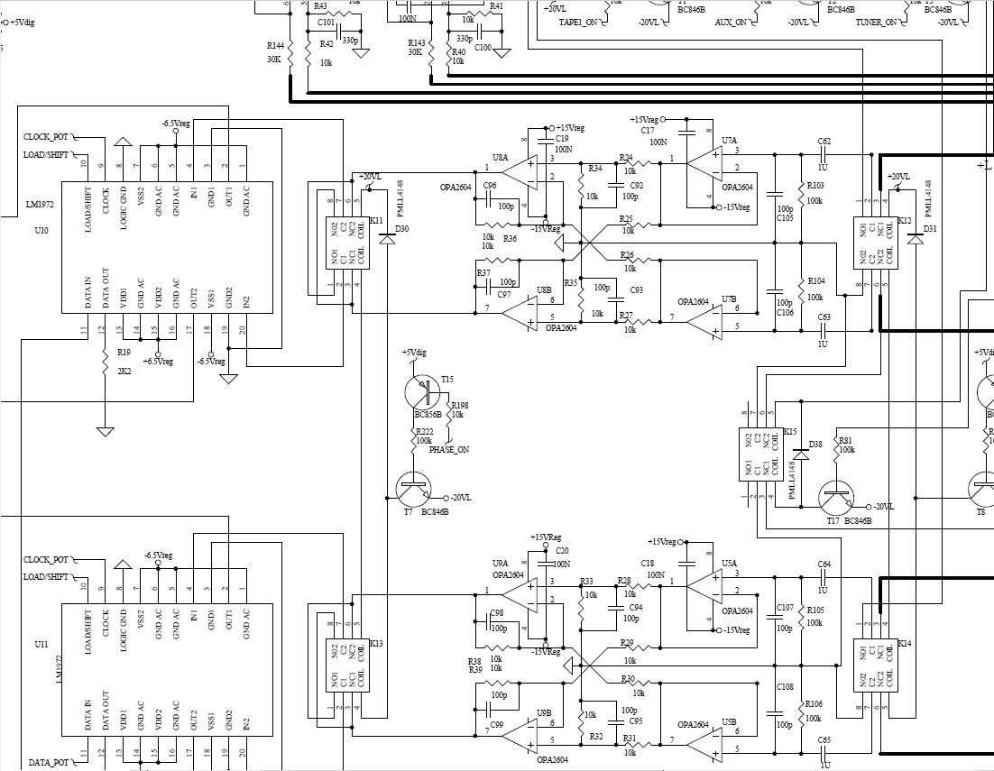

I forgot to mention that it is volume dependent, dont know if it matters or not...
So the amplitude of the noise is dependent on volume setting?
That's a valuable clue, as it locates the source ahead of the volume control and excludes everything following it - including a lot of the preamp section and the entire power amp.

Yes, I dont hear it at low volume.

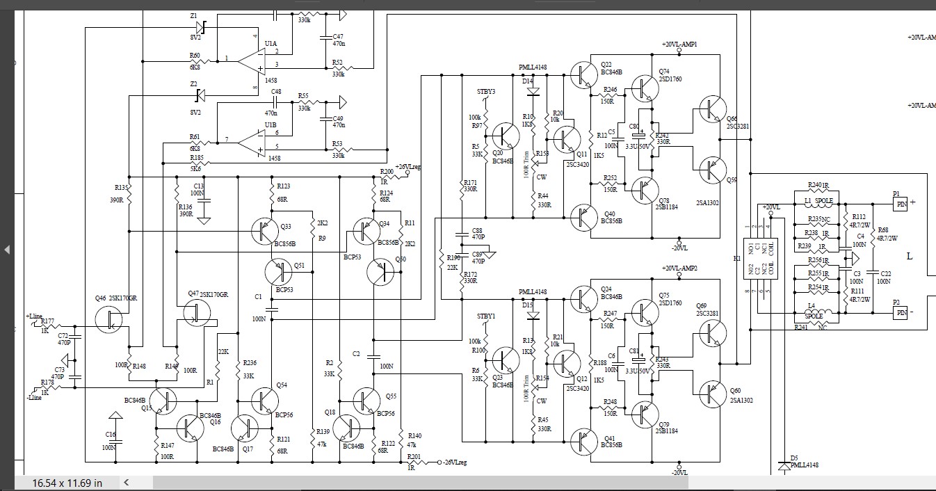

And its not what I was expecting. It looks to be a bridged amp using balanced circuitry.
Fault finding is not going to be easy on something like this and I would say that you really need a scope to look at whether the distortion is appearing on one or both sides of the bridge and also to look at whether the inputs to the power amp are clean.

The interesting part is on the next page. We have already established that the offending noise varies with volume setting, so is likely to be ahead of the respective channel's LM1972. Could be a bad solder joint on one of the relays or one of the passives in the balanced receiver circuit (like one of the various 10ks), or maybe a bad opamp there.
A seasoned tech with a sharp eye may have a better chance of tracking this down, though bad solder joints can be really sneaky at times. Since there are two of every kind of circuit (plus the other channel), some comparative resistance measurements may help.
