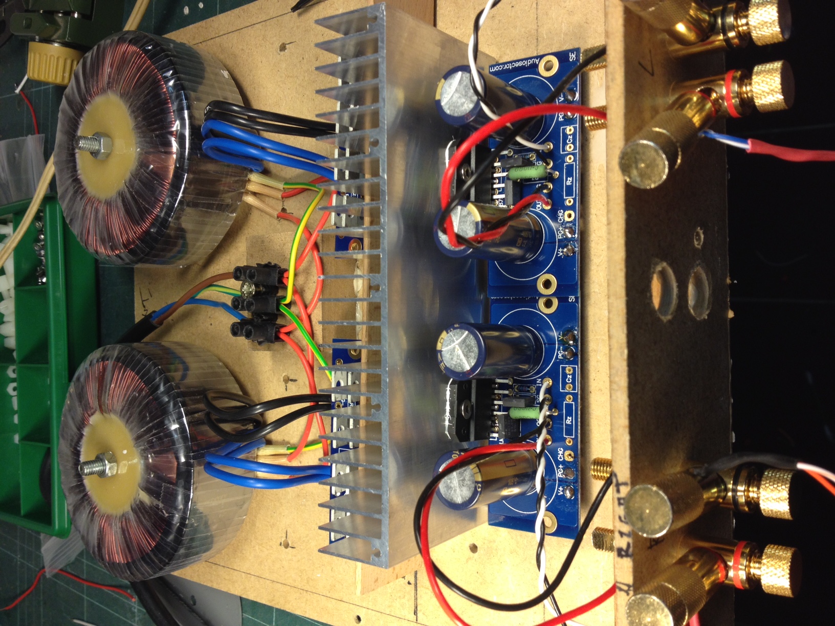

Hi, I've just completed my Audiosector LM3875 build. The proto build sounds really good and there is no hiss or funny noises coming from the loudspeakers. 🙂
DC offset is around 4 mV on the right side and around 20-25mV on the left side. I've visually checked the soldering and all seems ok.
Although 20-25mV is not much, what could the reason for the difference between the left and right channel be ? Is it a concern ?

It's not a problem of grounding, this amp will amplify any DC present at its input, because there's no capacitor between R3 (680R) and ground.
To avoid any excessive offsets at the amp's output, you have 3 options:
- use a source with no DC offset
- use input coupling capacitor (2.2uF or bigger, can be installed in place of R2)
- or use capacitor between R3 and ground (22uF or bigger)

As stated before, the offsets will vary with chips: some chips show much bigger offset values than other in this particular circuit
20-25mV is nothing to be concerned and anything less than 80mV or so is still fine.

Hi and thank's All for the input !
I cannot change the source it is the only one I have 😉
I is a Yulong DA8 DAC i payed a fortune for 🙄
So I guess I'll put a input coupling capacitor in R2. What is the advantage of point 2 over 3 ?
Thank's !
Rupert
PS. I still don't understand why the measurements changed so much in the course of 3 or 4 hours of continuous playing music at normal levels ?? Probably my Yulong ? I hope not.
It's most likely Yulong changing it's output offset.
As to advantage of pint 2 is that you can use much smaller cap, so better quality and you actually protect the amp against any possible offsets from sources.
Point 3 only prevents amplifying of the offsets. The amp has approx 32x gain (or 30dB) so if the the source offset is 5mV you will see 150mV at the amp's output.
The possible advantage of point 3 is that the cap, although much bigger, is not in direct signal path so it's effect may not be that obvious. Although, OTOH, there's no such thing as component not in a signal path, everything actually matters.
