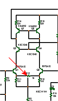

I use an LTP current mirror with a preset in one leg.
The offset then can be adjusted very accurately.
You want to get the pair to have as little offset as possible BEFORE any trimming (2-5mv) , as if you trim too far you will affect the gain (degeneration) of one transistor too much. Most of the time , what little "trimmin' " I have to do is to compensate for the 1% tolerance of the fixed Re's.
I use this (below). 1/4 to 1/2 turn (25 turn trimmer) is all that is usually needed .. more , and I know that there is a crappy match.
PS .. it is usually wise to match the current mirror as well in a topology like below , the cascode is less critical.

Depending on the design the offset can also be improved by (hand)(or machine) matching the individual active devices (transistors), however the total offset is likely to be a result of slight mismatches between both the active devices and the passive devices (resistors). Eliminating the mismatches all adds to the cost.

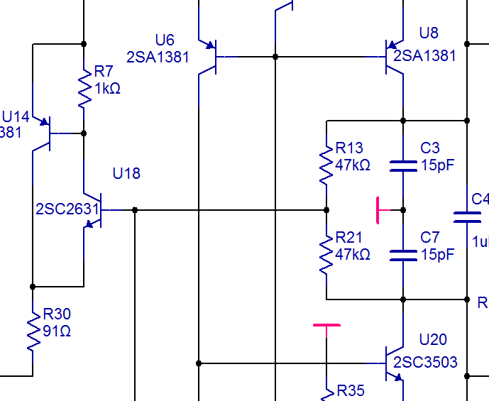

I have some small experience with 2 NGFB designs and I can understand why there is offset. It can be tricky to get it down but it is doable. Normally, in this type of amp, feedback is picked from the VAS and to keep offset low, you need to pick from the high side and the low side using 2 resistors instead of one:
R13 and R21 in the above pic. These also need to be very closely matched in value.
With that said, there is absolutely no apparent benefit to this type of feedback scheme, other than the bragging rights to say no global negative feedback. Possibly, the less technically minded among us see that and assume no feedback period, and think that is good - they've read how bad feedback if is some well respected audio review magazine.
