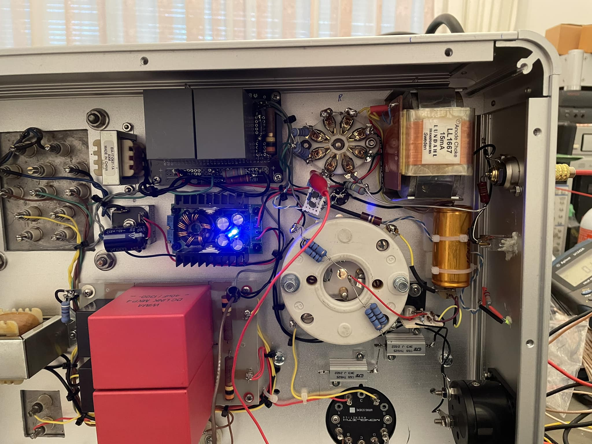

I am using 2x Kemet C444U 500 uF 900 V DC links in the first position of choke input 800 V power supply. 1 mF is required for damped supply operation. The size is the same as equivalent electrolyte capacitor would be (or even less), but they are PP metallized capacitors. Their characteristics are simply amazing: equivalent DCR in milliohms, equivalent inductance in nanohenries, voltage rise time 7 V/usec, peak current over 3,000 A, ripple current 50 Arms, according to data sheet. They are rated for high frequency, ripple current rating is at 10 kHz.

Choke input supply has ringing response (in LC tank of the first choke and first capacitor) to load transients. This ringing can be snubbed by adding resistance to the resonant tank. The resistance consists of transformer secondary DCR, choke DCR, rectifier forward resistance, and additional resistance in the rectifier circuit (added on purpose for damping purpose). Jim Hagerman has a calculator for minimum value of the first capacitor for given DC resistance.https://www.hagtech.com/choke.html

I used the DC link capacitors in my 845 power amp.
