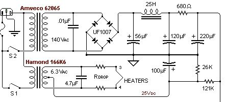

Hi Rick
here is the attached psu schematic.the floating is set by the 26K and 121K resistors. which five a nice 25vdc floating from ground to the heater supply. this floating dc is claimed can extend the life of the tube. since its not a problem then i just wired as suggested.
lm317... sounds good... will try this.
but will the floating dc affect the lm317 or the heater PT ?

Yo Erwin,
A DC filament supply can be either regulated or unregulated. Regulated is better and requires less total parts for a quite DC output. However, if you need to elevate it 25 volts for heater/cathode reasons, you must keep it totally floating above ground or your supplys will be in conflict. Connect the 25 volts to the output of the DC supply were the filaments connect. Never before the regulator or rectifiers.
No, you cannot rectify 5 volts and expect to get 6 volts out under load. You must start with a higher voltage AC of at least 10 volts. This is because under load the voltage will drop down. And if you use a series pass device like a 317, you need at least a few volts extra so the device will see a differential which it need to operate. Capeesh?

Capacitors pass AC. It represents a resistor when connected to AC voltage. That's how it is shown on your diagram. There are no rectifiers so there is no DC to filter.
Normally there is a large capacitor before the regulator. After the regulator use only a small value capacitor to quite any possible noise if needed.

It appears the posted PS schematic one of Poindexter's; you could ask him why the caps are there, as I am kind of wondering myself.
I am also just finishing a breadboard for his music machine and that schematic also shows a 4.7u across the filament secondaries and a .01 across the transformer secondaries. I would guess it's for noise suppression but I'm no expert.
If your filament voltage is too low, you certainly do not need the Rdrop.
hi boywonder
yes its Poindexter's psu schematic for 6t4. i take part of it as i do not know how to draw schematic.
if i am not mistaken he said the 4.7uF is to improve the heater supply but you better confirm with him bout this. i saw few schematic with caps on secondary AC as well but forget the value.
my filament voltage is too low. hence i do not use the Rdrop at all.
0.01uf on secondary is kinda snubber network and many people use it. its discuss in threat below discussing the right value for certain VA PT.

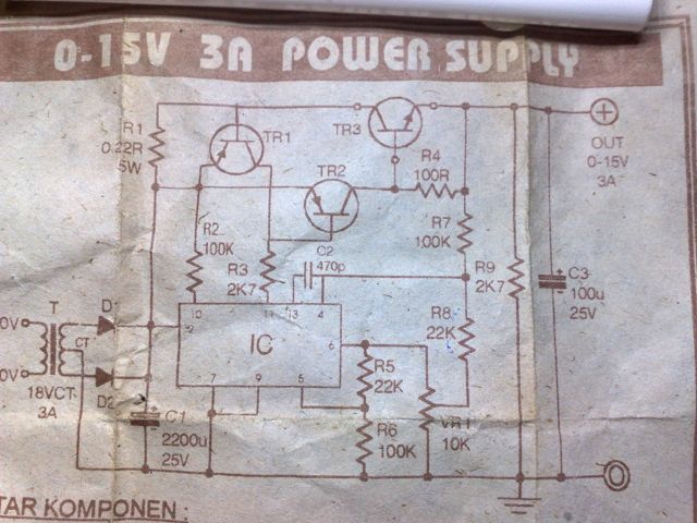

this is the psu schem i use to power the heater 1A. the 2n3055 is getting very hot and the power transfomer become very hot to touch.
TR1=BC177
TR2=BD140
TR3=2n3055
IC=LM723
i float this with 26K and 121k resistor from B+ to the ground of this psu output.
PT is 18v CT 18v and rated 3A.
however, i connect this output to the 4.7uF capacitor from the schematic above. but without the Rdrop resistor.
ps: just quotes the custom transformer for just the heater supply cost 2 or 3 times more from this psu with off the rack PT
TIA
erwin
