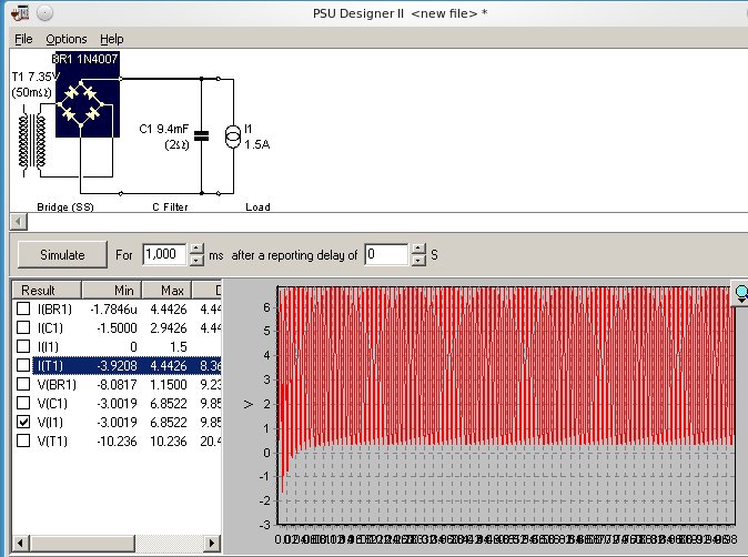

Hi there,
Having just figured out what to do with the HT supply, I'd like to pick people's brains on some concerns I have about the heater supply for a phono pre-amp I am building.
First of all, the pre-amp uses 3 ECC83s and 2 ECC82s. Moreover, in the future I will be re-building it (after I make sure I like the sound), to have 2 the 3 ECC83 section twice, this into resistors and into a tweaked version of the 2 ECC82 one (adding some feedback), to make a 2 channel phono mixer. Ultimately, I will therefore be running 6 ECC83s and 2 ECC82s from this supply.
The original schematic for the heater supply (attached below) calls for a 10 V secondary, into a bridge rectifier and smoothed by a large-ish capacitor of 10mF to give 12v DC.
My first concern is with the original supply. I put everything into Duncan Amps' PSUDII into a load, and got the graph of the voltage across the load attached below. It shows a pretty hefty voltage ripple (3.7 min, 10.9 max), and a max voltage which is significantly less than 12v. Am I doing something wrong, does the original design have problems or is this all ok?
More relevant to my specific case is the fact that my transformer doesn't have a 10 or 12 V secondary, but has two 6.3v (they are actually more like 7v as it happens) ones. Now, obviously one can wire the heaters of the ECC83s and ECC82s in parallel with a 6.3v supply. The problem is that when I tried to simulate a similar design to the original in PSUDII, but with my trafo's parameters, I got a min-max of 0.3V - 6.8v. Is this acceptable?
Final question relates to the current draw. As ~6.3v operation means double current draw by the heaters (.3A instead of .15A under 12v), I am worried that I may be running into limits there, given 5 or 8 valves. Does the fact that I have a second 6-7V primary mean I can run two separate PSUs and therefore double my current draw capacity, or do the two depend on one another? If ambivalent, is there a way to check?

Thanks, first of all (so that I don't screw this up), by connecting the two windings in series you presumably mean connecting the "live" of winding A to the "neutral" of B and then using the "live" of winding B and the neutral of winding A - correct?
Capacitor was 9.4mF (haven't found a 10mF so I'll use 2 4.7mF ones) and load was constant current of 1.5A (5 x 0.3A).
What diodes would you recommend using for the bridge?

Before you buy stuff and heat up the soldering iron, let's play in PSUD some more. Show the PSUD schematic window. Or show the screen. Then we can make specific suggestions and ask intelligent questions.

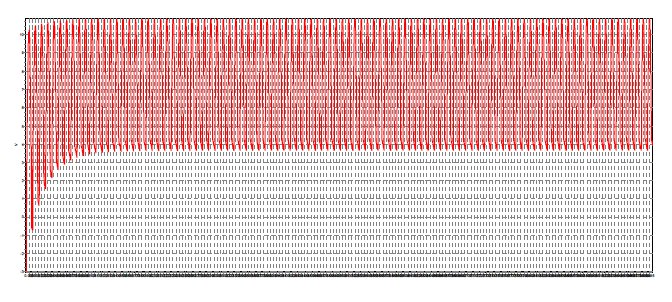

Sheldon, thanks for the offer to look at it, I am attaching a screen-grab. Running this on Kubuntu with Wine rather than actual windows, so I couldn't really get PSUDII to export pdfs, sorry if it doesn't look too good.
For your reference, parameters for the transformer were 7V and 7A (these were the readings I got roughly when I tested it), cap is 9.4mF (2X 4,700uF, as I couldn't find 10,000uF). Load is constant current of 1.5A (5X0.3A for each ECC8x).
Graph in red is the voltage across the load, which (after stabilising) fluctuates between 0.336V and 6.562V.

Ok. First thing, as Eli suggests, is to use a Schottky diode rated for your load. His suggestions are fine for specifications.
Try 1N5822 for your model. Also try 20mOhm for the series resistance of the cap. It will be nowhere near 2 Ohm for any reasonable 10mF cap. Then work from there. Even if you use active regulation (which I also recommend), you need a good model of the supply before the regulator. I would use the low dropout versions. No need to waste power.
If you want, you can do a CRC, with something like 0.2R resistors. A couple of RC sections will knock down ripple considerably. I wouldn't worry about turn on surge at this point, and I certainly would not add resistance before the first C. Do some modeling first.

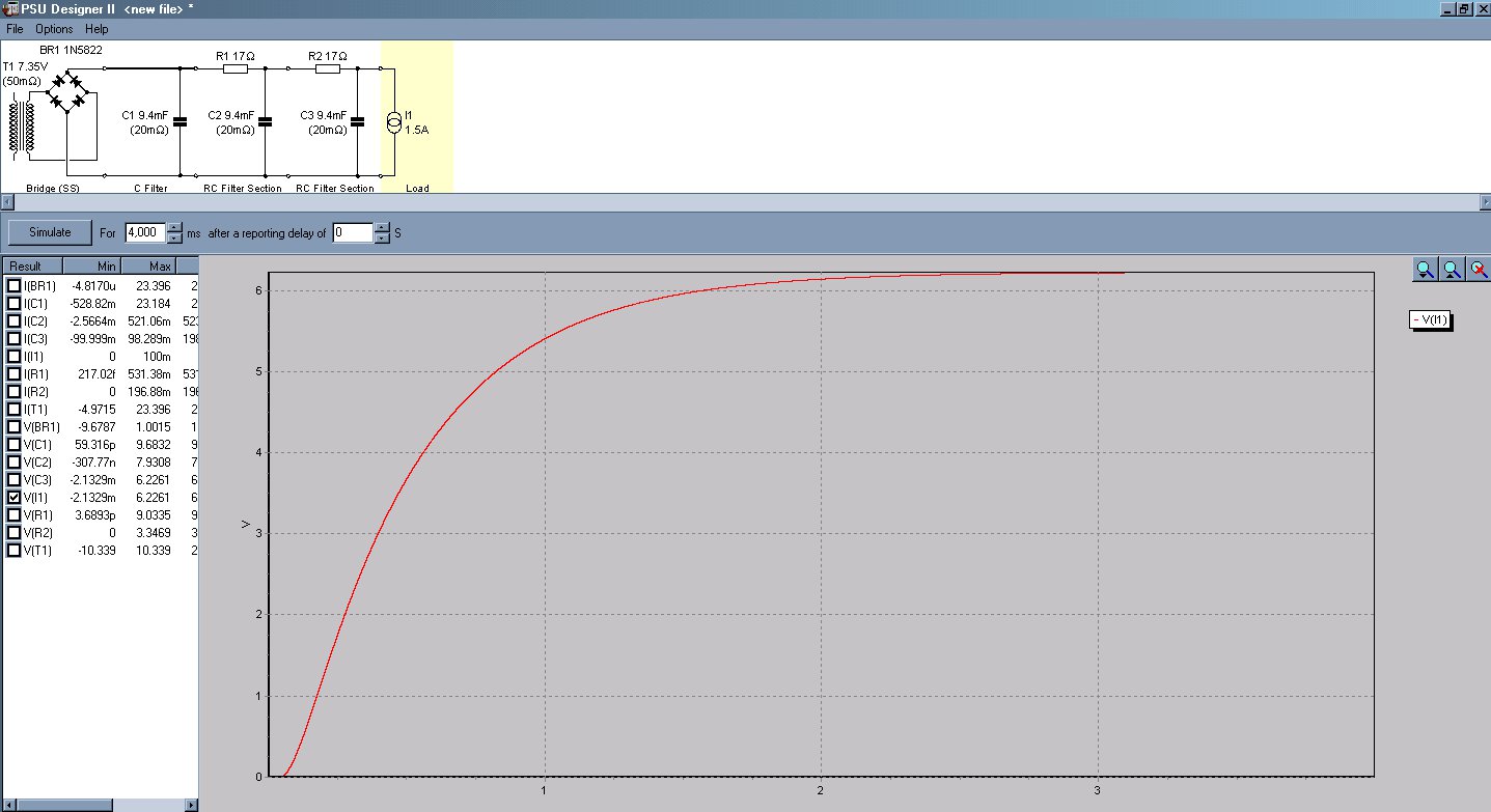

Thanks - it was the erroneous resistance of the cap that was causing the dodgy results.
Thanks for all the tips everyone, I will try this first with an unregulated CRCRC supply (9.4mF per cap and 17R for the resistors seemed to do the trick in the simulation so I'll start with that) and will look into a regulated supply when I start making the final version of the pre-amp. Will undoubtedly come back for help then. 😀
Nikos

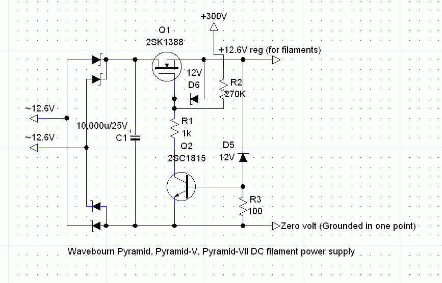

You mean R17, or 0.17R, no? And Wavebourn knows his stuff, so if you can get suitable parts, I'd go that way instead of multiple three terminal regs..

17 Ohm not 0.17 Ohm - my transformer measured ~7V, so to get 6.3 after rectification and smoothing I needed to drop the voltage a bit (schematic & graph attached).
Regarding the Wavebourn design, I think I will probably go for it in the final version, so if I could as a few things (and please excuse my ignorance):
Are the two AC "nodes" at a 12.6V difference between them or compared to ground and out of phase (in other words ~25 between them). If the former, can I just "series" the two 6.3V secondaries I have to do this?
Another thing I wanted to check on the design is the +300v. The transformer I am using, in addition to the two ~7V secondaries has two more secondaries, one giving 260-270V @80mA and one giving a little more than 300, if memory serves. I was going to use the 260-270 one for HT, can I use the remaining tap to supply the +300v shown in the schematic?
Finally, what diodes should I use?

Ohms law (V=IR)says no way. At 1.5 amps you will drop 25.5 volts over a 17 ohm resistor. Check your current source. It's probably set up as a step function and you are looking at 0 current.
The former, and yes.
In Wavebourn's design, the HV supply and R2 just form a current source to bias Q2. The voltage is not critical. Just use your filtered B+.

If you are doing 12V, your current will be halved, to 0.75A. In that case, 1N5821, or 5822, will be fine. If you go with 6V, I think the 3A part would still be OK, but you could step up to something like 80SQ045.

I used 12.6V winding, floating. In another amp I used 2 windings 6.3V in series (they also powered 6L6GC and EM80 filaments).
+300V means 1 MA current source. If it is slightly less or slightly more does not matter. Using B+ and a high resistance resistor is better than using a CCS and a small voltage source, such a way the regulator works down to almost zero voltage drop on MOSFET. Also, I don't care of number of tubes connected to the output (except 12.6V AC current capability), when MOSFET has good thermal contact with chassis.
Diodes I used 5822, they must be Shottky diodes. You may use as well 3-leg Shottky diodes from computer power supplies, I did that in an amp that needed more of current than 5822 want.
