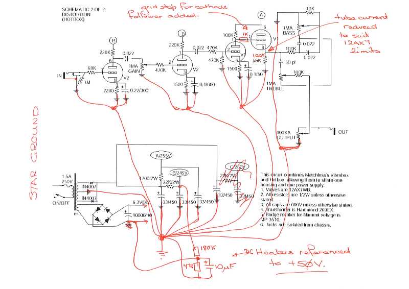

Also I am getting absolutely no noise when the gain of this preamp is at a level that is not clipping (or moderately clipping). Its actually lower than my fender amplifier on clean. Maybe there is no such thing as a quiet tube guitar overdrive?
Scribbles
Bob,
I scribbled on the original hotbox schematic you posted to show STAR GROUNDING.
It may be of some use to you - or maybe not!!!
Notes:
Drawing an extra 1mA 'ish from power supply node B for the +50V DC heater reference - might need to drop the 22K/2W to 18K or 15K
Added grid stop to the cathode follower, cathode followers are notorious for parasitic oscillation without the grid stopper AND the very high frequency oscillation is sometimes noticed as additional hum (coz you stress the power supply more).
Dropped the cathode follower idle current to something a 12AX7 can manage for a decent lifetime.
I would also add a 470nF/630V across the first 33uF/450V in the power supply.
Sitting the 6.3V DC supply on +50V like this WILL improve the sound and also reduces the heater to cathode voltage for the cathode follower which MAY also help reduce hum.
When thinking about grounding - make sure there are NO power supply return currents flowing down the same piece of wire as the signal returns, for example see the first stage, signal return current and power supply bypass capacitor currents flow thru' separate wires back to the star earth.

It is best to keep charging pulses away from the star ground. So connect rectifier -ve directly to reservoir capacitor -ve, then run a single wire from there to the star ground. This wire then only carries DC plus the ripple current to the first smoother - much less trouble than the charging pulses.
Do something similar for the heater rectifier. You can also twist the +ve and -ve wires from the rectifier together to get some cancellation of magnetic fields from the charging pulses.
The separate rectifier grounds should meet only at the star point, otherwise noise from one circuit can get injected into another.
