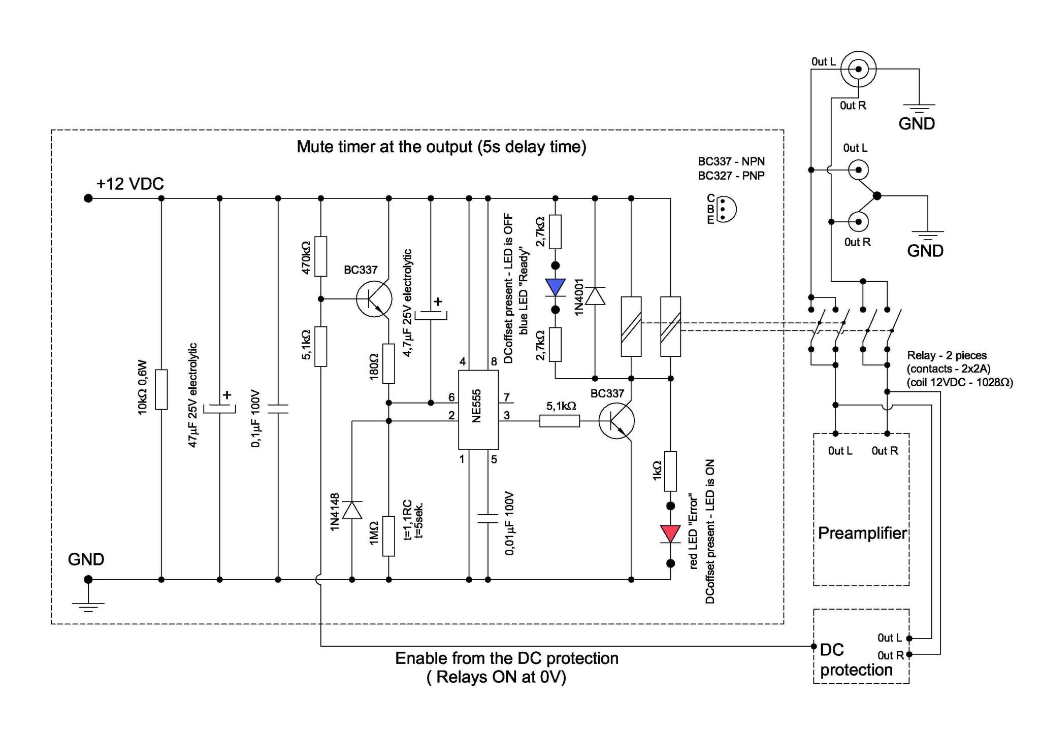

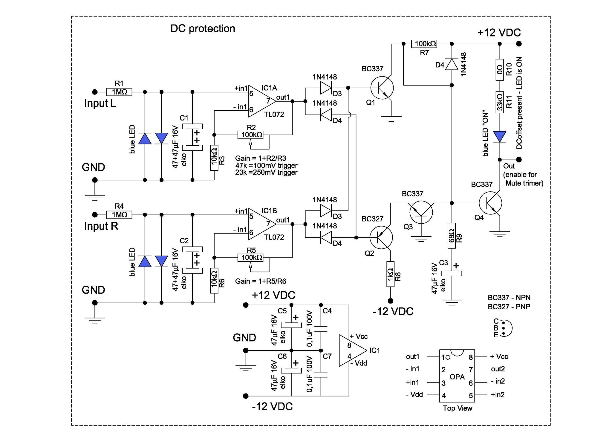

I use this, a DC protection designed by @miro1360 for the TDA1541A DAC (slightly modified) and a small Mute circuit of my own design with a 5s delay. Everything is powered by a separate +-12VDC power supply. With the 100k trimmers in NFB, I set the protection to turn on at 250mV DC.

The blue led at the input are protection against excessive voltage (+-2V), I had that on hand. I don't recommend Schottky diodes, but you can put two 1N4001 or something. Blue LEDs work with very low currents, that's why I took them primarily. For example, two zener diodes 1V5 can be used, but they are connected in reverse and in series. The headphone amplifier has a +-15V power supply, so I thought that the OPA input should be protected.
