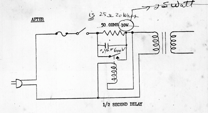

I work with relays at work I even sell them, so horrible is a strong word. The relay, depending of design has hysteresis, more or less. Those with very little hysteresis, this kind of circuit is not very suitable but for a "normal" relay it will work rather OK but I prefer they way I have solved this problem.
Sorry to use a strong word! The fact that wuffwaff's amp hasn't allowed the blue smoke to escape goes to show that it's a good 'un and that I'm maybe too quick to condemn something that doesn't look good on paper.
I have been using a circuit similar that from Elso for more than 12 years on my Futterman otl3e clones. Powering a 1000VA Toriod transformer up. I never had a blown fuse.
Simplicity at its best.

How is the delay determined with this circuit? Is the timing affected by all the components?
Elso Kwak said:Hi,
Attached a very simple circuit that is working since 29 years with a 1k5 Watt transformer.....(NOT a toroid BTW!) Of course this is a AC relay.![]()
1 The voltage drop of the R (caused by the resistance and the inrush current).
2 The pull-in voltage of the relay.
