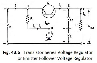

Just use this (below). Simple (NPN) Zener regulator with emitter follower. And a PNP for the negative.

This works , how I derive my +/- 12V supplies from big amp rail voltages (60 - 75V).

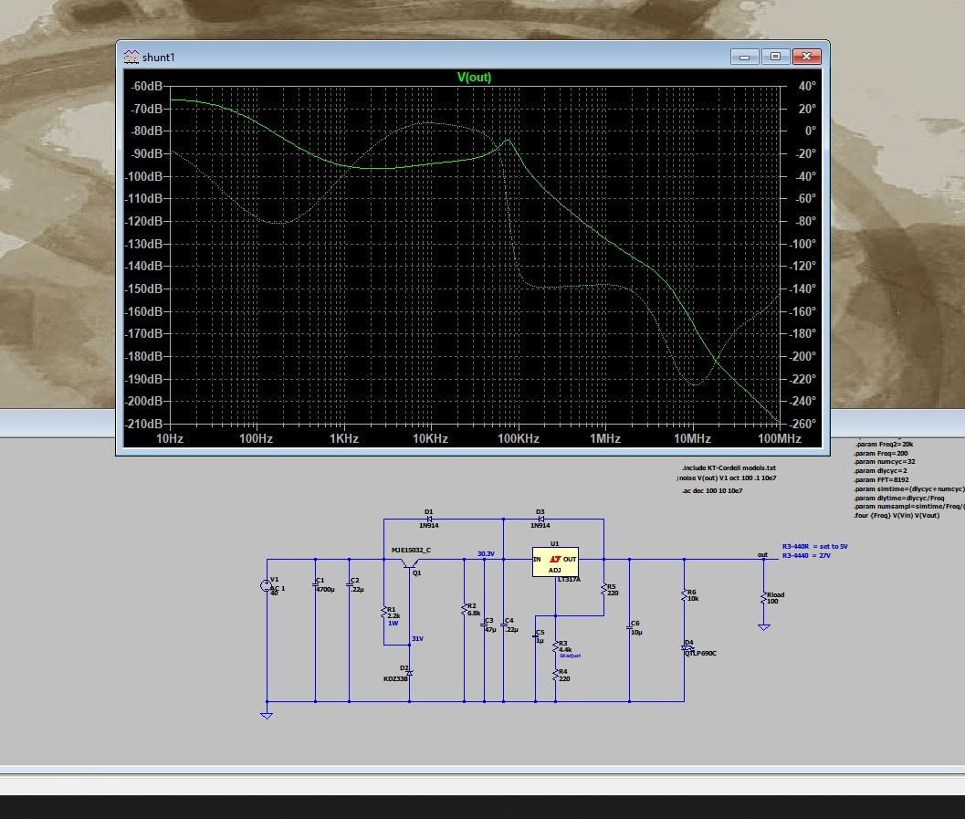

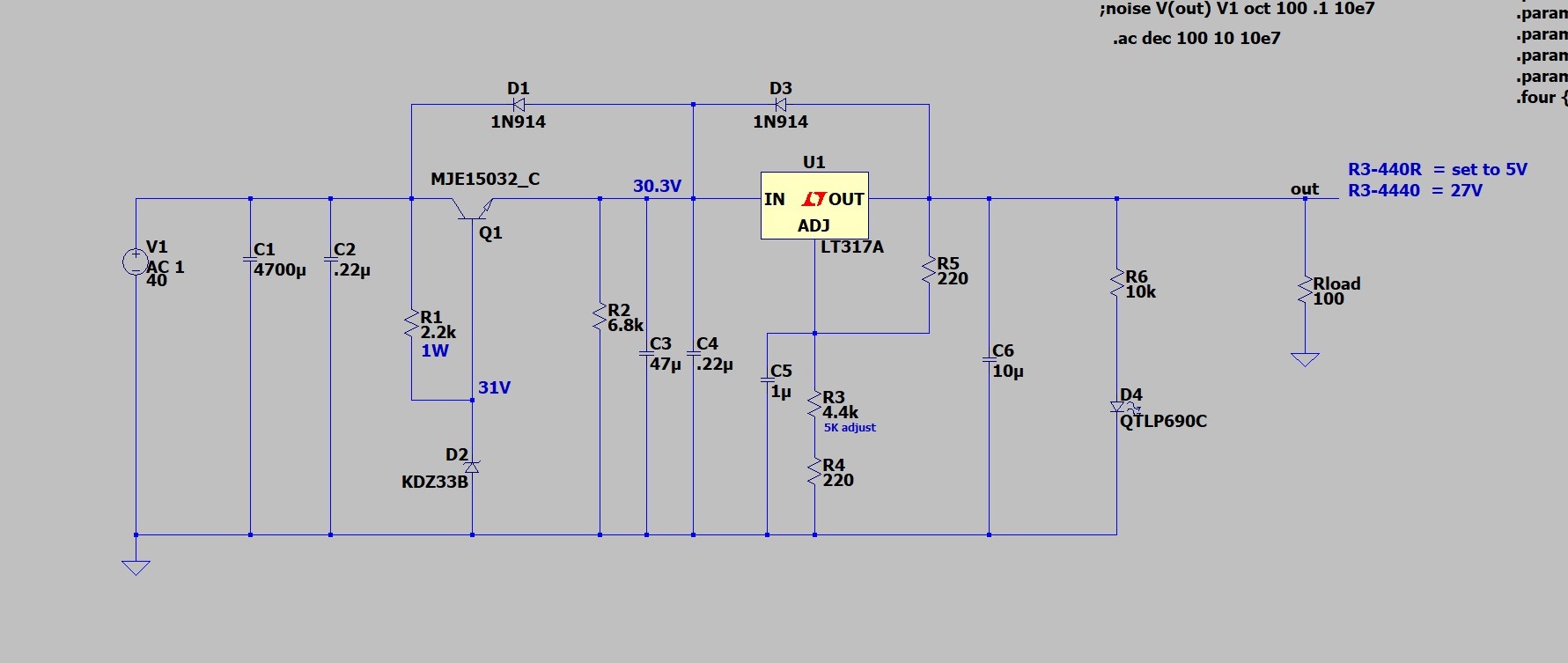

Using the LM's after the simple regulators is the best (and adequate) if your source is the crazy unregulated amp rails. Performance would
be stellar if the the source supply was not running a amp.

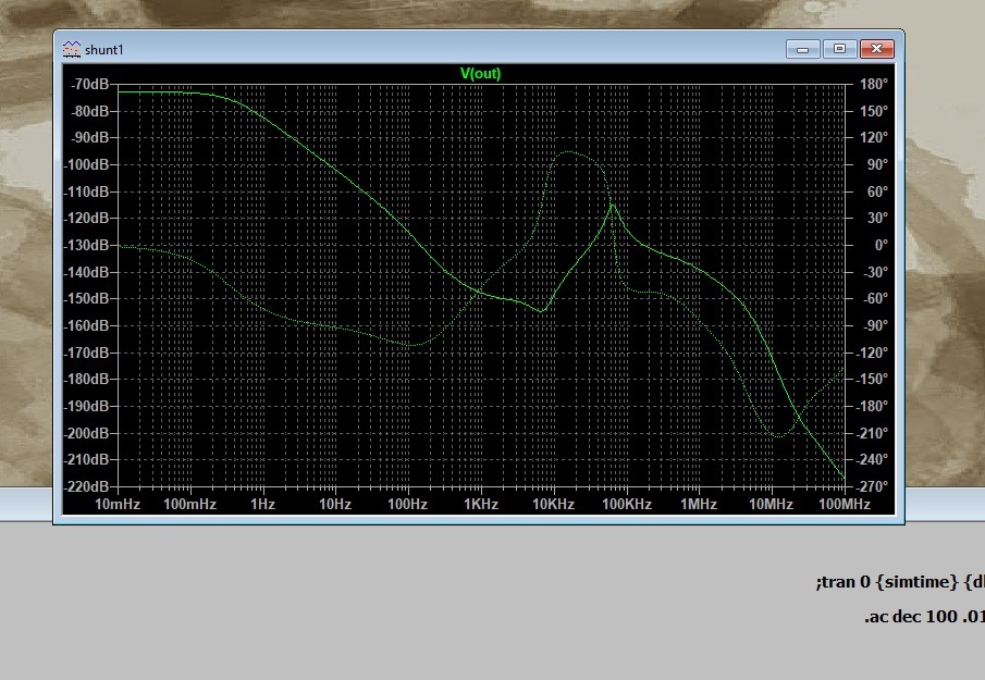

Here it is - a regulator regulating a regulator ..... 75-90db PSRR , not too bad.

Ok. I wish I had check my email more thoroughly than I had..or earlier. Because I had barely gotten past the identification of MJE105030/031 (the 032/033 is obsolete, according to digikey, but seems like they were only a higher voltage version?).
In the midst of frantically trying to teach myself KiCAD, I realized how little I knew. I was still trying to figure out how to calculate the heat dissipation in the zener....had I only looked here!
You saved me hours. Thanks!
The circuit makes a lot of sense to me, with the exception of the two diodes D1 & D3. I have no idea what they are doing, but I suspect that once I figure out KiCad it will be obvious.
Thank you very much for sharing the circuit!
You can use any 60V+ BJT P/N pair. Don't have to be the MJE's. Depending on your current draw , even TO-126 TTA/C004's will do.
TTA/C might even be able to do the whole 1A+ (of the LMs') without a heatsink. 10V drop of the pre-regulator = 1-2W.
My circuit just needs to run a few op-amps @ 50-100mA , no heatsinks - all is cool.
OS
So a reverse bias of the device will not cause failure. Bulletproof.
The Badger/Wolverine have additions like this. 0 failures.
Edit - they even use another diode reversed between ADJ and OUT of the LMxxx regulator.
Negative is easy - just reverse all the diodes.
