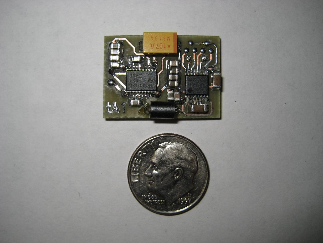

I made a little headphone amp with TPS60130 charge pump to be run off of a single lithium cell. I think the switching frequency was around 320kHz. Only filtering was the ceramic caps on the output and a ferrite bead; the thing was dead silent.
