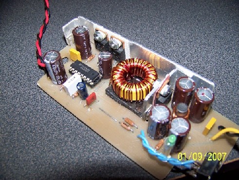

Recently, I did a 2-F DC-DC boost converter that puts out +19.5V (15-24V adjustable) @ something like 5-6A, using a non-isolated version of the ckt EVA describes. The controller is an SG3525, the MOSFETs are MTP75N06s, and the Schottky diode is an MBR2545CT. I used a bifilar-wound powdered-iron toroid, wound for ~27 mH pr winding. The centertap goes to +12V, and each end is alternately switched on and off, like a push-pull, but without DC-DC isolation. The spikes created at each end of the coil's winding are recovered by the double Schottky, filtered with a C-L-C section, and monitored for regulation. See the attached pic.
Hope this helps. If I figure out how to shring the size of the schematic file, I will post it here.
