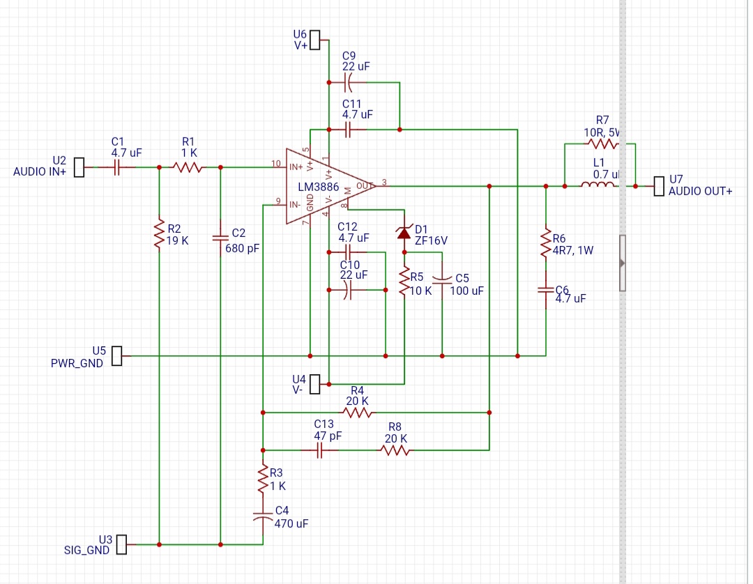

Friends, which one do you think will give better results?

There is no such thing as a ‘DC coupling capacitor’. C1 is no exception.
There is little to choose between any of your alternatives.

Capacitor C1 AC bağlantı yapiyor. Yani DC blocking. Biraz komik bir kücük hata 🙂 Bence R2 C2'ye parallel olmaye gerekir*. R2 47kOhm olarak.
Which capacitor will sound best is up to you by listening and trying out. ERO MKT1813 simply is very good but I would pick small sized large value film caps in 5 mm pitch and keep connections short and the device compact.
*A tad better is to rearrange like on the picture followed by the 1 kOhm R1 to the LM3886 input pin (and up R2 to 47 kOhm). I would use a 475 kOhm from input to GND too for ground reference.
