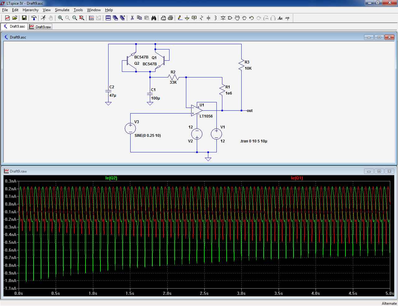

Don't be fooled into thinking that because a cap is inside the signal path or feedback loop rather than beside, it is more important than the one(s) that shapes your DC servo: in order to eliminate DC or VLF, you have to use a number of poles, and lousy pole components have more or less the same kind of effect, wherever they are located.
The ones in the DC servo will come with a vengeance: some of their undesirable features will be amplified, and the nasties from the servo will also be coupled in some way, even if they are attenuated (by regular passives, of course).
There is no magic bullet: DC servoes are convenient but they do nothing for the quality of reproduction, quite the opposite in fact. Which is probably why they are sonically preferred to simple passives: it is similar to the tube sound effect. The result is more colourful, less boring...
If you want DC-servo advantages without the opamp and its "features", you can use multiple constants feedbacks.
In this example (using opamp rather than PA for convenience), the settling time would be governed by the time constant of R1 and C1, in this case 100 seconds, which would be absolutely unbearable for practical purposes.
A second, much faster loop is added, but it is normally isolated from the regular FB path by back to back diodes.
Here, the time constant is only 470ms, which allows for a shortened stabilizing time.
The sim shows the situation towards the end of the stabilizing process: the current through the diodes is progressively decreasing to ~0. The signal is a maximum amplitude 10Hz waveform, normally near the maximum possible stress.
This is just an example, the constants can be multiple and adapted, etc.
At least, here you see clearly where the non-linearities are susceptible to come from.
For the rest, I can only recommend you make proper A-B-X tests: you will probably find that most of the folk lore is unnecessary, and simplify your life as a consequence...
