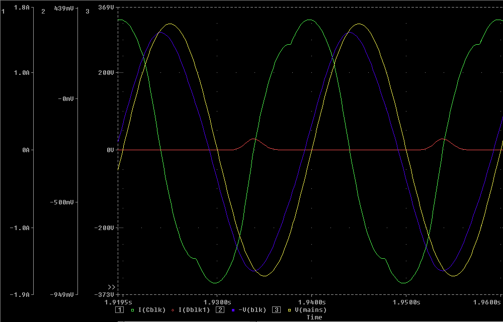

DC blocker sim
Adding to Andrews very good explanation I have some curves from a simulation of a DC blocker.
Mains: 230V(rms)=325V(peak)
Offset: 0.5V
Blocking Cap: 10mF
Diodes: antiparallel 1N4001
Transformer, values taken from an actual smaller toroid:
- 15 Ohms DC resistance of primary, 0.6H inductance
- 0.5 Ohms DC resistance of secondary, 3mH inductance
- coupling factor 0.9 (deliberately set to get some leakage inductance)
Load circuit is very typical:
- 4x1N4001 bridge
- 10mF Cap, 0.1 ohms ESR
- 5 ohms load, drawing ~2.6A(rms)
Mains inductance was neglected as the 15 ohms DC-R and the leakage inductance of the Xformer dominiate this.
Yellow trace is the mains voltage.
Blue trace is the voltage across the blocking circuit (plotted inverted polarity, to see the phase realtionships a little better).
Red trace is the current through one of the diodes (the other one doesn't get forward biased).
Green trace is the current through the cap. It is non-sinusodial due to the load circuit.
Max. positive voltage across the cap is 0.83V , max. negative is -0.32V. The diode starts to conduct at the positive peak. This is not because of the mains DC but due to the too high impedance of the cap @50Hz (0.32 Ohms). Peak cap current is ~1.7A. This gives us +-0.55V momentary voltage across the cap (which in total happens to be the sum of 0.83V and 0.32V). But, this momentary voltage does not directly add to the DC offset of 0.5V because of the phase shifts and the non-sinusodial cap current.

No, not actually the DC. Even with no DC, when there is too high a current through the caps, producing too much voltage drop, the diodes start to conduct. This distorts the waveforms, but symmetrically ==> no DC effect.
If we have DC one of the diodes start to conduct earlier than the other, which result in a part of the DC being effective again (due to the asymmetry).
the red trace showing the diode conducting on every cycle tells the user the caps are too small.
The diodes should not conduct in normal operation.
I think the diode bypass condition should ONLY operate during the start-up current peak and during a fuse blowing incident.
The diodes may have to be very sturdy to survive the fuse blowing incident. Even a T3.1A will pass many hundreds (and possibly thousands) of amps during the rupture period. I would like the diodes to survive this very short term transient. The risk of damage to the caps increases enormously if the diodes are unknowingly open circuit.
If the red trace is the bypass conducting, then I would expect to see a flattening of the blue voltage (across the blocker) trace. But it's not evident.
How much current needs to bypass for the cap measurment to show that bypass action is ocurring?
Is there a better way to measure when the diode conducts?

In a typical domestic situation mains impedance is unlikely to be below 0.3Ohms. With 230V mains this would give up to 1000A of surge current in case of a full short. Therefore bigger bridge rectifier modules seem to be adequate, and maybe even two of them in parallel. A KBPC50xxx can handle up to 400A single pulse per diode, two or four of them in parallel seem to handle the surge. Also, with their 50A(rms) continuous rating (when properly heatsunk) they even seem to survive a situation when the caps went completely ineffective in passing current.
With a completely unloaded secondary and with the 0.6H of primary inductance (plus the 15 ohms DC-R) the Z @50Hz of the primary is ~200Ohms, almost purely inductive. This is the highest possible primary impedance. Hence peak cap current is never below a hefty 1.6 amps! Of course average power draw from the mains is close to zero. With the load resistor shorted, cap current increases to 2.6A(peak), while power draw reaches 300 watts (with a perfect xformer not driven into saturation plus other "perfect" parts). Peak diode current is 120mA (open circuit) and 350mA (shorted load). These results are quite counter-intuitive. After all, who would expect a high cap current with an unloaded secondary?
If one takes a closer look on the blue curve, one can find a little distortion, it's not perfectly sinusodial. This is best seen when taking the 1st or 2nd time-derivate of the voltage.
To scope diode or cap currents I suggest the use of inductive current probes. This is very safe, no galvanic coupling.
FOR DIYer: A DC-Blocker is **NOT** a project that you just hookup from arbitrary parts from your tinker box in a "Let's just see how it works with what I have here" approach. Calculate, design, simulate and build it with utmost care, triple checking everything. If you have any doubts, don't build it. Use ground fault interruptors, wear safety glasses and take all precautions that are necessary when dealing with mains voltages.
WARNING: the parts I used in the simulation (post #51) are **NOT** adequate for a real project. The simulation is and was only for explanatory purposes.
Regards, Klaus
