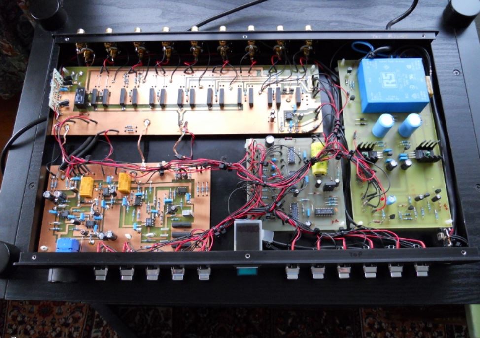

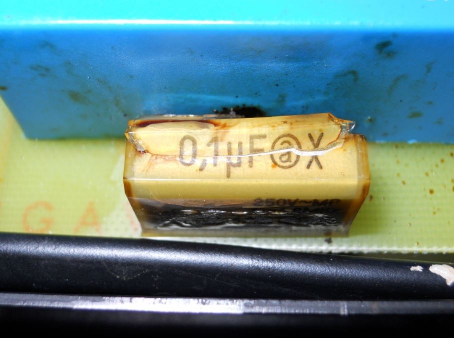

Two weeks ago I dug an old preamp out of the loft and within minutes the room was filled with smoke. A class X cap had gone up. It didn't go short unbelievably but its a cautionary tale.
The cap is in the corner next to the tranny. Its when something like this happens you realise how important safety is such as proper grounding of the casework etc. That cap could easily have bulged and contacted the case.
Mooly,
this is a common failure I often experience with older test equipment, Philips stuff is especially prone to that. Have the same type of X-cap as shown in your picture, known as "marshmallows"
The problem is these X-caps develop micro-cracks over time (decades) which allows moisture to get in. Of course at the time they were produced they passed all tests but this was in the early days of using plastics for component enclosures when the knowledge about the aging characteristics was still poor.
As a rule, I replace mains X or Y caps on any equipment older than 10 yrs or of unknown history.

Thanks. That sounds a probable scenario as the preamp has been in the loft for 6 or 7 years I guess, and was built around 14 years ago and the cap would have been older than that.
