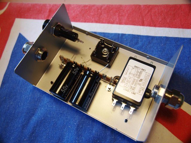

Possibly not strictly a PS but more about getting clean power I decided to try a DC blocker. Australia at one time had the cleanest power but since the grid has been privatized power quality has fallen. A DIY friend built a simple blocker and claimed he felt an improvement in sound quality. Because he has tube monoblocks he built two and believed a better improvement again. Also any DC on the mains will generally cause most big toroids to buzz. He had had a lot of problems with this.

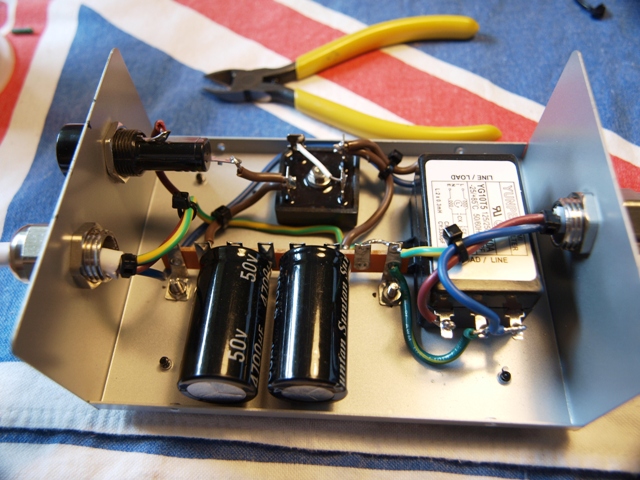

Because the project is so inexpensive I decided to build one based on the Recommend Design from this link. Look toward the end of the article. To value add a little I included a cheap RFI\EMI filter in the one compact enclosure. For the last few years all my power amps have a power filter built in but not my media players or preamps. Now they have better cleaner power.
I wanted to source all components from where I worked but could only find 4700uf caps at 50V. My bridge rec. is rated 35A. Since the caps should never seed any more than a few volts this should not be a problem. I added a choke to the lead in and a 10A easy access slow blow fuse to the build.
On a short listen through my all tube system, apart from a better defined sound stage, I can hear no HUGE improvement. A more extended listen may reveal other improvements. But now I know that my gear is a no-go zone for DC and all equipment is receiving filtered power. I built this up from scratch and had it working in a short afternoon for a total cost of $35. There is no reason not to have one.

Only very big toroids (500V plus) have big problems. There is a lot of RFI\EMI on mains. A lot of this will pass right through even a good PS. I noticed from my very first amp I incorporated power filters my power amps sound better, clearer. I haven't built a power amp in years that doesn't have it's own power filter. I often get comments about how clear my tube amps sound. This year alone I made four tube power amps for myself which all sold in a week. I had no intention of selling them but others liked them so much I had to let them go. I'm not saying it is solely because of the power filters but I think they have a part in it.

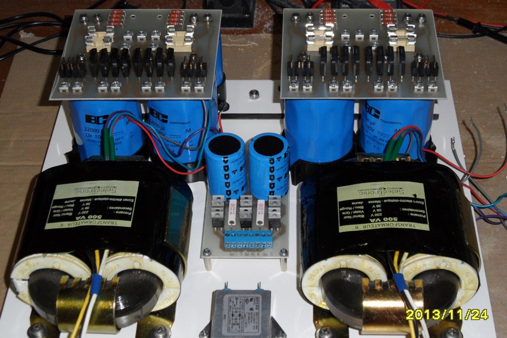

I to have build the DC-blocker from Rod Elliot.
See the small PCB in the middle, on this PCB are also 2 safety loop breakers installed.
After reading on ESP what a huge effect even a small DC-current has on the transformer capability, it has to be there in my next design.
I'm using 63V/10000µf caps from BC Components/Vishay, rated with a ripple current at 100Hz of 5.4A. The diodes are 15A/600V devices.

I thought about including blockers in amps but I already include power filters in all power amps. At this point I will keep external a single shared blocker. After further listening I get the feeling the soundstage definition has improved which is the same remark a friend made who got me into them.

You'll need only 10 or 16 Volts caps since you have only 1-2 volts across them. It's also better to have more capacitance because the filter will be more effective.I wanted to source all components from where I worked but could only find 4700uf caps at 50V.
The DC creates only a mechanical sound in the transformer itself. This hum can be really annoying in a quiet room.Unless the DC is bad I cant imagine getting a much improved sound.
You are absolutely correct concerning the voltage, but all lower voltage caps I have found are all having a rather low ripple current.
I have selected my caps to have an available ripple current higher than the maximum primairy current with maximum loaded transformer.
==> 2X500VA R-core on 240Vmains 50Hz ==> ripple current >4.16
==> caps are 10000µf/63V with a ripple current of 5.4A at 50Hz.
