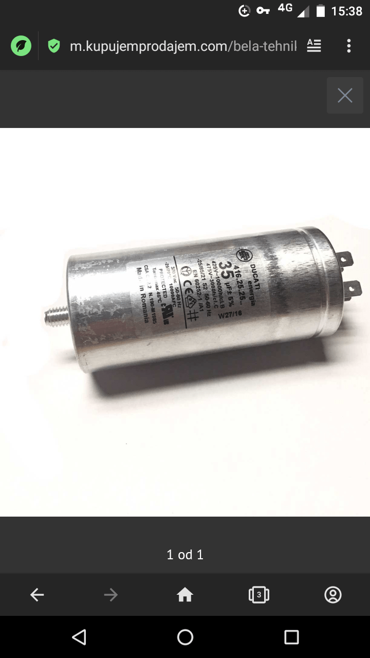

Hello ... Old thread but I have a question ...
Will something like this work as a SAFE dc blocker?
It is a run capacitor for an air conditioner.
I would say not tbh. Certainly for a conventional PSU with a mains transformer the value is far to small. SMPS do not need a DC blocker.

It is safe if you install it correctly... meaning physical mounting of it and keeping necessary clearance from other parts of the amp. They can be effective if the real source of the problem is asymmetric mains causing a shift in the notional centreline of the waveform (which is commonly but incorrectly called a DC shift)
