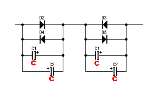

I've been asked by a friend to make him a DC blocker for his Krell monoblocs - a pair of brutes with a maximum power consumption of 6kW, and for which they recommend a dedicated 20A spur!
Having perused the many, oft-conflicting threads, I'd like to use a simple blocker circuit with large elctrolytic caps and antiparallel diodes as per the much-discussed Bryston circuit, but using much larger caps (up from Bryston's 0.33mF/6.3V to 1.0mF/16V).
These are rated for a maximum ripple current of 14 Amps, and it is my intention to use a pair in parallel to give >20 Amps headroom, plus a similarly robust bridge rectifier.
If I've understood it correctly Bryston use their caps in parallel assuming no significant reverse voltages (<1V) will be encountered; while Rod Elliott and others use caps in back-to-back series to protect against any reverse voltage scenarios.
The disadvantage of the latter approach is that you need 4 x the capacitance to achieve the same ripple current handling, which becomes hopelessly expensive and outsized in the case I'm trying to get my head around.
So, would it be possible to protect the caps from reverse voltage by using a suitable diode after the blocker to drop reverse voltage above a certain threshold to Earth - since it shouldn't be present unless a fault state exists? If so, which kind (transil, avalanche, single high power rectifier?).
I want to create a safe and extremely robust solution, but don't have the skills to model this, nor the test equipment to do more than PAT type safety stuff. I'm aware of the need to properly rate, fuse, insulate and earth every last aspect.

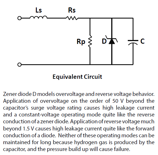

Cornell-Dubilier publishes quite a nice Aluminum Electrolytic Capacitor Application Guide. I have snipped out a little piece of it, image below.
They discuss reverse bias voltage (opposite to the polarity of the capacitor), and strongly recommend that you limit reverse bias to 1.5 volts or less.

Thanks Mark, that was my primary concern, still is.
That's right. Bryston guarantees, by design, that no significant reverse voltage (< 1.5V) occurs across the electrolytic capacitors in their mains blocker.
How do they do this? They guarantee, by design, that no significant surge currents flow, which would place the bridge diodes in their high current, high Vfwd regime.
And how do they do THAT? They use a soft start circuit. A triac in series with the transformer primary is controlled by either (i) a soft start IC designed to control AC motors in washing machines {part number TDA1085C (datasheet)} in their early power amp products; or else (ii) a microcontroller {part number PIC16F818} in their more recent power amps. This triac gets fired at just exactly the right phase of the incoming mains waveform, to minimize surge current ("ELI the ICE man"). Then the controller gradually ramps up the conduction angle, across many many cycles of the AC mains waveform.
These components are easy to spot on the Bryston 6B-SST schematic (LINK). The triac is reference designator Q3, part number BTB-24800B (datasheet), and the microcontroller is reference designator IC1. To see the earlier version with the washing machine controller IC, look at the schematic of the Bryston 3B.
Naturally, YOU can implement soft start any way you wish; you don't have to use a triac. Douglas Self's book and Bob Cordell's book discuss other approaches to soft-start, which don't employ triacs.

Note that paralleling components like fuses or diodes may not double their current handling capacity. Because the two components will not be exactly identical, one will carry a little bit more current, so it will heat up more and it's resistance will drop, so then it carries a little bit more current.
The Bryston-style mains DC blocker circuit (Fig.1 below) uses two capacitors, each of "C" farads. Its total capacitance is 2C and it and applies 2 x Vdiode of reverse bias to each capacitor.

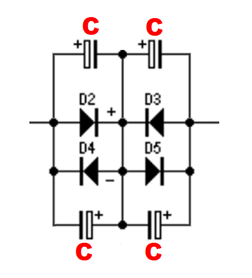

The Westhost/Elliott-style mains DC blocker (Fig.2) uses two capacitors in series. Its total capacitance is 8C, and it applies 1 x Vdiode of reverse bias to each capacitor.

Fig.3 contains two single-diode-drop DC blockers in series. The one on the left chops off the first Vfwd of DC bias, and the one on the right chops off the second Vfwd of DC bias. The net effect is to remove 2xVfwd of DC bias, which is the same DC blocking performance as Fig.1 and Fig.2
diyAudio member AndrewT is correct that a single 4-diode bridge rectifier module can indeed supply all 4 diodes of Figure 3. I've drawn this out in Fig.4, below.
Our Original Poster, diyAudio member MrFatBarSteward, hypothesizes that capacitor price is approximately proportional to capacitance value. If so then the capacitor portion of the cost is just the sum of the red C's in each design:

diyAudio member mirlo suggests that the capacitors in Fig.3 need to be twice as big as those in Fig.1, since the mains current times the capacitive reactance must be less than 2xVfwd in Fig1 but only 1xVfwd in Fig3. I'm of two minds on this point; it's obviously true during massive current surges, when the exponential behavior of the diodes kicks in. But how true is it over the long term of normal operation? Maybe that's a saving grace. Or maybe it's just fooling yourself by setting aside a margin-of-safety in one case while gobbling it up in another. I'm of two minds.
diyAudio member destroyerOS suggests it's wise to spend the extra money and obtain the extra peace-of-mind, by using the extra safe Fig2 circuit. Maybe he's right. Maybe the extra cost (about the price of two tickets to the cinema?) is small while the peace-of-mind is large.
