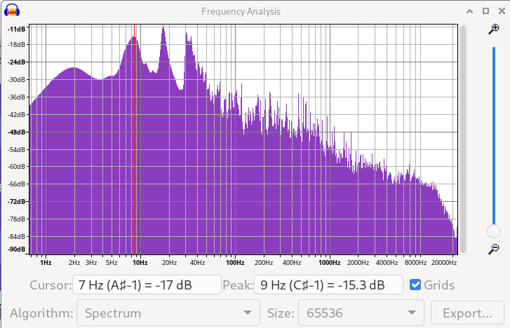

Of course there is.Yes, good point. Is there really any musical content produced with subsonics? But then again, there's Hollywood.
1812 overture feature cannons which has brutal subsonics.
bass i love you was specifically created to be really though to reproduce,
This is the frequency response for a more typical song:
